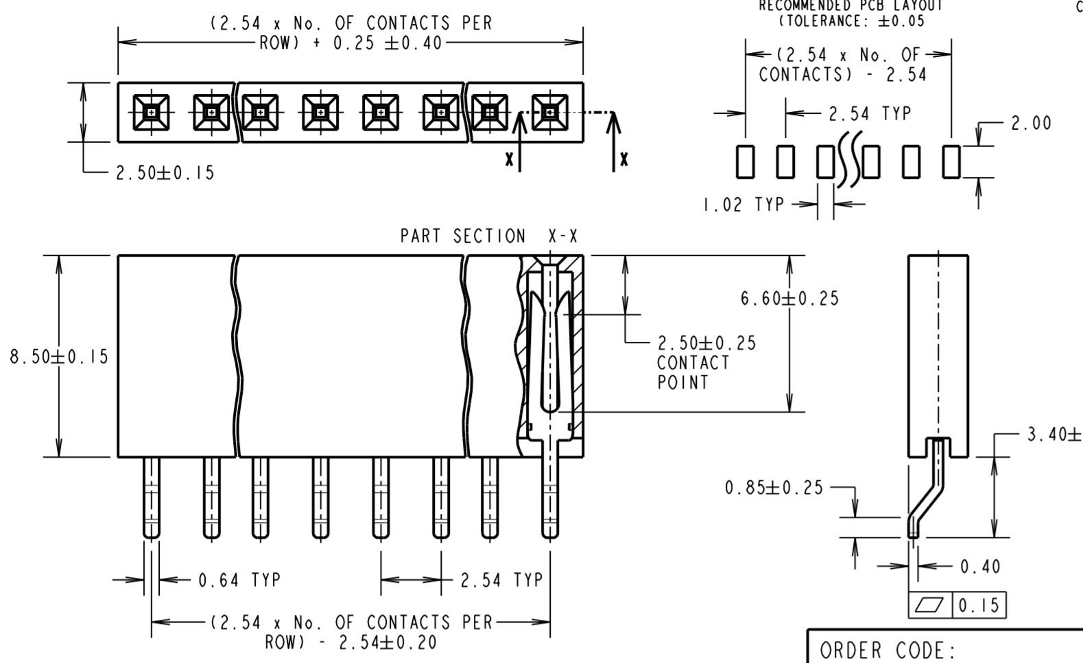

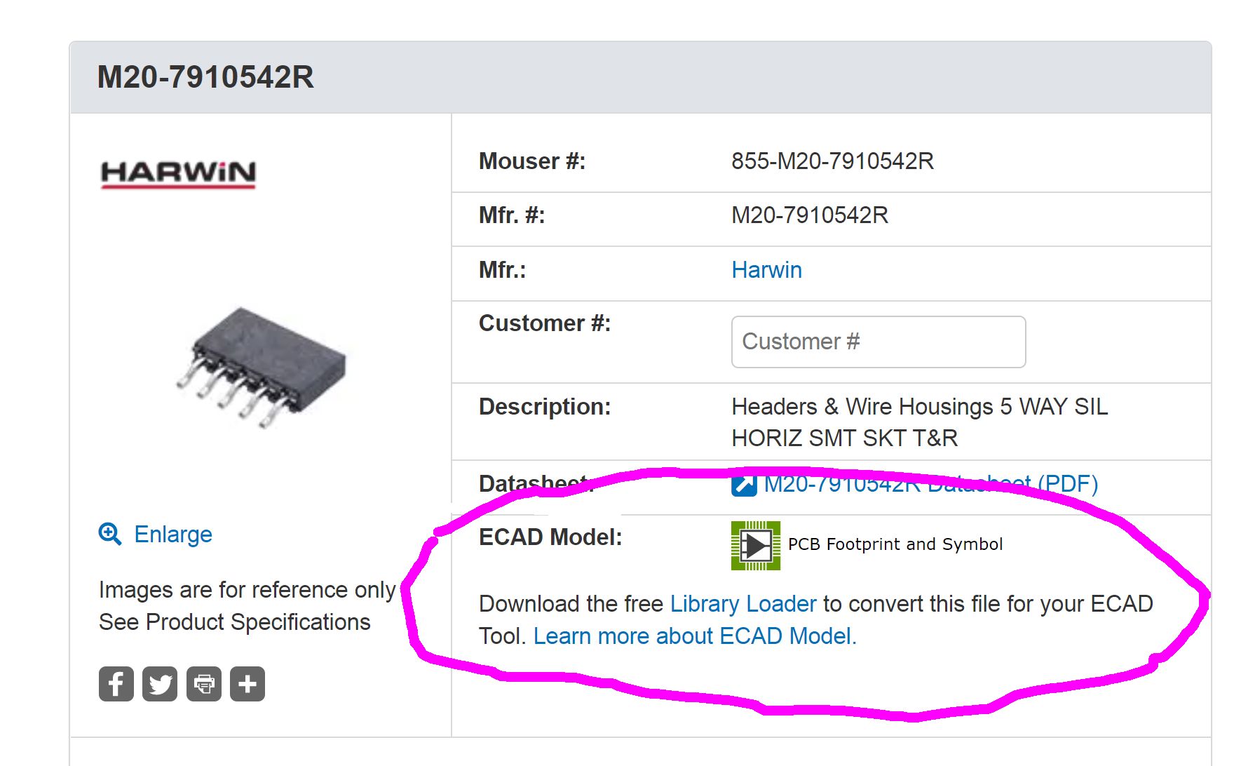

part # I have is from Mouser #M20-7910542R
made by Harwin
data sheet say pads are 2.54 ctr to ctr 1mmW x 2mmT
So, you have two options:
1. Design a footprint from the datasheet. All the dimensions you need are there.

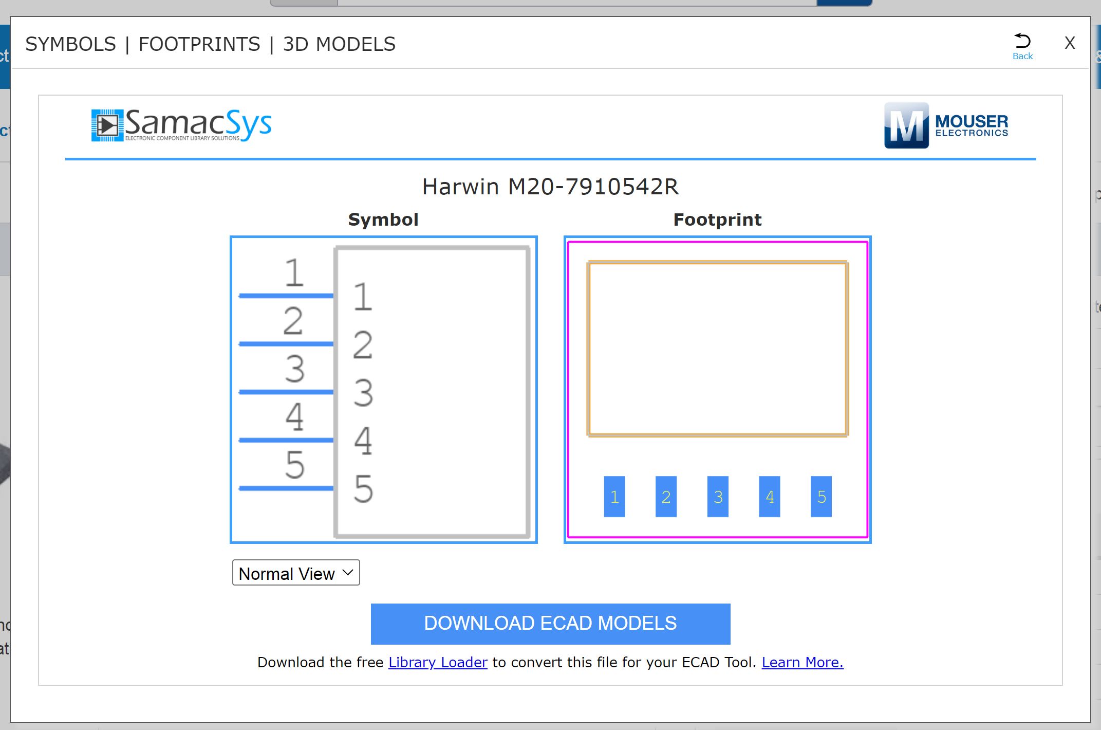

2. Mouser provides the symbol and footprint in a universal format. Download the file, follow the instructions to convert it to Eagle 7 format, and import into EasyEDA. In this case, drawing it vs importing it may be a wash, but for a more complex part, understanding how to import it saves a lot of time and trouble.
Download the file and the library loader program. Follow the instructions and import into EasyEDA.
THAT Samacsys program is really helpful. Have it on the startup menue.

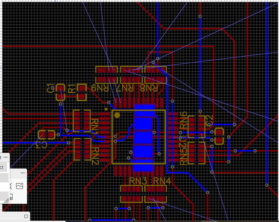

Have board almost complete but that copper pour is an issue when I found two traces that need to be put on bottom layer.
Maybe just redo the copper pour.

Traces on the bottom ground plane are fine, along as they don't cut the ground plane in two.
Press [shift] R to rebuild the ground plane when you add traces on that layer or move anything.

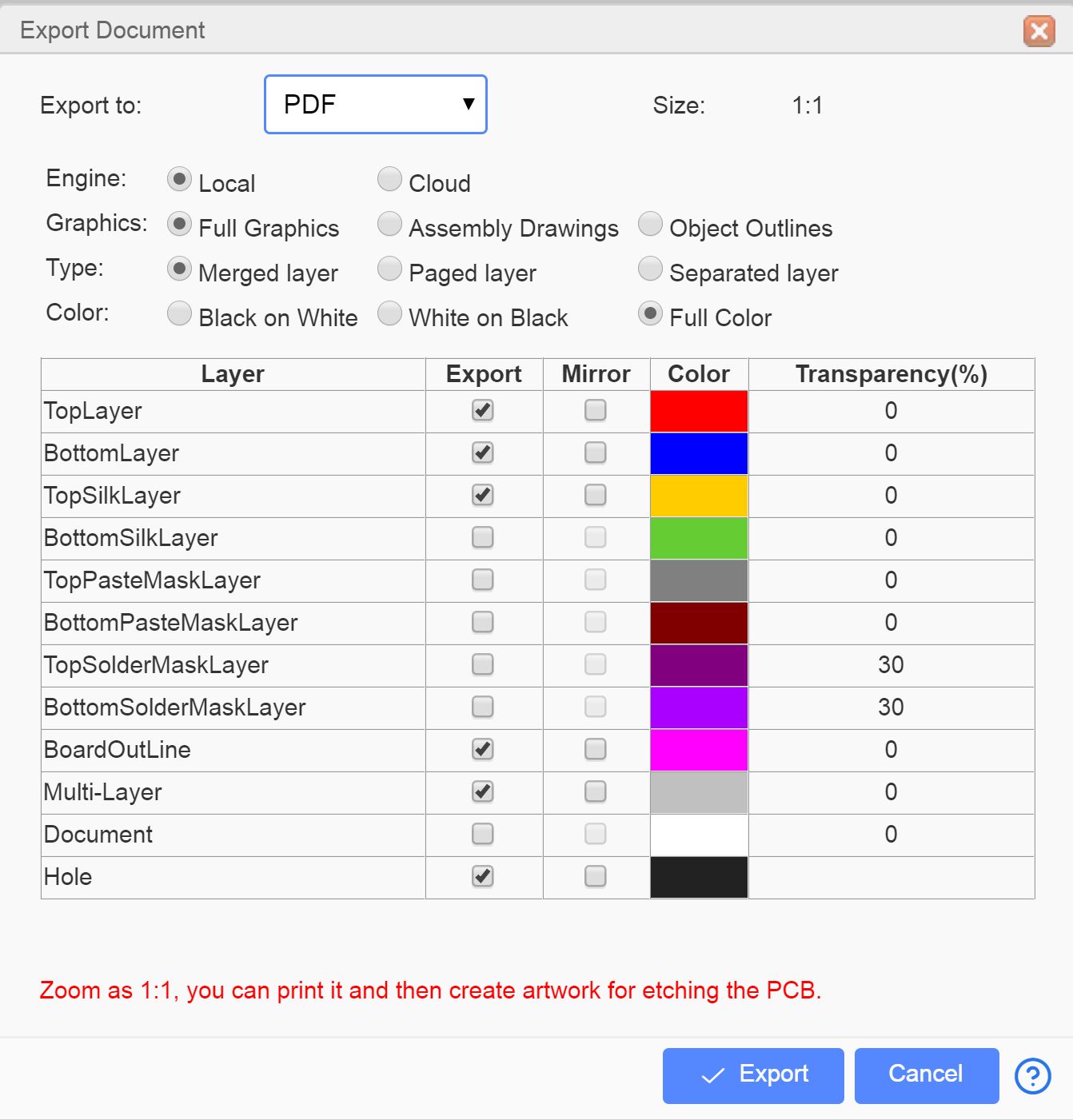

You might try the following settings to to post pictures of your board.
It will be a little easier to see what's going on. Saving as a PNG will result in a directly viewable picture here.
will give it a go BUT discovered a new issue after I reload changes then check errors it says VIA DIAMETER
I have the via set at min via diameter of .6 (should be fine after I looked at the board requirements with a hole size of .3
doing something really wrong?
It depends on parameters that are set in the program. It should be fine, but why push the capabilities of the fab house when there's no need to. I usually set general vias to 0.8mm dia, 0.4mm drill, and set my trace width to 10mils (0.254mm) unless there is a compelling reason not to do so.
am discovering lots of errors on the board after I SAVE > RELOAD NETS> DRC ERRORS
The bottom shows several rat lines still.
I have a via next to each LED for ground.
Needs more work IMO
Many of your LEDs have a via next to them, with no connection to the pad on the top layer. Other LEDs have no connection to the ground pin at all.
Your power trace from the USB connector needs to be far wider. Remember, every LED is fed from this trace. Too wide is never an issue. Too narrow, if you turn on a bunch of LEDs and you may glitch the micro
