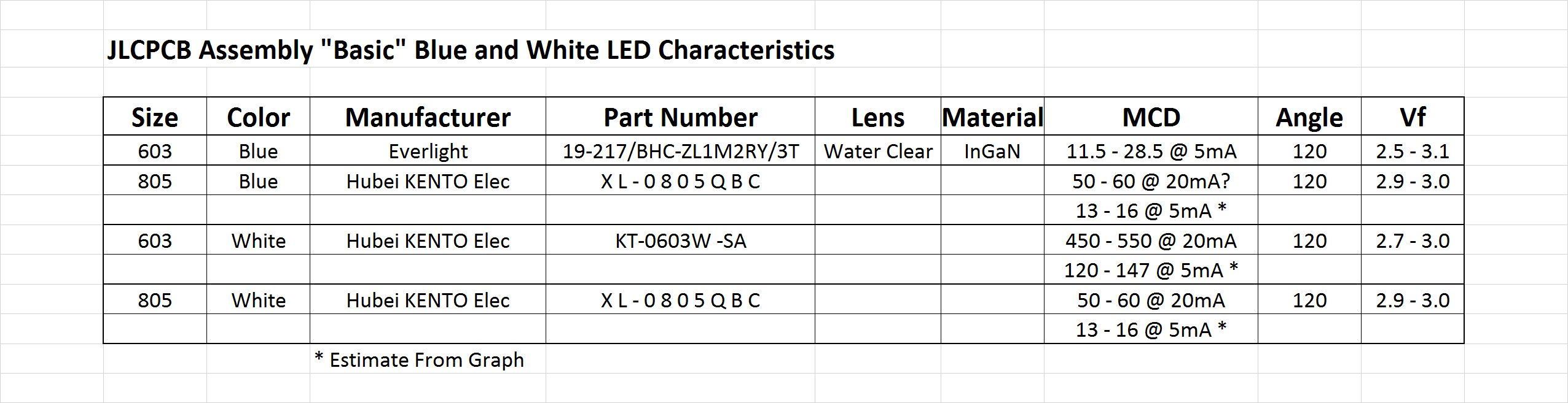

I researched the data sheet and the blue LED - 70-150 MCD
the white is 200-330 MCD
Maybe alter the resistors but I want the white to be brighter but?
Looking at JLC's "basic" parts, blue and white LEDs are a mixed bag (there are no 1206 LEDs in the basic list).
The table below shows the 0603 and 0805 LED characteristics. The 0603 white LED is a real outlier compared to the rest. Look at the MCD values at 5mA. The others are reasonably similar. JLC does have a wide range of LEDs available on the extended list but I'm not crazy enough to categorize them all. The data sheets are available with a click.
Following the table are two graphs showing luminous intensity vs. current in different formats. Given the luminous intensity at 20mA, you can estimate the intensity at lower currents. For the Hubei KENTO Elec LEDs, I estimated that the intensity would be 1/3.75 less at 5mA than at 20mA. A point to note is that luminous intensity is falling rapidly below 5mA, and these LEDs (with a notable exception), aren't all the bright to begin with.

LIGHT EMITTING DIODES (LED) BLUE 463~466NM 50~60MCD@20MA TOP VIEW 0805 ROHS Basic PartHUBEI KENTO ELEC225675
Yes, and??? You've absolutely missed every detail in my last post. Those are the two 0805 LEDs in my table. You're looking at the MCD @ 20mA. At 5mA, the luminosity will only be 13 – 16 MCD.
But according to version whatever of your schematic, you won't even be using 5mA. You've talked about 510 ohm or even 750 ohm resistors for 2 LEDs in parallel.
510 ohms results in 4mA shared between 2 LEDs – that gives you 2mA per LED, which will give you 5% of the brightness that 20mA would give you.
750 ohms results in 2.7mA shared between 2 LEDs – giving you 1.4mA per LED, which will yield about 1.5% of the brightness that 20mA provides.

after recalculating resistors I find 180 ohms to 220 ohms for 5 ma
thanks for the help.
Be perfectly clear. I am not recommending 5mA or any other current level is appropriate for what you're trying to do.
All I am suggesting is that less than 5mA will be essentially useless.
