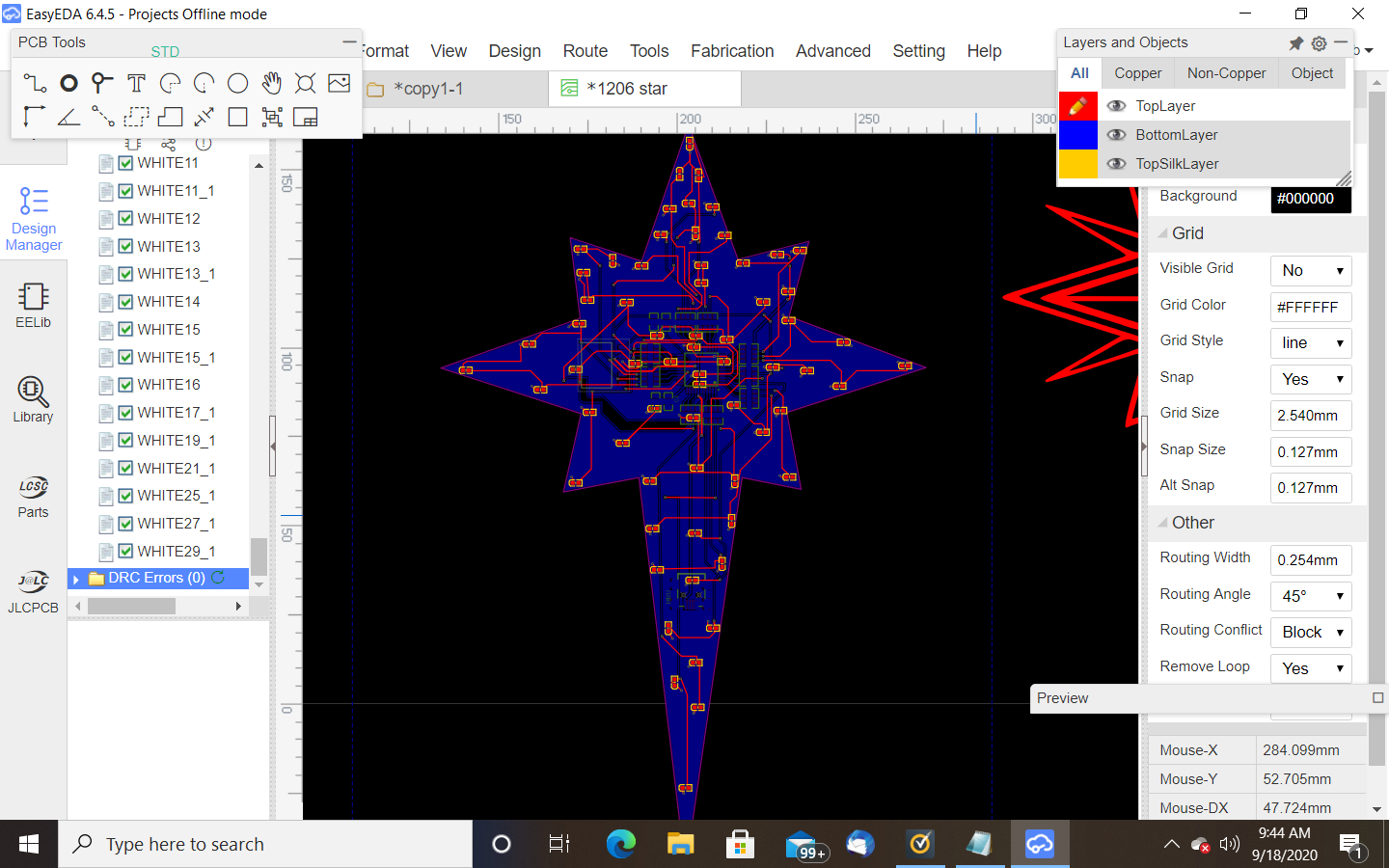

finally have the board laid out, needs some cleaning up of crocked traces etc. then need to make the silk screen the inverse image so only the white outline is printed. Did a board that was supposed to be all one color and had the front with copper area on front and the board came back with a silver front. Didn't want the silver.
If the entire layer was solder-coated copper, the layer you put on the front was soldermask, not silkscreen.

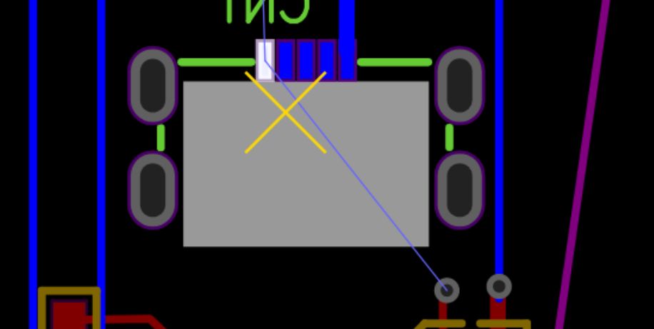

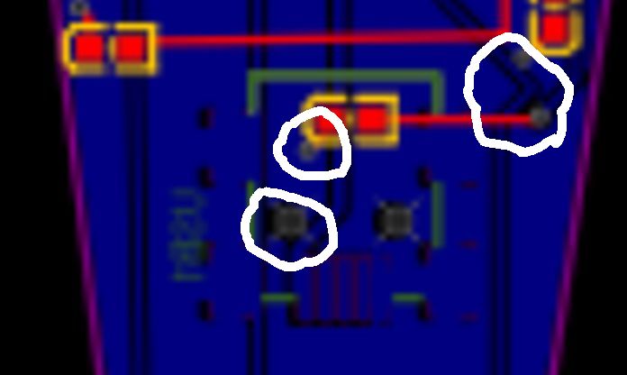

Just looking in the area of the USB connector, a number of less-than-ideal things come up.
1. The USB connector is pointing up, so the cable will come in from the top. I don't think this is what you intended. Also, there doesn't seem to be mounting pads for the ears that hold the connector to the board.
Hmmm. Maybe this is a vertical connector instead of right angle (haven't seen one in SMT), which means the cable would exit perpendicular to the board....which will likely rip the connector off the board. Also, if this is the case, rotate the connector 180 degrees to fix the routing.
2. The V+ trace from the USB connector is too close to the mounting pin. Correcting the orientation of the connector will solve this.
3. The power for all the LEDs goes through the V+ trace from the USB jack. I suggest (again) that it be a big wide track,
4. There's an "interesting" jog in the track to the right of the connector.
5. Put the vias for the LEDs a little farther away from the pads. Vias too close to SMT pads can lead to assembly problems.

will make corrections as suggested. The +5v trace is .500 wide. Maybe go wider?
I want the usb connector pointing down (will investigate)
That doesn't match what's on the board picture you posted. This connector is a MINI-B while the one in the picture you posted is a FULL-SIZE B.
Are you trying to say you switched to this? A MINI-B is a really poor choice as it has been deprecated (i.e., removed from) the USB standard. It's the least rugged of the USB connectors, is obsolete and cables for it may be difficult to locate.
You either want a full-size B connector, for which long cables are readily available) or micro-B, which is widely used. No USB-C as it will be impossible to hand solder.
I would make your power trace 1 or even 2 mm wide, then narrow it down near the micro. Bigger is better in this case and with all those LEDs, this trace could be carrying a lot of current (I can only guess at how much because you keep changing every-damn-thing so you don't know what you've got and anybody following along hasn't a clue.

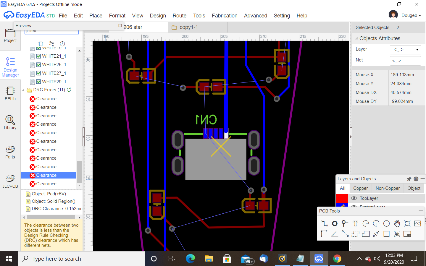

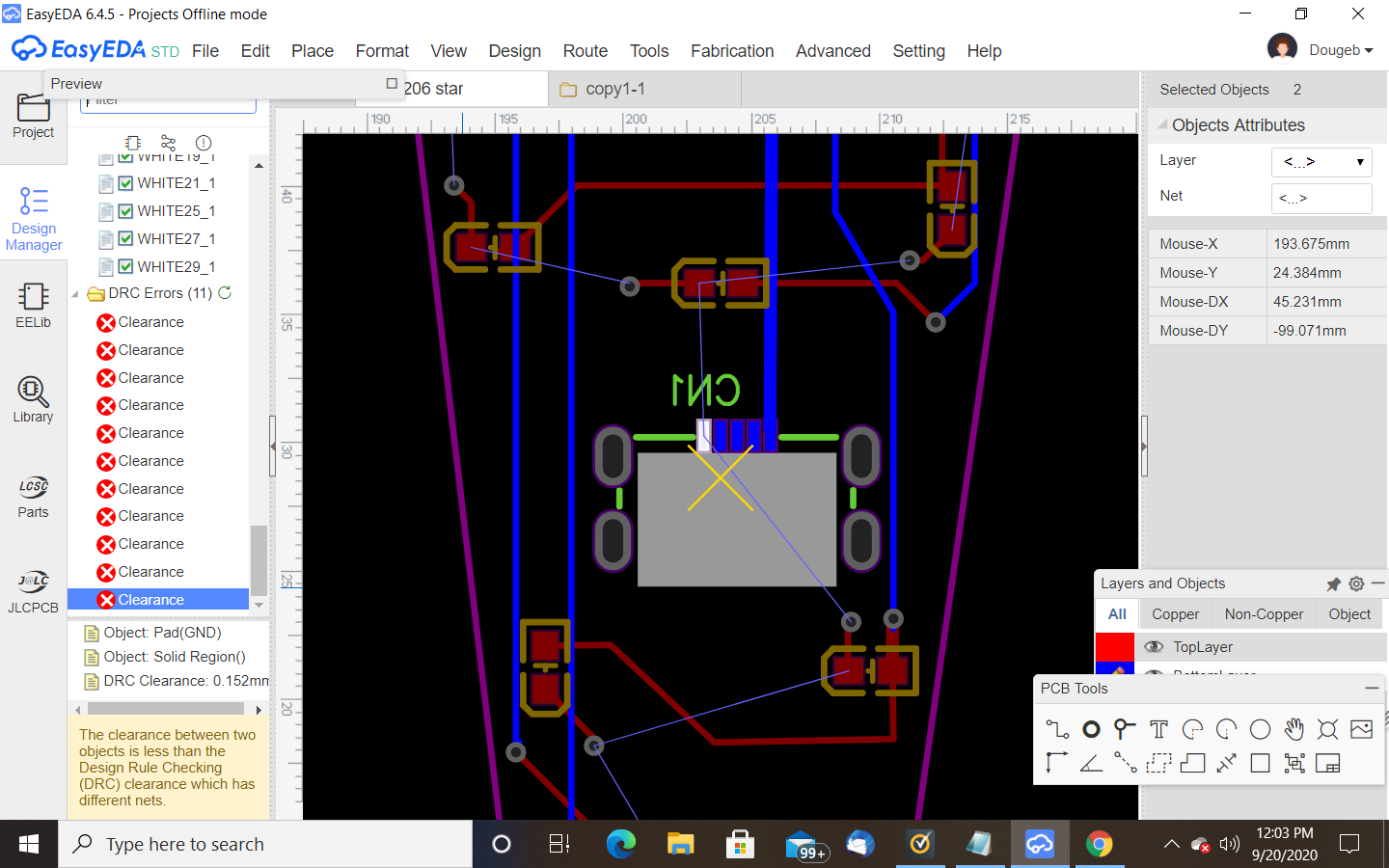

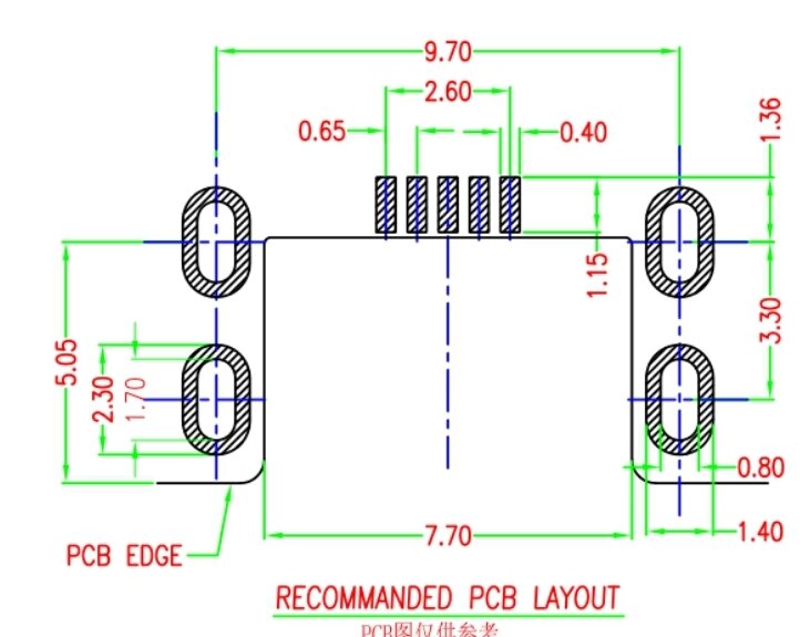

I changed the usb connector but keep getting drc errors
part # is C40940 or C40958
either one gets DRC errors?

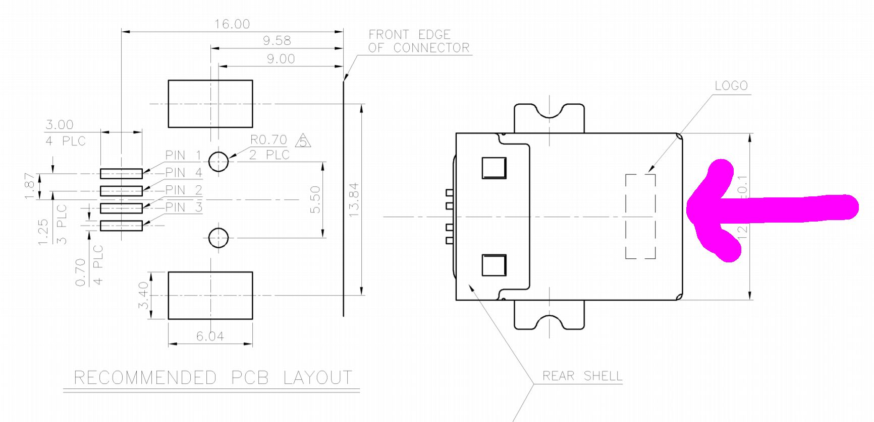

Sorry Charlie,
You need to look at the datasheets. Both of those connectors mount in a cutout at the edge of the board. They will not work placed in the middle of a board.
Depending on the settings in the design rules, on fine-pitched components, you may get a clearance error. Understand what "errors" can sometimes be ignored.
Notice the big square in the middle of the footprint? That's a cutout in the board. It must go at the edge of the board, and the connector body is between the top and bottom of the board.
