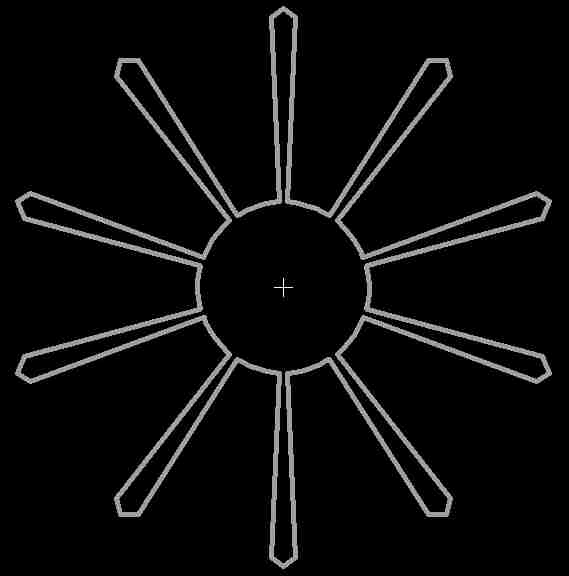

I have a shunt resistor - 5mOhm, 3W rating, 1% tolerance- and I pass through it up to 17Arms current, meaning it consumes ~1.5W.
It gets very hot when 17Arms flows in it.
If i chose a same shunt but with 5W rating, will it help conducting the heat?

Use a smaller value shunt resistor 1m maybe, that will reduce your power consumption dramatically but require more gain on your opamp, you don't want shunt resistors warm if you can help it. But if you're stuck with that particular shunt value the 3W you're using is fine, just make sure it has some space on the PCB and if possible attach a heatsink to it.

Heatsink can be an aluminium plate, with 5mR bolted firmly to it, to carry away the heat.

Yes, thats one way to do it.
If you can find an outdated transistor heatsink used for metal can packed transistors like BC160 you could use it on the resistor.
It looks like attached.

I'm not sure that i understood your idea.
How a transistor can be used for heatsinking?
Moreover, its an air-shunt, so how can you sink the heat that its body absorbs, if its body is high above?
Wrap something around it..... A heat sink is an aluminum sleave that spreads heat out over it's surface allowing it to dissipate heat. They weren't saying use a transistor to dissipate heat just that some older style transistors use heat sinks that will work on a shunt resistor.
Make sure you have decent air flow around the resistor though. You did already say it was away from the board which should be fine, I see power resistors mounted on stand about 2cm's from the board on many charge control circuits. I don't know how much that temperature increase effects the linearity of your current reading though.
