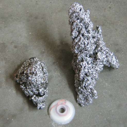

Nice, can you share this solder blob technique?
What looks like lubricant in Hakko wool is rosin and it does make it easier to solder and clean. It could be different in other wools used like Weller or clones. The Hakko wool is only $4 and I've only replaced it once in 10 years.
Here's a quick shot of 2 solder blobs from the workshop. The smaller is a lead-free one, it is not as old as my main blob which is about 6 years old now. Smaller is about 1.5 pounds, larger is at least 4 pounds and 7 inches long.
This is the only tip cleaning I use, the hot solder iron tip is rubbed on the blob and fresh solder added to the tip and again rubbed on the blob.
The "aeration" is because there is a lot of air throughout the blob it doesn't suck the heat from the tip, so the tip is cleaned while quite hot. The blob melts locally in contact with the tip, to an extent, so the tip is being rubbed on something softer than itself but also quite metallic so it polishes the tip metal very glossy, and comes away from the blob tinned and lubed. Rubbing metal on metal polishes the metal shiny, and you can press pretty hard on the blob.
There's also some flux in the blob from when excess solder is wiped off the tip, so it does everything (with addition of fresh solder to the tip) you get old solder removal, polishing, re-tinning etc.
The brass sponge does not compare, you have to re-tin the tip after wiping and it smokes upshowing you picked up contaminant oil from the sponge which has to be burnt off. Maybe the sponges come good after enough use?
The blob rules. ;)

Nice, I've never used one but in theory it should work better if not equal. How did you get so much solder to make the blob, from waste around the plant or did you purposefully use up rolls of solder to make it?
The brass sponge often doesn't need retinning because its not that abrasive, maybe if you jam it forcefully and repeatedly. But for the blob its like inserting it into a solder sponge, it will just picks up more than what's on it and loses the rest to gravity, into the blob hopefully!

How the heck did you make that huge blob? It's hard to tell from the pic, but it looks like solder wool.
Like sat says, If you just lightly flick your iron across the brass it cleans it and leaves it tinned. The smoke is from a gentle rosin flux that helps remove oxidation.
The blobs are made from waste solder, basically every bit of solder in my workshop is either on a PCB or ends up on the blob. No fresh solder was harmed during the making of the blob. :) I use a couple (a few?) 250g rolls of solder a year, so it probably took the waste from 20+ rolls to make a 2kg blob.
I suppose it's a bit of a recycling thing too, no solder goes out in my trash although occasionally dead components do.
Maybe I didn't give the brass thing enough of a go, I didn't like the way it was springy so tiny splatters of solder flung off all over the place, and I don't think my brass had flux on it, it was some type of oil that felt slippery and left the tip needing to be re-tinned each time. It's still sitting in the workshop somewhere. Maybe with enough use the oil would burn off and the springyness would pack down?
Nice, that gives me an idea, I think it will take a while for me to collect that big a bunch of waste solder, but better than throwing it out. As for the brass sponge, methinks if the solder blob is superior why move back? I only use the sponge because I can buy it easily. BTW, the real Hakko brass sponge is different from the clones. I'm very leery about buying Hakko branded stuff online, its inundated with counterfeit, but you can tell only when you have the real thing side by side.Its not widely advertised that Hakko has a web store, they don't advertise so as not to steal sales from their distributors, UPS ground pricing is 'free' as its already imbedded in the list price of the products they sell.
So then what do you do? Melt the waste solder and drip it down onto the blob? How does it become aerated?
My wool is inside the enclosed cavity of my iron holder, so the projectiles don't travel too far :)
Nothing so deliberate! It's just natural. Whenever the tip looks a little "off" I dab a touch of fresh solder to it, this fluxes and wets it, then immediately just wipe that excess off onto the blob.
That's the whole process the majority of the time. Occasionally if the tip does not look perfect after 1 wipe I press it quite hard on the blob and after a couple of seconds rub it back and forth with a bit of rotation too. That burnishes the tip and forcibly removes any corrosion etc on the tip's metal. Then a touch of fresh solder on the tip and it's perfect again.
Basically any time the tip is not full glossy shiny silver looking it gets wiped on the blob.

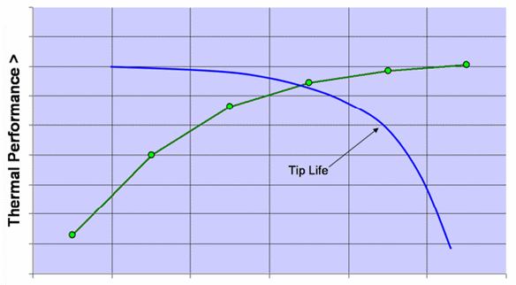

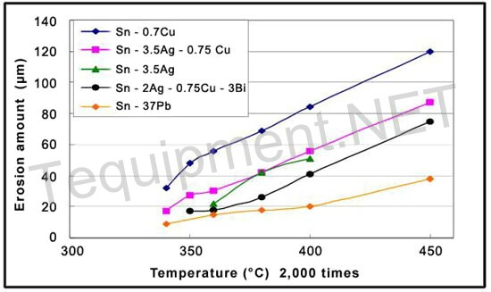

The summary is you want to know ~ 350C because of these graphs. You needn't be anal about it, being off 10C likely won't matter:
The rate of wear on the tip begins to accelerate past 350C, and its worse with lead free solder:
The cross over point between efficiency and heat is at that level, here where green and blue lines meet
So in summary, by knowing the 350C mark is on your soldering tip, you can prolong the life of your tips by a very large margin. In addition, as described in the eevblog discussion, the probability of damage to soldered components, is far reduced the lower the applied heat is used.
