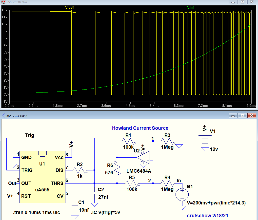

Been banging my head thinking about how to do a cheap reasonably linear VFC for measuring isolated solar panel voltages, the frequency output could be coupled optically, through a capacitor or by transformer (to name a few). Of course there are also isolation amplifiers but I don't want to break the piggy bank!
First off I came up with a 555 circuit using current mirrors but the latter was the problem as RS only sell them in silly quantities and the design called for both pnp & npn.
Later I looked at chips like the LM331 but put off by the prices.
Then I thought of the ubiquitous Microchip PIC, the problem is not so much the ADC (pays your money gets your resolution) but how to get the frequency out of it particularly if you want more than 8 bit resolution (that I do). There is no clock output from any timers and the PWM isn't exactly designed for frequency jumps (more duty changes). The SPI interface looks promising but limited to 8 bit resolution, the UART bit rate generator however can be put in 16 bit mode with a 16 bit synchronized load even in an 8 bit processor. By using this interface in synchronous master mode the clock comes out of a pin Aaahhhh.

Here's a 555 VFC that uses a Howland current pump circuit to give a linear charging current versus input voltage:
That does it for me! replace unobtainium transistor pairs with a simple r-r op-amp! Many thanks indeed, fixes all those nasty PIC problems and it's low power (given a cmos 555) :)

ATM in simulation I have this circuit working from 3 to 40V self-powered and consuming <8mA, I hope to improve on that in bench testing.
