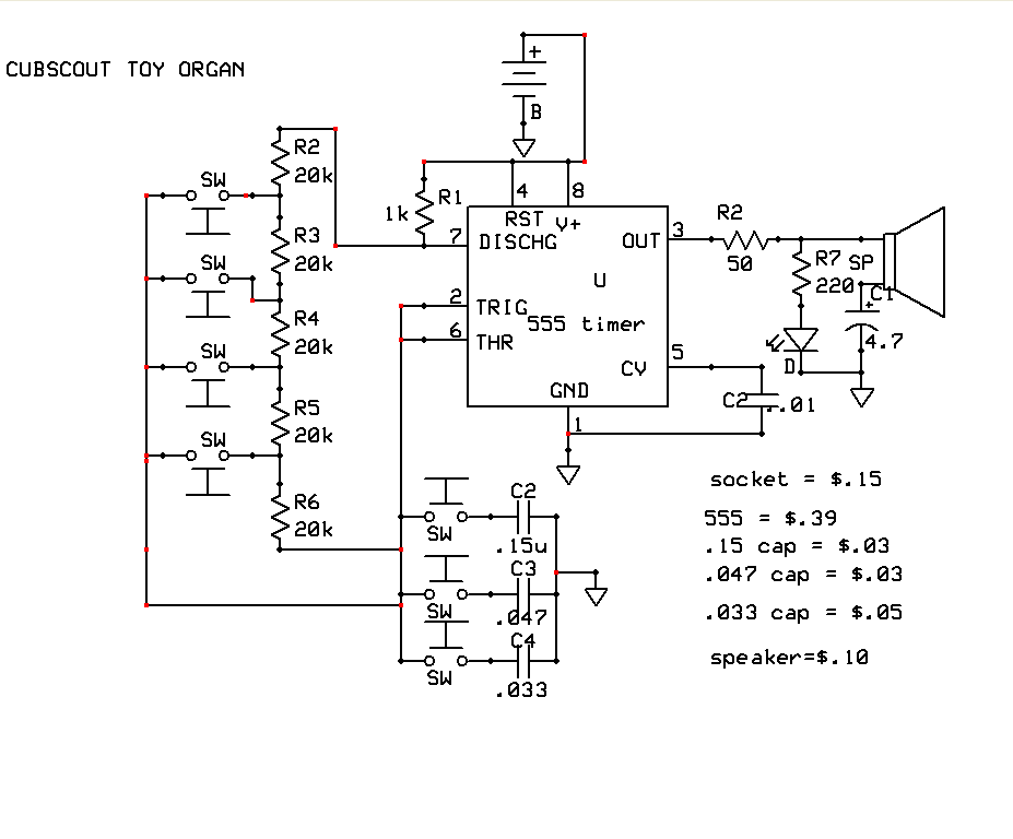

Here is a basic toy organ that my cub scouts are going to build using female header plugs (got 50+ for free) pcboards, 8 pin dip socket. really cheap speaker from Goldmine.
In theory it will work but I also have 500 LEDs coming my way as well but trying to come up with a way to include numerous LEDs in this circuit
any ideas?

MrDeb: Since you have a switch for each "note", why not tie a LED with it? Make each note light up as they press it.
thats what I was thinking but the leds won't come on using the 10k resistors. ??

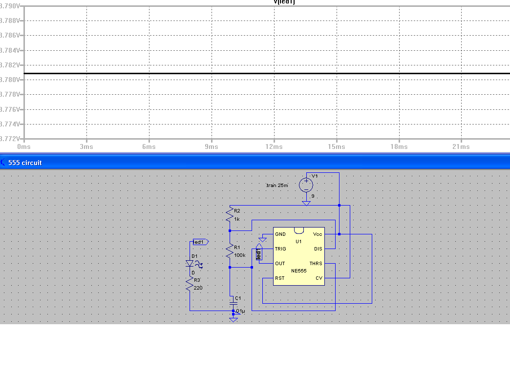

my other problem is why the LT spice dosn't show my square wave?
LT spice circuit
no square wave out of pin 3??
must have missed something?

thats why I like simulating a circuit but can't get a square wave out f LT spice?

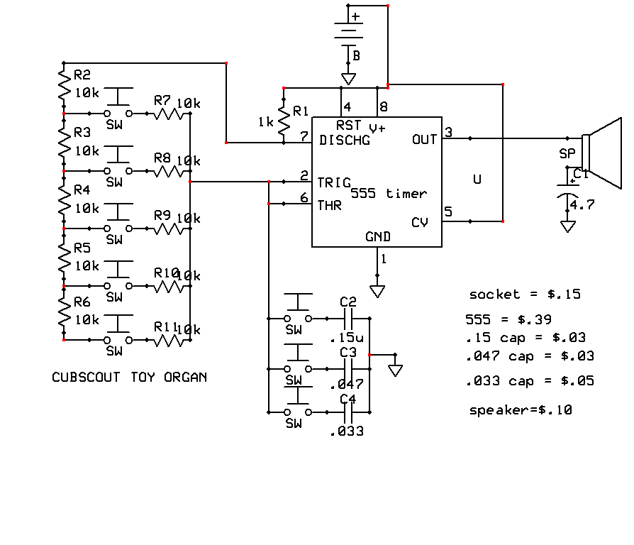

Your buzzer circuit doesn't buzz because you have pin 5 of the 555 shorted to the positive supply. Leave pin 5 unconnected.

This gizmo is really got me perplexed. there has to be a way to make the buttons change the resistor values as well as light up a separate LED.
I played with diodes in different arrangements but?
well I am thinking one or the other
blinking LEDS (pushing buttons and turning on an LED) or making sound unless someone can come up with a solution.
I got it where the LEDs are n the circuit but only drawing PA=really dim leds
