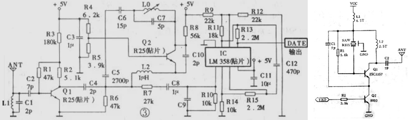

And they 'fail' because as soon as the key is released, or it reaches the inter-frame gap, it starts sending out random rubbish'. For a transmitter I'm using a number of different PT2622 based key fobs, all of which work perfectly with the cheap Chinese relay remote modules, like this one:
So I wired the radio module on the relay module to the PIC, where it works fine - it still outputs random rubbish without any signal (as expected), but not so quickly as to happen in the inter-frame gap, and stop the decoding process.
I tried adding a wire aerial to the receive module (I hadn't bothered originally, as I was only a couple of inches away during testing), and if I get close enough it will work - but more than an inch or two, and it stops working again.
I get the same results using them with an Arduino Uno, and the usual libraries.
I'm presuming the modules are 433MHz and not 315MHz?, they were ordered as 433MHz, along with the respective transmitter modules (which are clearly marked as 433MHz), but the receive modules aren't marked in any way. I've taken the keyfobs apart just to check, and those are 433MHz as well. I seem to remember I might have a 315MHz key fob somewhere?, I'll have to try and find that, see if it's any better.

That style receiver appears to be more commonly available as an "XY-MK-5V" (or MX-05) and there is quite a bit of data on those.
It's a minimal AM RX, so noise passes through the data slicer when there is no signal.

Nigel, a while back I experimented a little with those receivers. Fortunately for me, at the time I had access to a lab which possessed an RF generator and spectrum analyzers. What I found back then was how easily one could detune those tuned-radio-frequency (TRF) receivers. Those unshielded trimmer inductors are undiluted POS.
Try to obtain a superhet one, and one which has a crystal. like the one shown below.
Some of the sellers of the cheap receivers claim to receive both 315 and 433MHz; the tuning is "selected" with the antenna length.
Some of the stuff I found says it's selectable by adjusting the coil in the centre.
Well, that would make more sense. It could be tuned without special equipment by maximising the amplitude of the analog output (the input to the bit-slicer opamp), while the transmitter is pulsed.
If the tuning-by-antenna-length statement were true, then the receiver selectivity is garbage.
Well selectivity is going to be crap, it's a crap circuit - but it is dirt cheap. Check the circuit above.
