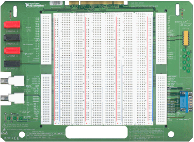

William At MyBlueRoom New Member Jul 4, 2006 #3 Found it, nice. Just 2.2K and tie two pins together is 2.5v? PS I love Abacom products. I use the PCB layout software, might look at their capture software too. I wonder is Splan can be used for protoboards? PS thanks Nigel, these forums are very helpful. Great job to you and the other admins. Attachments NI-ELVIS-top.gif 54.4 KB · Views: 491
