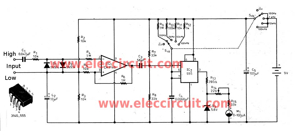

For A prototype used analog DC meter (or galvanometer
) of 100uA (Full scale) Read convenient frequency. Because there is made a full-scale range, 4 ranges are 100Hz, 1KHz, 10 KHz and 100KHz.
How the circuit works
-In figure 1 is the complete circuit of the cheap frequency meter. This circuit uses two ICs are CA3130 and LM555. The first is a OP-amp Ic is work faster and has the input impedance is very high. This IC is connected as the schmitt trigger circuit to extend the input signal to act up and force you to convert the input signal to a square wave with a fixed height. For the second IC as a timer IC NE555 which is connected as a monostable multivibrator circuit. It will be provides pulse width at the output every time, when has a input complete 1 wave.This pulse will be entered to drive a Moving Coil Type Meter The meter needle indicates an average voltage value of pulse. Which the needle is pointing more or less in proportion to the frequency of input signal.
-When you know the principle roughly, to view the detail of the works. The input signal will be entered to IC1 by through the capacitor C1 to block a DC current that might be coming campsites. They R1,D1 and D2 will act limit size of the input signal is not too higher than voltage drop across diode. While is directed bias to not high until damage to the IC1,R6 and R5 act feed back a positive mode, To create a hysteresis in the area around the level zero voltage of the input signal. Having the hysteresis allows the circuit to be less interference from the noise signal.
-Sine this circuit uses a single power supply source to convenience, so must connect the R2 and R3 to bias to the input pin of IC1 is about half of the power supply. The output from pin 6 of IC1 will be the square wave. Which has frequency equal to the input signal. The square wave signal will be differentiated onto as narrow pulse like a needle shape with C3, R7 and R8. The value of these is assigned to a needle pulse width less than pulse that IC2 will be created. To ensure that IC2 can function correctly, and high reliability.
-This needle Pulse act as signal that enter into trigger to the monostable multivibrator circuit works. The width of pulse that out to pin 3 of IC2 depends on value of C4 and resistors R9-R12 Which the is used to define the frequency range to be measured. Frequency range, these measurements will be provides duty cycle about 75% at frequency 100Hz, 1KHz, 10KHz and 100KHz (select by S1).
-The pulse that out from the IC2 will be be trimmed to size constant at 5.6V. By using the zener diode 5.6V D3 to read all time accurately. The voltage of the battery will decrease.
Note: You can use the input 2 channel “High” or “low” as voltage input and this circuit is desogned for low frequency of 10HZ to high is 100KHz.
