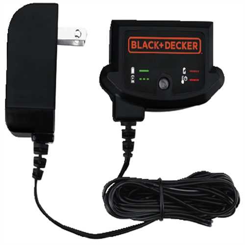

Ylli,
Thanks for the links. I can not get a picture of the other side of the charger. (looked for weeks) So far all the B&D chargers I can get pictures of show the wrong sex of connector. (or don't show the under side)
This is not what I have. I have the reverse where the charger has the metal blades sticking out and the battery has female parts that are covered up where you can't see them. I need the reverse of this:
Does this help ?
Thanks.
I think I will get one of the $15 slow chargers. Not the $60 fast charger. I can get the drill + battery + charger for $29 (old model clearance). Or I can through away the drill+battery when it runs down.
It just bugs me that some of the chargers say 12/20V in the title while the "wall wort" part says to be used with 20V batteries only. The chargers in the store say 20V only and look just like the 12/20 chargers. How 12/20 when the battery data sheet says a 0.1V error in voltage will shorten the battery life?
