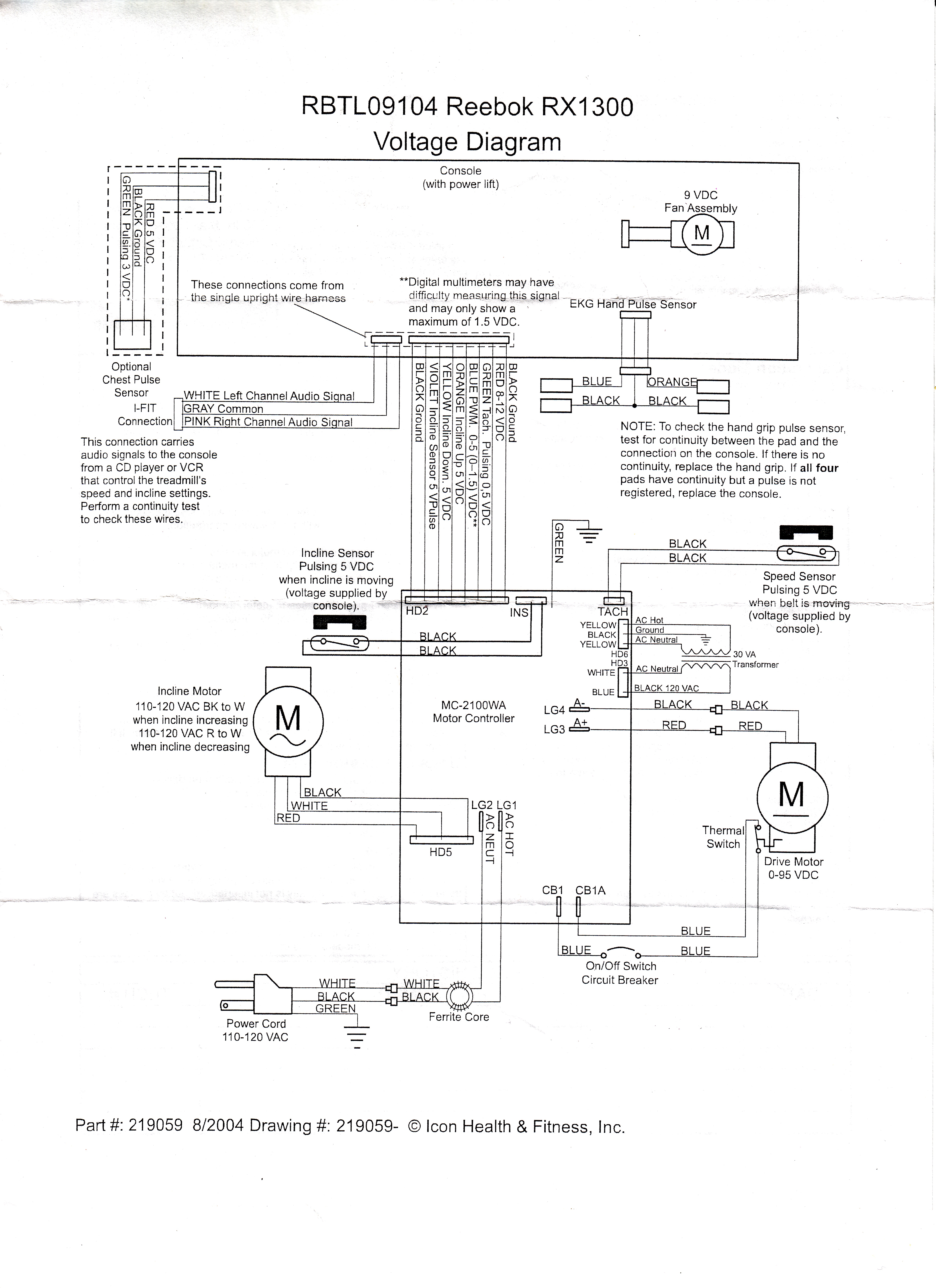

I found a basic troubleshooting schematic for the unit (attached) and was able to confirm some operations. All the voltages from the console to the motor control board seem to be 0-5 volts. Using a 1.5 volt battery I was able to jumper the incline pins and get the motor to work. Using the same battery I attempted to jumper the main motor pins (the schematic says "BLUE PWM 0-5 Volts" but also says "digital multimeters may have a problem reading the voltage and may only read a maximum of 1.5 Volts") When I jumpered the pins using the battery, the main motor sometimes attempted to turn for a short time (.25 to 1 sec), but not under constant application of voltage to the pins! It seemed to work sporatically when there was a loose conection or when I deliberately wiggled the wire to pulse the conection! Does that mean there is some sort of PWM circuit in the console that pulses 0-5 Volts to the motor control board to run the motor? I am assuming that pulsing 1 Volt will cause a set speed, while pulsing 2 Volts will increase the speed (and so on).

If you have the incline motor working; then I would perhaps take a look at a simple method of controlling the drive motor with an appropriate 120 Vac Variac. Simply rectify the variable 0 to 120 Vac output with diodes. Which would connect to your "CB1" and "CB1A" inputs of your Drive Motor.
Vdc=2*Vp/3.14=2*170/3.14=108 Vdc; the 170 Volts peak is 120 Vrms max out of the Variac ( or 105 Vrms for 95 Vdc).
The turning radius of the Variac would need to be mechanically limited to allow no more than a 95 Vdc output; as stated on your schematic-or even less if the household AC current exceeds 15 Amps at full motor speed and load. The specs for the diode current rating and PIV must be calculated. Everything is easily found on the net. As with any circuit built to run off household AC-an appropriate circuit breaker or fuse should be installed between your power cord and Variac.
