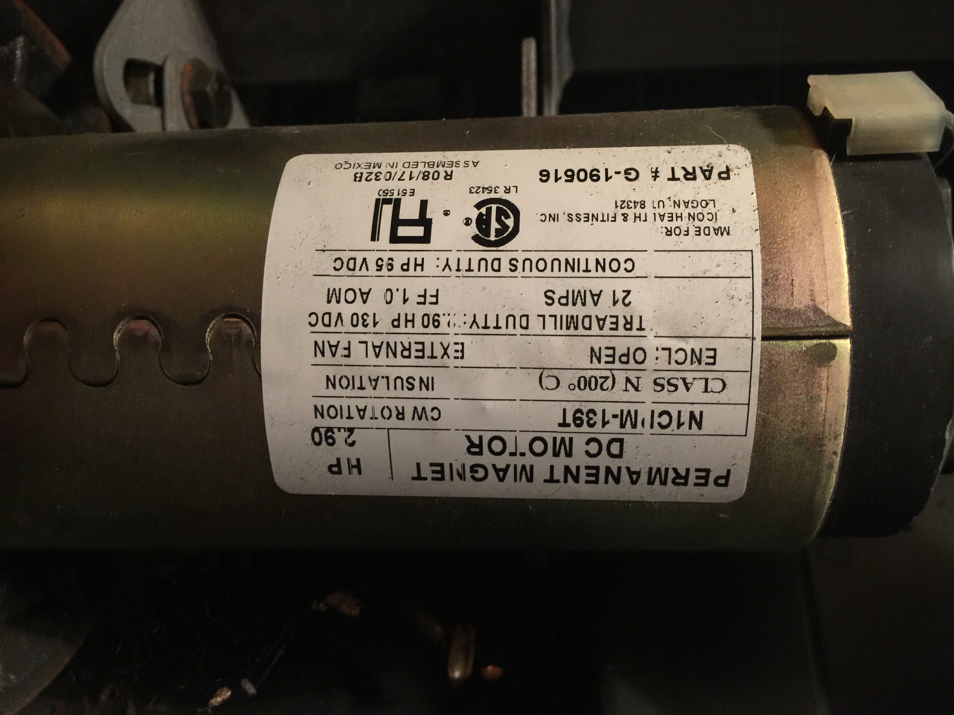

I am also trying to convert a treadmill to manual. I uploaded a photo of the motor.
I found this on eBay. Will this work to control this motor.
https://r.ebay.com/d8a70D
Check for 8~12Vdc to run the touchpanel
PWM control drives the motor. Tach reports back speed. Panel regulates the PWM to match target speed.
The motor needs 21A 95V for 2.9Hp
So for my project ct I am actually ditching the control panel. All I want to do is manually control the motor. I'm kind of new to this. I'm just trying to figure out if this should be able to control my motor if I hook it directly to the motor.
Thanks for the help
Mark
300W is about 0.4 Hp, so It will not be full speed or full torque
You need to look for a KB/Baldor DC motor controller (ebay), either SCR bridge type or PWM (PWM is the better one).
Usually the only reason the plate is marked CW rotation is because of a threaded flywheel if fitted.
The ebay item you show is not a controller.
