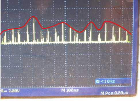

The attached oscilloscope screen shot shows a series of narrow pulses (or spikes). They were created by shifting the DC level of white noise, and feeding into an op amp so only the uppermost swings of noise remain at the output.
The peak voltages and intervals between pulses are therefore random within the numerical range indicated by the screen information.
What I am trying to derive from the above signal is a smoothed, analog-like waveform with fluctuations that roughly track the changing noise amplitude, such as indicated in red on the oscilloscope screen below.
Can anyone advise regarding possible design approaches?
Without being able to see into the future I don't see how you can determine a slope to the next peak as you don't know which way to go up/down.
Edit, unless the output can be delayed relative to the input which is the equivalent of seeing the future.
Good point. That implies an approach that incorporates a time delay.
Is what I am trying to do not that dissimilar from converting a PWM signal to analog?
It also implies some kind of memory either analogue or digital. Not the same as PWM as that is effectively just a filter, this is tracking peaks. Maybe one of the analogue guys has an idea.
Maybe some kind of delay could be implemented after each voltage peak, that decays until the next peak occurs. Obviously, there would be a near instantaneous rise at each leading edge, but that might be an acceptable compromise.
The objective is simply a random "wavering" signal. It does not really need to accurately track the noise peaks. They are just there to provide the randomness.

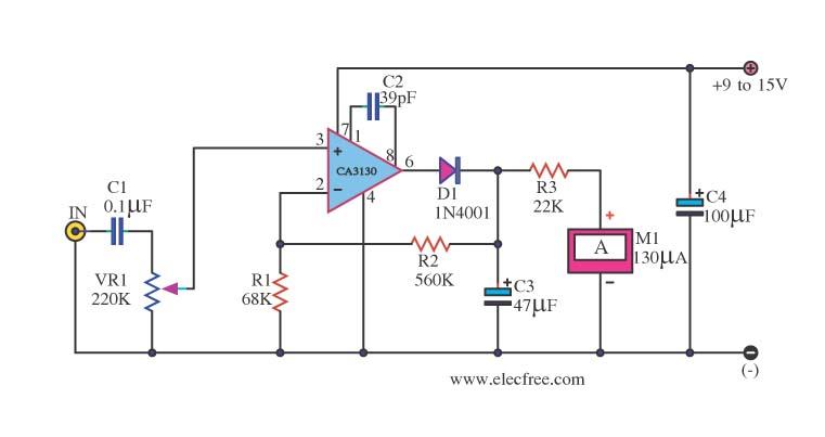

I think you may need something like a "peak detect" VU meter circuit, as used for audio level monitoring?

I would start with about a 100ms time-constant and go from there.
With the 22K load (and no meter, presumably), try either 2.2uF or 4.7uF to start with.
That should be something roughly in that range.
OK. That gives me enough info for a few enjoyable hours at the bench.
Just one last thing. I would like to feed the output of the CA3130 into the inverting input of an LM358. Should I just take the signal off between the diode and R3, leaving R3 at 22K connected to ground (with no meter in series)?

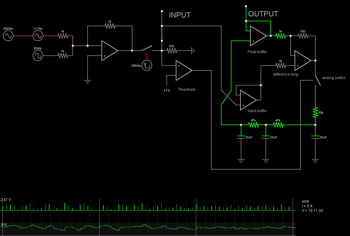

Here is a "rough draft" Peak tracking circuit that will bump a sample and hold up or down depending on the last value compared to the current value.
Everything to the left of the INPUT is for pseudo signal generation. Depending on your frequency you can adjust the 47k resistors and 10nF caps on the output stage just before the "Peak buffer". You can adjust the Threshold voltage also, but it needs to be something other than 0V.
Yep, that should work fine.
For audio output (?) another series resistor and small cap to ground may improve operation, to smooth out the sharp rising edges each time a new peak occurs; it's likely to be nearer a vertical edge sawtooth at R3.
And / or a lower value resistor in series with the diode, to limit the rising edge speed.

If I understand correctly, for simulation purposes, a 250Hz pulse is fed into the "threshold" amp. My random signal is centered around 10Hz, so I will change the filter values accordingly as advised. From the trace at the bottom of the diagram, I can see it gets shifted to 2.47V.
I intend to power the entire circuit with single supply 12VDC. Would LM358's be suitable? I happen to have a lot on hand.

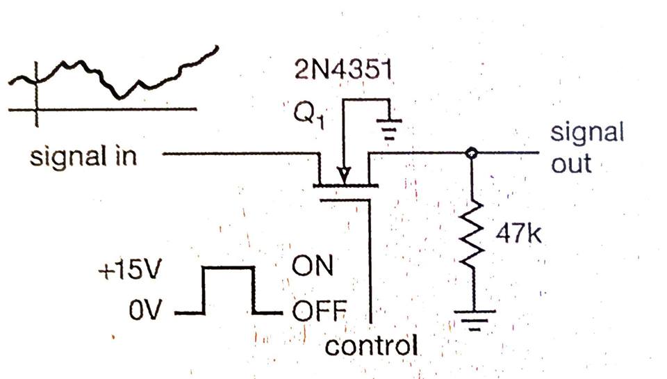

This looks like a good choice for an analog switch IC? https://www.mouser.com/ProductDetail/Analog-Devices/ADG417BNZ?qs=BpaRKvA4VqHUaH0kwDpc4w==
I don't know what the voltages are around the switch as drawn, but could I use something discrete like this?
The 250Hz was just an arbitrary value I used to chop the pseudo signal generation section. In fact all of the frequency values to the left were just arbitrary values to get something that resembled your original image. The 2n4351 may work, but I would be more inclined to use something more suited for analog switching ... 2n5952 ... if you wanted to use descrete components... otherwise the IC would be fine
