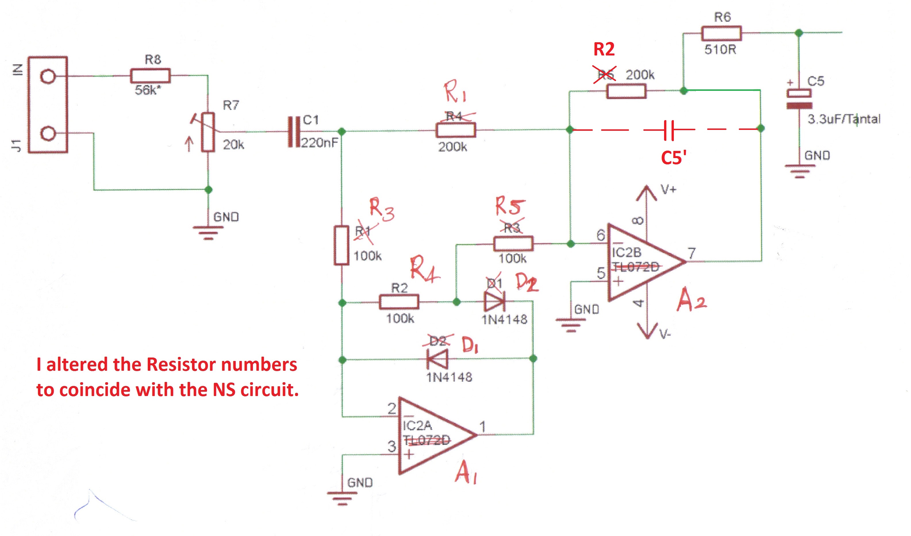

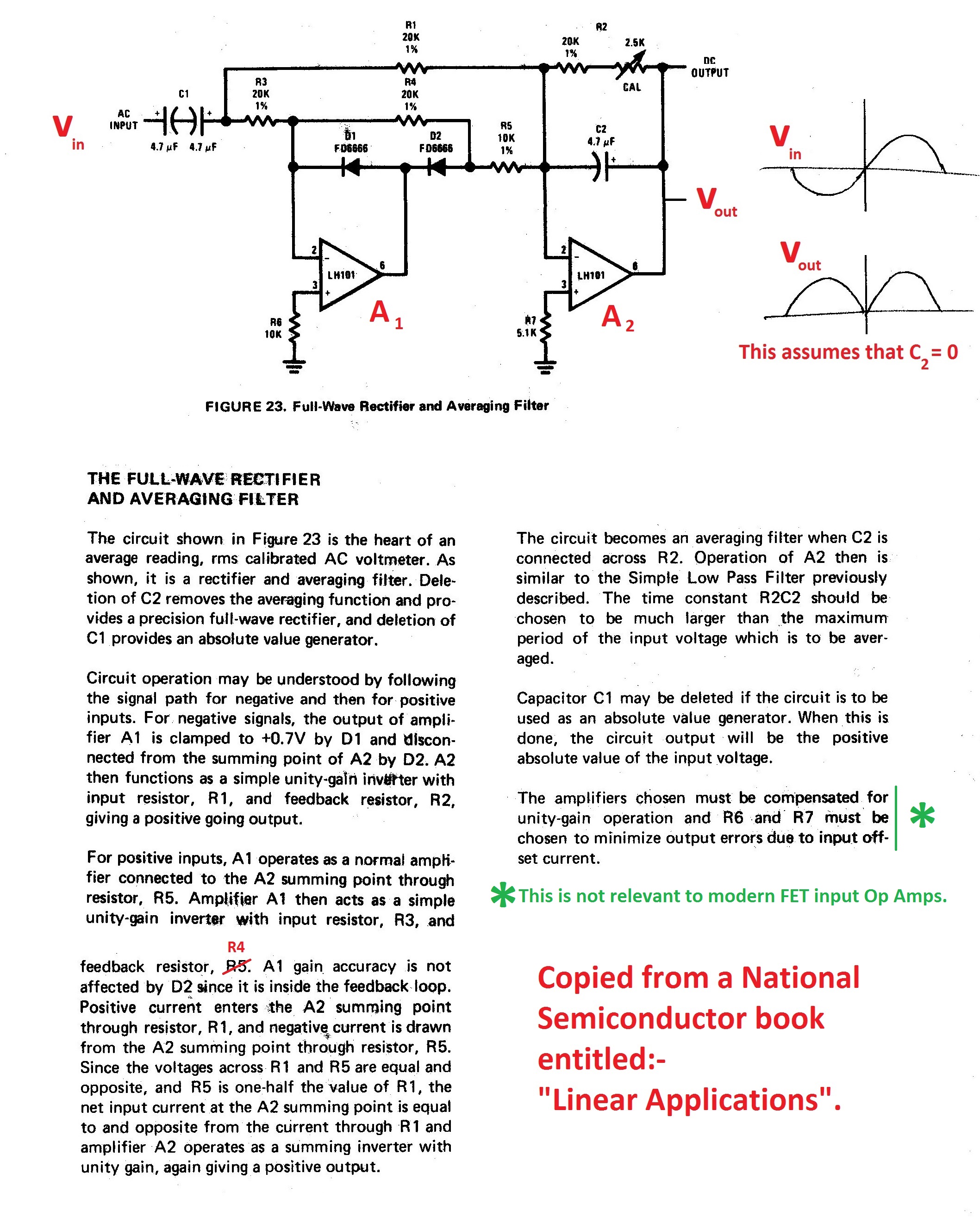

I ahve attached an item copied from a National Semiconductor (NS) book that was published in 1970. It explains how the rectifier circuit works.
The one you posted is based on this but it has 2 half wave rectifiers (HWR) in tandem to produce a full wave result.
The NS one is simpler as it uses a summing Amp in lieu of the second HWR as in your version.
The summing amp also does the filtering to give a DC level output.

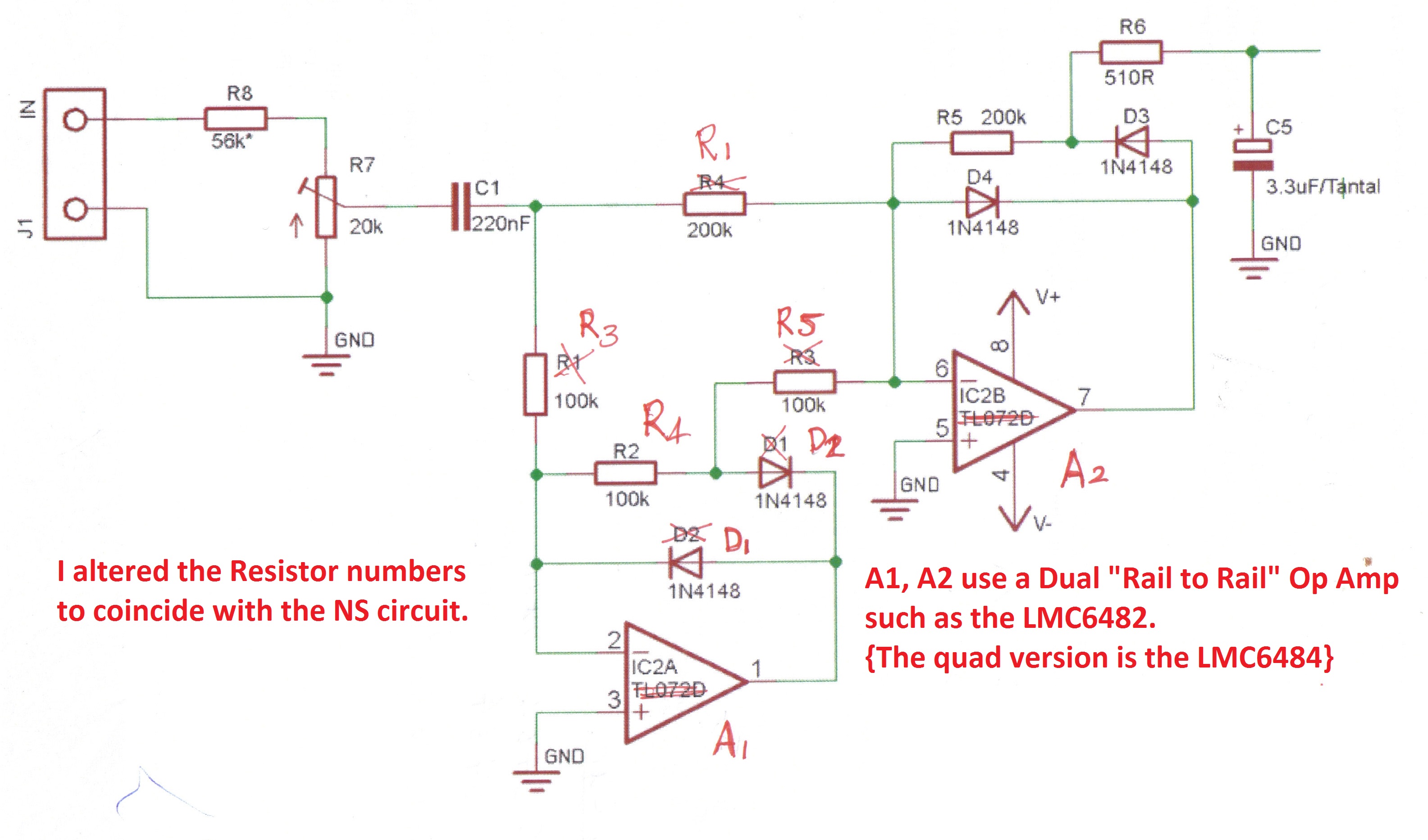

In order to use only one supply, you will need a "Rail to Rail" Op Amp such as the LMC6482. This a Dual package. The Quad version is the LMC6484. Both are sold by JayCar.

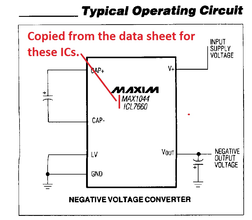

Here are my suggestions:-
1. You can replace the TL082 with a LMC6482. (You should compare their pin number as there may be some differences)
2. Alter your circuit to use the NS circuit that I posted above. The resistors can be 10 times the values shown in the NS circuit & the capacitors can be one tenth of those in the NS circuit. See the attachment FW Rectifier.
3. Use a Positive to Negative DC Converter as shown in the Pos to Neg attachment & thereby use your existing circuit with the TL082 ICs.

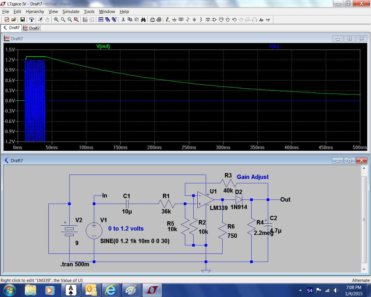

This is kind of crude, but I think it will work.
It divides your 1.2 volts down to below .3 volts because the 339 ESD diodes will clamp at about - .3 volts.
You could also use a common op amp like the LM358 or 324 that can sense at ground, but they have a little trouble at 20 KHz.
You should be able to find the 339 easily.

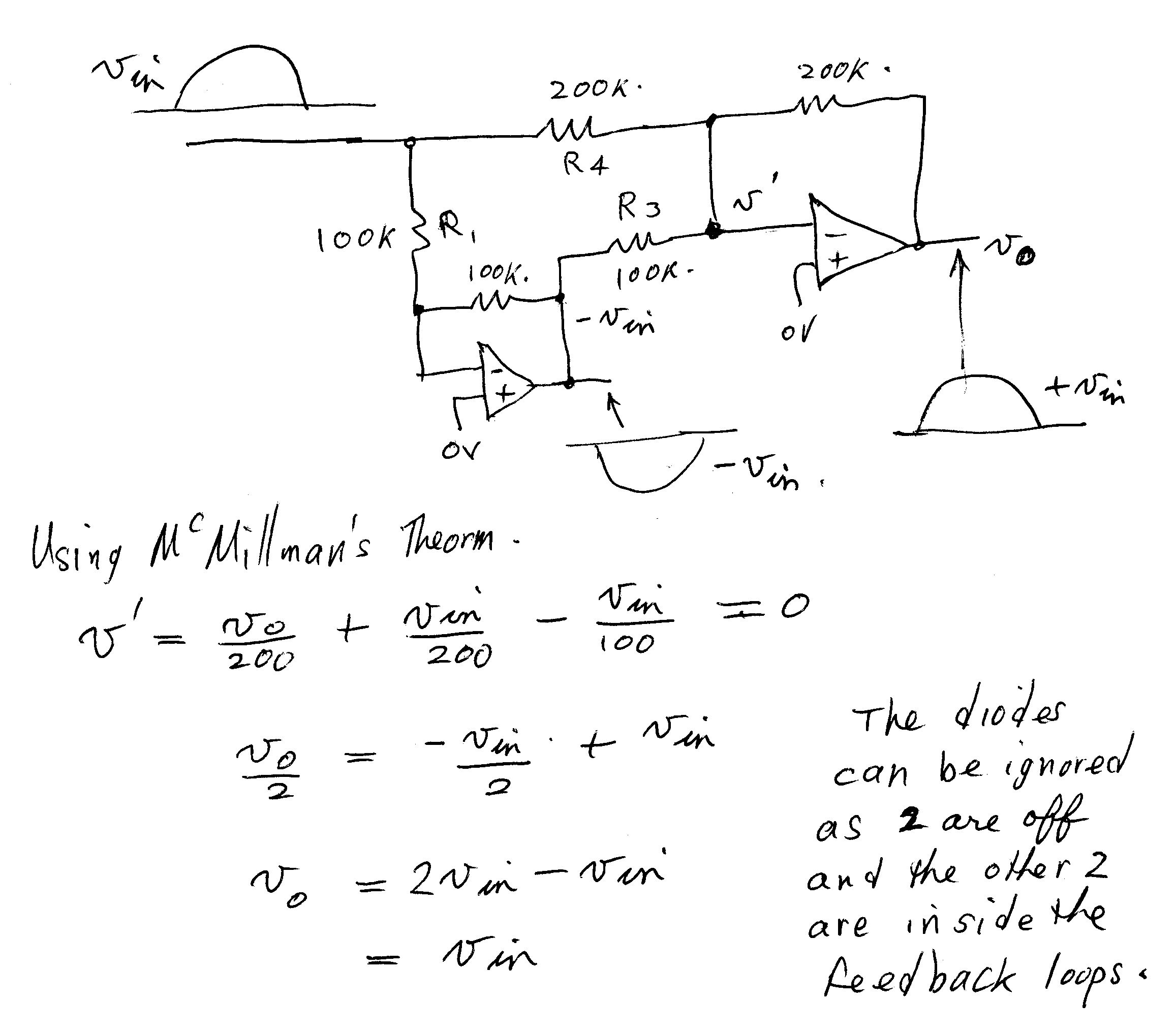

Yes, you're right except the part I highlighted in red needs some qualification.
The Pin 1 of IC2A must go sufficiently negative until pin 2 is at 0 Volt (due to the negative feedback). Thus pin 1 goes negative as the input goes positive in order to keep pin 2 at 0 Volt. So IC2A is acting as a unity gain inverter for positive inputs. See attachment.

It just occured to me that the Diodes D3 & D4 do nothing in the circuit posted by the Op.
When you remove them, the circuit reduces to the one I posted in post #5 that came from the NS book.
Also, Capacitor C5 can be moved to the feedback circuit as in the NS circuit & R6 is unnecesary. See the attachment.

Of course when the input goes positive, the negative output of the first inverting opamp must provide the same current in the output diode as the negative feedback current in the second opamp plus the input current ion the 200k resistor so that they cancel.
A peak detector is supposed to have a very fast attach and a slow release that cannot happen if the second opamp has a capacitor across its negative feedback resistor.
Agreed. That's what the maths in my post #16 shows.
