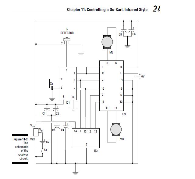

Ok so why post the TINY-IR-II design?
What's the resonators speed?
Which PIC are you using?
Which IR detector are you using?
1/ The TINY-IR decoder is the one used in the schematic. I need to understand this schematic before I can modify it.
2/ 4 MHz (although this is not the issue)
3/ I am not using a PIC. Please refer to my previous posts.
4/ Please refer to post #8 for encoder and decoder. The IR detector is one I've salvaged from a VCR recorder. It seems identical to the one used in the schematic.

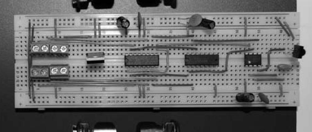

Okay maybe I should have posted the full schematic earlier. My apologies.
Ah well then you substituted a completely different part for the TINY-IR decoder.
How did you arrive at the conclusion an RF600 part could be substituted?
Neither the RF600D or RF600E require a resonator, they are made for RF.
They are also not IR modulators and may or may not be IR compatible and don't even have the same pinout as the TINY-IR (PIC)
Notes the book shows a TINY-IR (needed resonator) the TINY-IR-II does not.

Alright thanks the clouds are starting to clear now.
I only went for the RF encoder/decoder because I cannot find an IR one anywhere in the UK. Any suggestions for where to get one would be very welcome!
Also I have done my best to find the datasheet for the TINY-IR but all I could find was the TINY-IR-II. Where can the TINY-IR datasheet be found? Is it the same as the TINY-IR Learning Decoder ? In which case pin 2 seems to be an LED pin ...
The TINY-IR-II (it's just a preprogrammed PIC) can be substituted for the TINY-IR, just omit the resonator.
Sidenote, most IR detectors require decoupling. See the IR datasheet for how (usually 100ohm resistor & 4.7uF cap)
