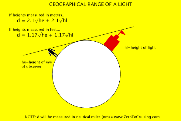

Line of sight depends on the height of both antennas.
d = 1.17 ×sqrt(h1) + 1.17 x sqrt(h2)
Where d is the distance in miles and
h is the height in feet.
Let's say your phone is at a height of 5' and the cell tower is at 50'. Line of sight distance is
d = 1.17×sqrt(5) + 1.17 × sqrt(50) = 10.9 miles = 17.9km
What happens if we use a yagi raised to 10'?
d increases to 12.0 miles = 19km
If we can get the antenna up to 15', the distance increases to 12.8 miles = 20.6km.
If the service is marginal, a few feet increase in elevation of the antenna may make the difference to get a reliable signal.

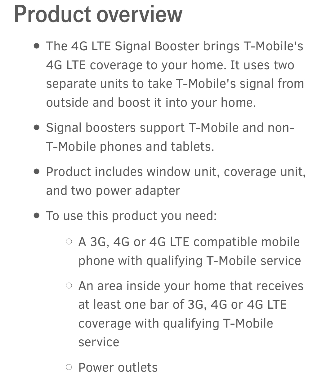

T-mobile and other cell phone companies offer "mini repeaters" for use where service is marginal. The uplink antenna is mounted in a window or on the roof, while the other antenna is mounted in the house. Indeed, this is the type of device the OP asked about.
Using a device such as this will increase range in two ways:
  • The antenna will be more effective than the internal antenna in the phone.
  • The higher antenna position will increase the "line of sight" distance to the cell tower.
The improved antenna position is accomplished without any cable losses, as there is no cable involved.
