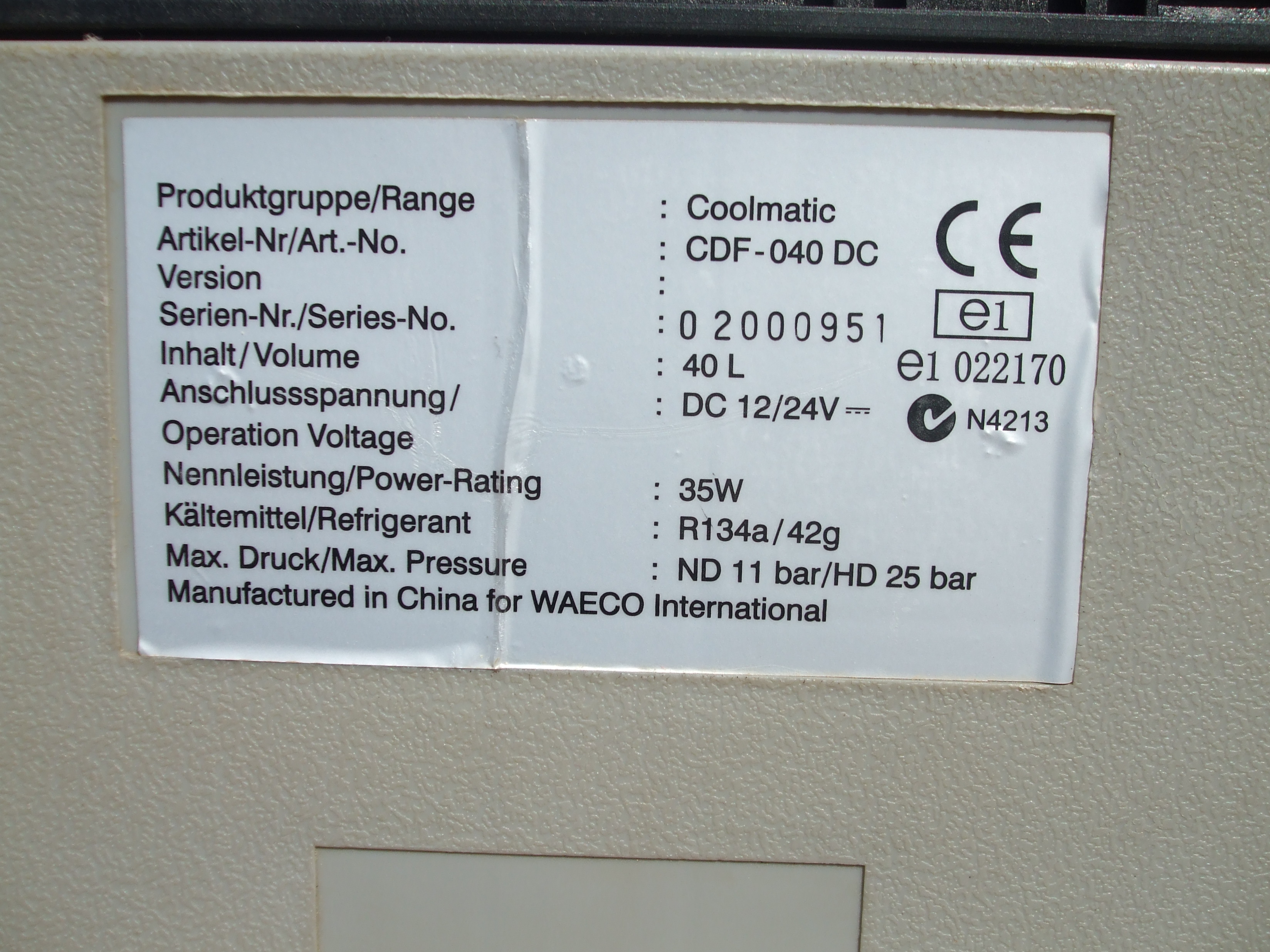

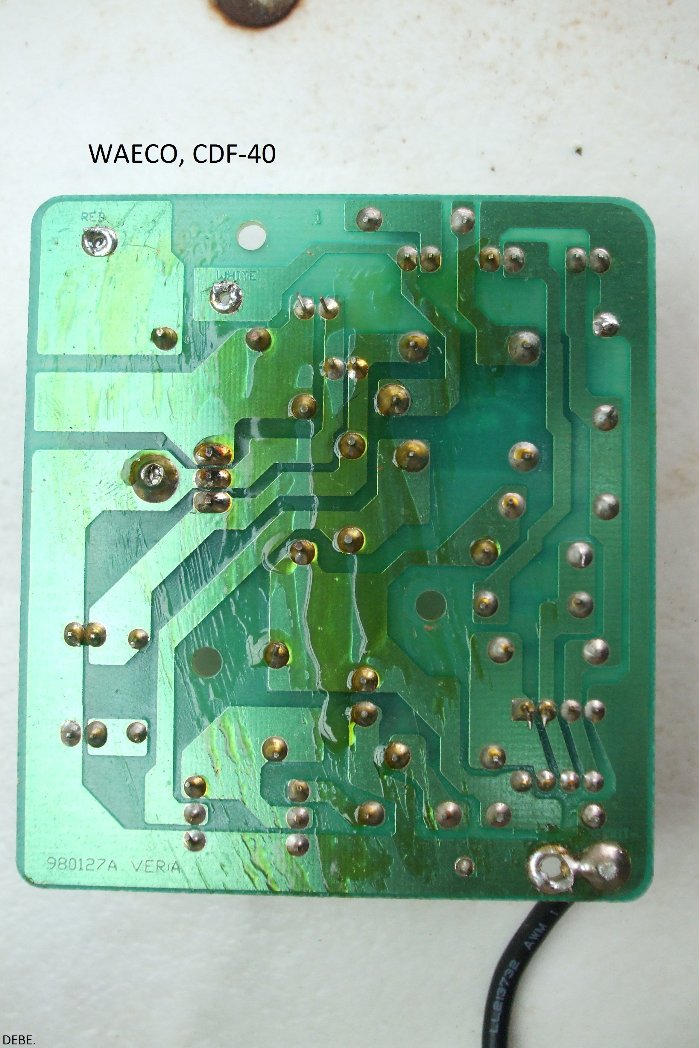

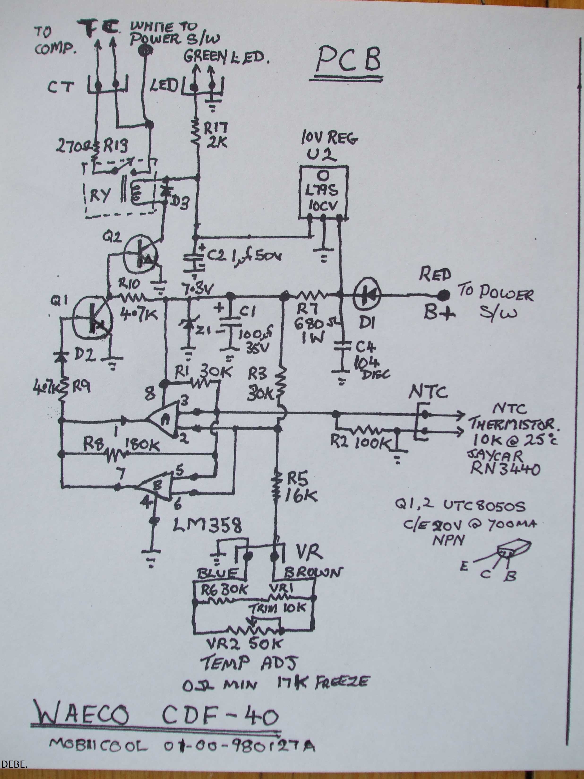

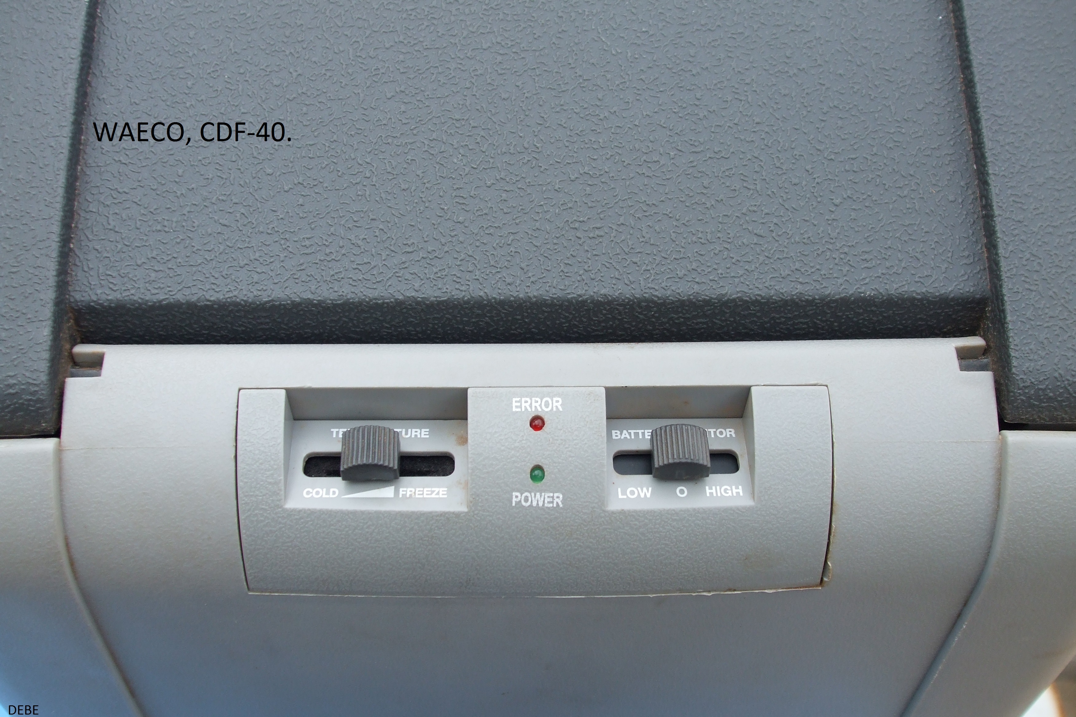

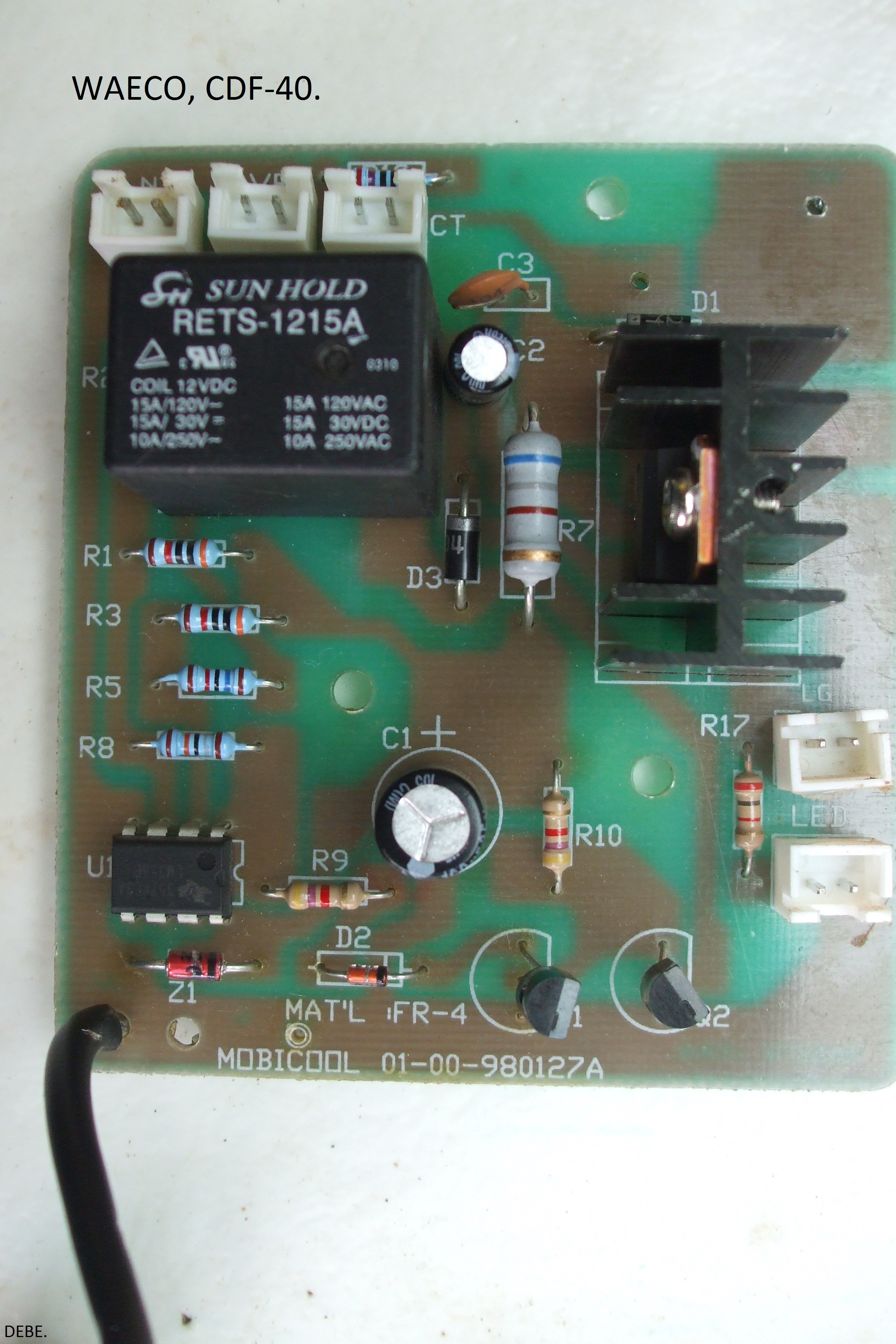

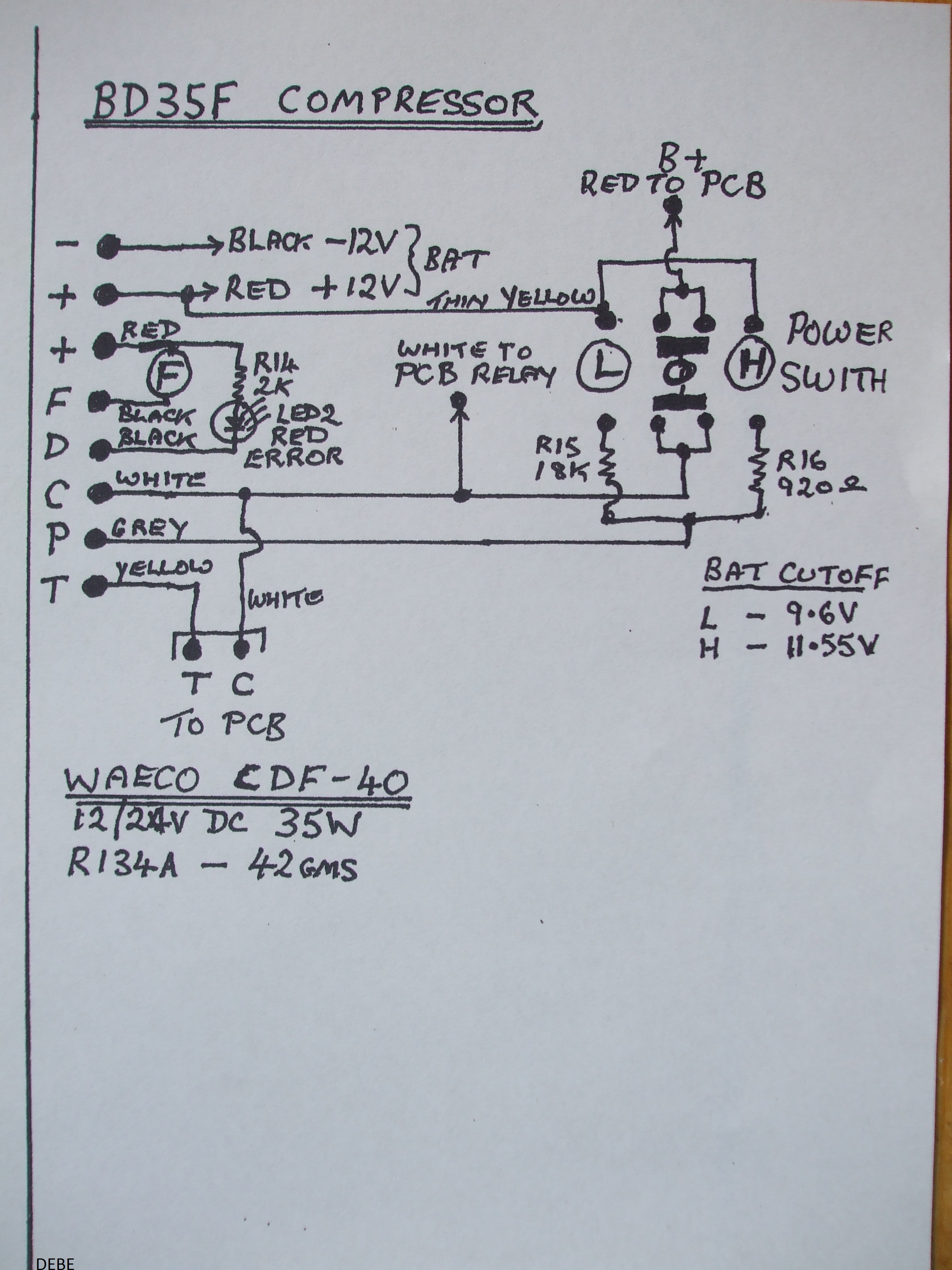

Information on Waeco CDF-40 portable fridge freezer.
