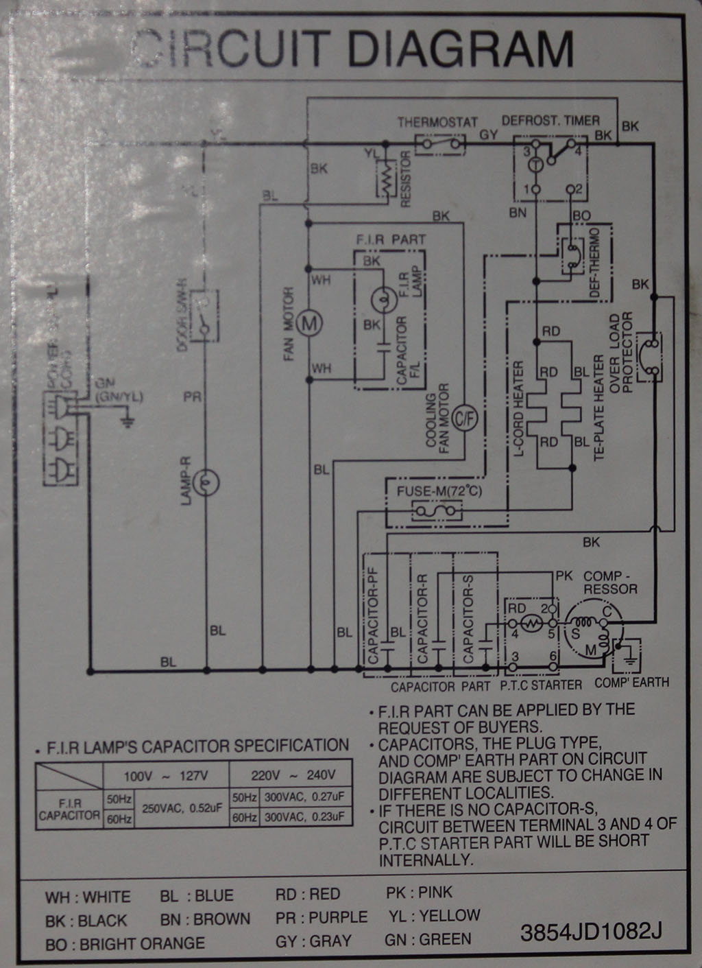

I have an LG fridge which is ~16 years old. Got home tonight to discover it's not working. It's got power but no motors are running. The schematic is on the back and this is it.

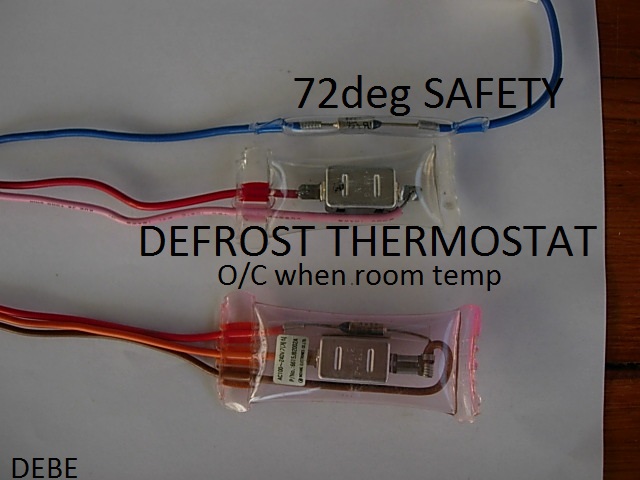

We have been having record temperatures her and the fridge is in an alcove. Could some sort of thermal cutout have happened? What does FUSE-M(72°C) mean?
Any help greatly appreciated.
Sounds like a thermal fuse that blows/trips at 72 degC.

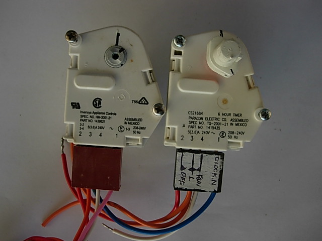

Look online for appliance repair video. I had similar problem and it was defrost timer.

If timer is stuck, that can be easily verified . Tap it or hot wire it

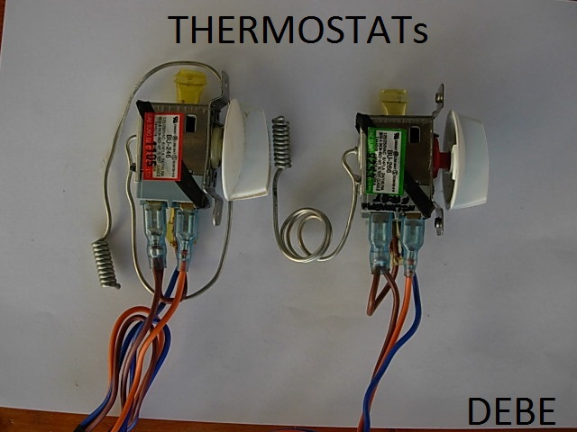

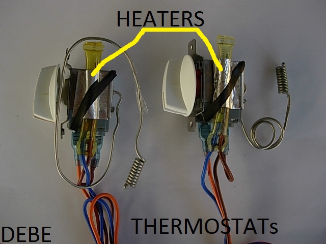

These things are not meant to be fixed. Thermostat OK, resistor next to thermostat reads 73K - anyone know it's purpose - only thing I can think is to warm the thermostat!!! Defrost timer OK. Can't get at the thermal fuse - can't find it.
Just thought to check if the FIR (Far Infra Red) bulb was working with my tablet camera and, when powered up, the compressor started up - yippee. I'm thinking it must be the defrost timer as I rotated it manually before testing. We'll see in another 6 hours. Time to reassemble and restock with warm beer.

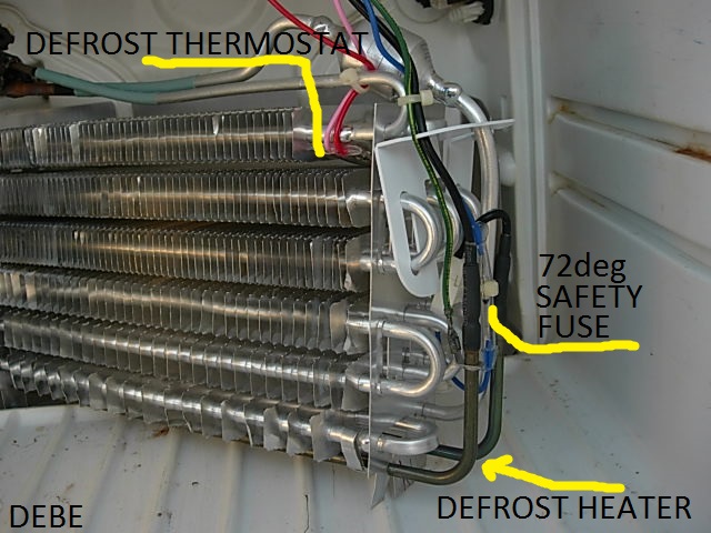

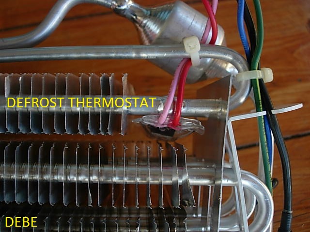

The Thermal fuse is part of the defrost circuit. It will be in the evap fins for protection if the defrost heater stays on too long & over heats. The resistor is taped to the thermostat to keep it slightly warm, this is common in frost free fridges with mechanical thermostats.

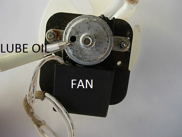

This is whats in your average Frost free fridge. If the defrost timer or any of the Defrost parts dont function properly, the evaporator coils become one large block of ice. Same result if the fan stops working, then nothing gets cold. The fridge these parts came outof the fan had siezed, note there is oil lube holes in both sides of the fan which freed it up.

Glad it started working for you. A stuck defrost timer is common. If it stops again, (should be cooling but no motors running) plug it in through a Kil-A-Watt (or other inline ammeter) and see if it is drawing current. If it is, it is likely the defrost heater stuck on.
