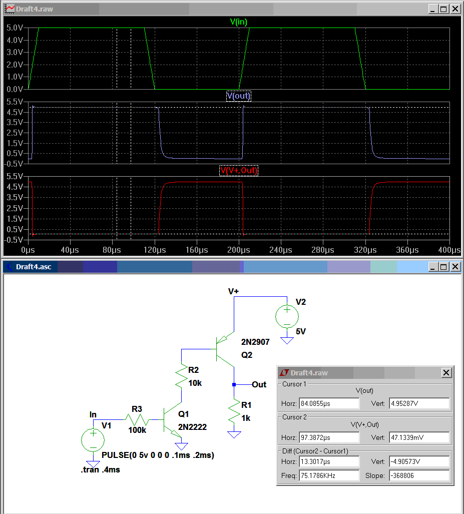

An NPN driving a PNP.... this is the point where I asked Crutchow "wouldn't the PNP also drop .7V?" Then he responded, "not if they were both followers the BE drops would cancel", hence the "DUAL FOLLOWER". And then my posted schematic was trying to figure out what he meant or how they would be connected... Note the post doesn't say "HERE IS THE BEST SOLUTION AVAILABLE". Or presented as a solution at all...

I suggest you reassess your electronics knowledge, the entire reason for doing it the way I proposed (and the reason it's always done that way) is because it DOESN'T lose 0.7V in that configuration, only about 0.1V or so (which is the best you can do). This is also the reason you should switch low-side, as you only need a single NPN then to give the lowest possible loss. The configuration also gives the best possible base current, so ensures best switching (your 'solution' doesn't 'switch' at all, but runs both transistors in linear modes).

Here is a simulation of the circuit NPN-PNP configuration I was referring too (and Nigel also I believe). As you can see the emitter-collector ON voltage drop of the PNP is <50mv. The minimum drop is 0.7V if it's an emitter follower configuration, but this is common-emitter.

you didn't, I was asking you if that was the circuit you meant, and/or to show me the circuit you were talking about
