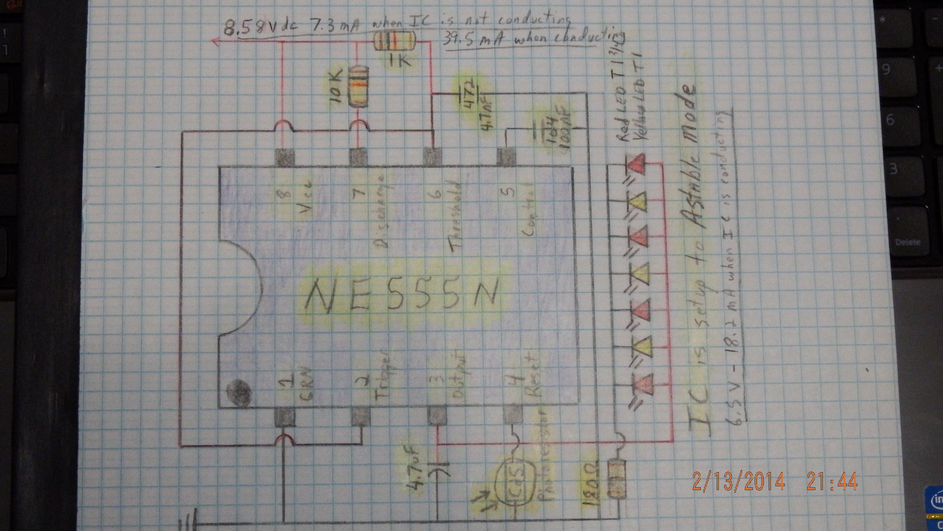

Aren't the transistors in the wrong places? Doesn't the Vb of the PNP have to be at least .7v less than the emitter?
er, no.
When the logic input is low, the NPN is off. R2 then pulls the base of the PNP to ground, turning it on and the emitter will be at .7V, turning the opto off.
When the logic input is high, the NPN is on, pulling the base of the PNP to +V - 0.7V, turning it off. R3 then supplies current to the opto, turning it on.
Actually, your post is utter nonsense. We were talking about a way to give a positive output without the .7V loss. We both understand you don't have to worry about the .7V drop using an NPN to turn on a PNP because you are driving an LED that's grounded. That's what my post #6 commented on that using the NPN to drive the PNP would drop .7V, and Crutchow mentioned an NPN follower and PNP follower wouldn't.
Sorry, but the BMP circuit you posted (and please don't use massive BMP's, use GIF or PNG) is exceptionally poor, and very current hungry (using more current when switched OFF than when switched ON).
The correct method (as linked in my tutorials) produces far better switching and uses no current when switched OFF - not that it's 'my' circuit or anything, it's the standard common way of doing it (for good reason).

ok, had momentary brain fart... was thinking the pnp base resistor in series between two transistors.
Like this (R3 is opto current limit resistor):

I need to find one that is quick and easy to use. I don't want to waste all day drawing a schematic.
I tried to post a picture of a schematic that I drew by hand, but it won't work for some reason.
Cool!! Somehow I got it to work...
I've since changed the circuit and gave each LED it's own 470 ohm resistor.
The suggestion from post #5 is a simple emitter follower, and is all that's required, the 0.7V loss is meaningless for driving an LED - I've no idea what you mean by 'dual follower'?
then perhaps you should read post #5 again, in it's entirety... especially look at the LAST sentence copied here.
A simple solution would be to use a small NPN transistor (such as a 2N2222) as a emitter follower buffer but that reduces the output voltage by about 0.7V. If that's a problem then you could use an NPN driving a PNP.
An NPN driving a PNP.... this is the point where I asked Crutchow "wouldn't the PNP also drop .7V?" Then he responded, "not if they were both followers the BE drops would cancel", hence the "DUAL FOLLOWER". And then my posted schematic was trying to figure out what he meant or how they would be connected... Note the post doesn't say "HERE IS THE BEST SOLUTION AVAILABLE". Or presented as a solution at all...
The example high side drivers in my tutorial would do it without the loss, as the link already posted.
sorry but you are wrong. The high side driver you present in your post does drop the .7V. Any time you switch a transistor like that, it's going to drop .7V emitter to collector.
I never took it out of context, it was an exceptionally poor 'solution'.
And that is EXACTLY how you took it out of context... it was never presented as a 'design solution'... I was just trying to figure out what Crutchow was talking about by using the dual follower (NPN feeding PNP)...
