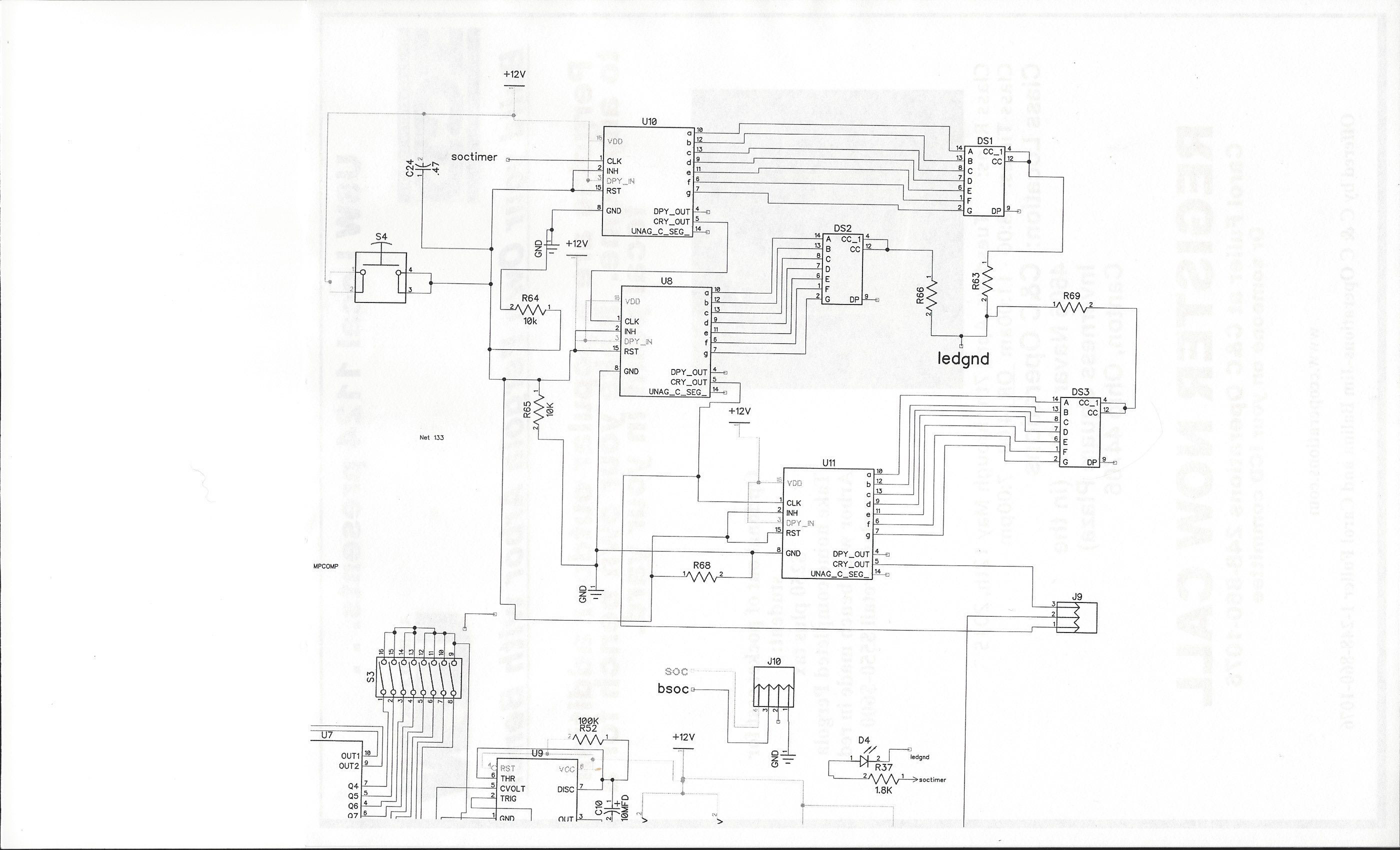

A schematic would help...
the pin that says "LEDGND" goes to a transistor switch that turns off the display to save power.
I think your problem is due to the fact that you also have the reset signal connected to the clock inhibit pin. I think the static state of the clock input to pin 1 of U10 is high which caused the high to low transition on the clock inhibit being seen as a clock signal to the first stage counter. (Incrementing it from 0 to 1.) The clock input on the second stage will be low so the level change on the clock inhibit pin does not cause it to increment. You need to show what provides the clock input to the first stage and give more information about what it is being used for so we can see if you can just invert the clock input signal.

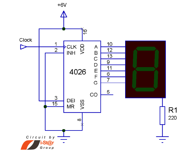

and this one shown is the one that I based my design around. Since all the inhibit pins are connected to the reset line, why does the second counter trip to one and not the others?

les jones is right.
The difference is..... that circuit is not clocking the INH pin. It is connected to ground. In your other circuit, INH is clocked along with the Reset pin.
Instead, connect the INH pin to GND.
Hi Mike,
I misunderstood the question. I thought it was the least significant digit that went to 1. You talk about two digits but you schematic shows three digits. It would be interesting to know how the third digit behaves. I still think the problem is related to the clock inhibit being connected to the reset line. What is the reason for connecting it this way ? I have just had another look at the timing diagrams on the data sheet and I now understand what is happening. In state 0 (The reset state.) the carry out pin is high. This is connected to the clock input of the next stage. This means that the counter now sees the 0 to 1 transition of the clock inhibit as a clock pulse. If you have to have the clock inhibit connected to the reset pin then the only solution I can see is to differentiate the carry out signal before connecting it to the clock input of the next stage. Connect the carry out to the clock of the next stage via a capacitor and connect the clock pin to ground via a resistor. The values will depend on how fast you are clocking the counter. I would try a 1 nF capacitor and a 10 k resistor. (I am assuming you are clocking it at less than a few tens of KHZ.)

les jones is right.
I'm a bit confused..
In my circuit I have the INH and RST going to ground via the 10K pull down.
The View attachment 98732 shows the INH and RST going to ground, without the resistor.
that's the issue? I should have the INH tied to ground, then the RST pins to ground via the 10K. Reset by applying +voltage to the reset pin and they'll be joy.

Hi Mike,
The difference is that reset and clock inhibit are permanently connected to ground so there is no high to low transition on clock inhibit. If you look at the internal schematic of the 4026 (On the data sheet) you will see that the clock signal comes in through a schmitt buffer to an and gate and the clock inhibt comes in via a Schmitt inverter to an inverted input of the and gate. the inverted output of the and gate goes via an inverter to the clock input of the counter. When the clock input is high (As it will be as the carry out from the previous stage is high when it is in state 0 ) and the clock inhibit goes from high to low (When your reset button is released then the output of the and gate and inverters will go from low to high causing the counter to increment. With the resistor and capacitor the clock signal will only go high for a short pulse on the rising edge of the carry out signal.

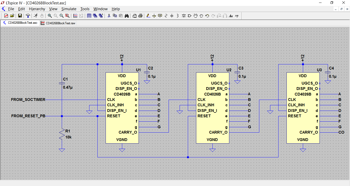

Where can I find the CMOS.lib?
thanks
Hi
If your referring to the CD4026B model, I made a model (its not in the cmos library).
If your referring to the cmos.lib library, you can get it from the LTspice group at yahoo.com.

The problem is not caused by a race condition. If you look at the clock and clock inhibit pins that are both active high (Clock low to high transition.) and swap over the inputs then the clock pin becomes a NOT clock inhibit (I.E. clock enable.) and the clock pin becomes a clock input that triggers on the high to low transition. The carry out signal is high from state 0 to state 4 and low from state 5 to state 9. As in state 0 carry out is high from the previous stage clock is high so the high to low transition of the clock inhibit increments the count when the reset button (Which is also connected to clock inhibit.) is RELEASED. The OP has not yet explained the reason for connecting the clock inhibit inputs with the reset inputs.

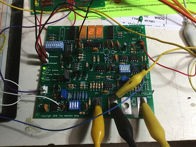

Les, I need to buy you a beer!
I removed the counter chips from the pcb, installed sockets, lifted pin 2 out of the socket. Connected all the pin twos together, then ground.
when I press the reset button, everything now goes to zero.
Thanks a bunch..
