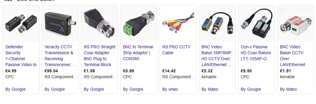

Out of interest is there any difference bewteen these various baluns other than input connectors, seem to vary in price, though all saying Passive type.
This pdf of the simple and cheapest type suggest 10mtrs max distance , yet others up to 450m ?
https://www.farnell.com/datasheets/1965169.pdf

These are the sort of things I used:
Easy to use and work great - I used quite a few of them, along with video amplifier/splitters, to feed multiple monitors at various locations, as well as feeding the cameras. I even used one ethernet cable for sending two cameras down to a DVR, and two vido signals back up the same cable to feed two monitors with pictures from two different DVR's :D
