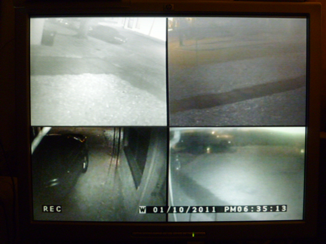

I'm using two of these, **broken link removed** , and they do a good job, day or night. Replaced the lens in one with a wider angle view, get most of the backyard. Not real high resolution, but don't need to read license plate numbers. I can easily spot cats and squirrels, and send the dog out. Might post a picture of what's on my monitor later. Not bad for a cheap $25 camera...
Top left: Driveway Top Right: Sidewalk in front
Bottom Left: Carport Bottom Right: Backyard
Just built in LEDs an streetlights for illumination. The backyard camera is a little out of focus...

I'm surprised it is as good as that , you must have a fair bit of ambient lighting. Still useless for recognition purposes which is the name of the game
Well, I can recognize a car in my driveway, or a cat in the yard, when the dog starts barking, so I don't have to go to a window to see what the fuss is all about. I can recognize which neighbor comes over and steals my free local newspaper... But I don't really need high detail for most things. The daytime images are better detail. Fortunately, I don't live in a high crime area, and just have the cameras out, is deterrent enough. You get what you pay for, but for $25 these aren't completely useless.
