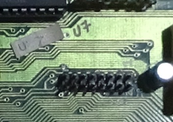

The battery will just be supporting a RTCC chip ( guess ) the Flash memory you call EE possibly has the codes. there will be some method of clearing the password to a default, how else would the factory send out the boards ? . post a picture.
This is the Photos I taken.....

What connects to these pins. are one side of the row all gnd , 0v... looks like a set of option straps.

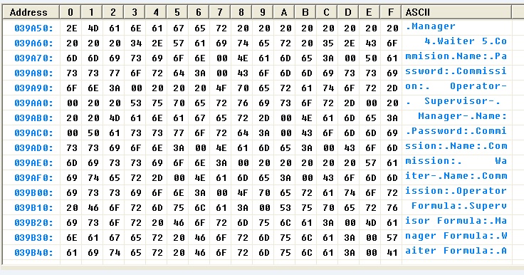

I think there is no Hardware based options. Only with Software... Please check the HEX file, Last section ....
I see where you are coming from , but these look like null terminated message strings , It would not be a good practice to store the passwords amongst them , they would be in another block. from what i see the keyboard does not have alpha A-Z keys, for the password ? have you seen "Formula" on the display.
