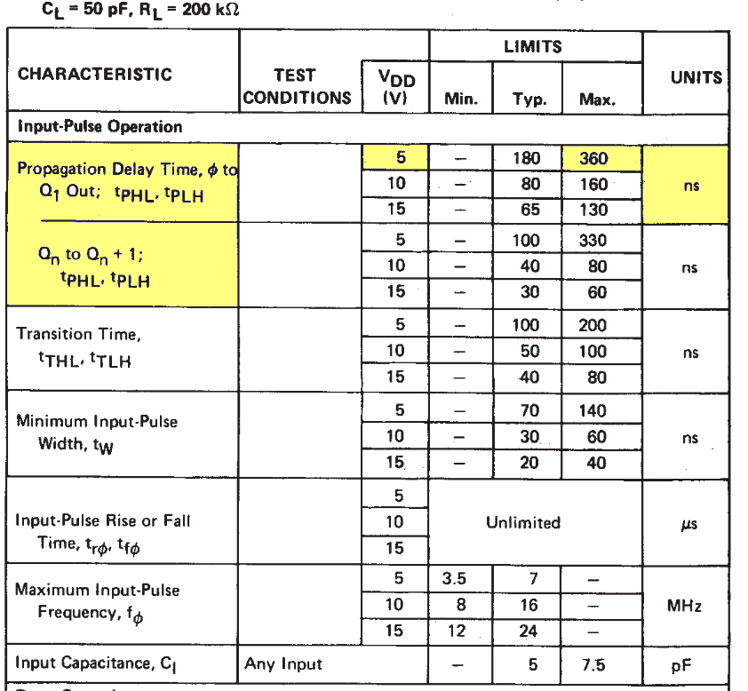

No this is false. You must wait for some predetermined propagation delays in each stage.
This can be made OK but some timing delay conditions.
If you take the 14th single output or Q2 on the 2nd IC, this can work if you slow down the clock.
But only if you use 12th counter output, Q12 as Clk2 in IC2 and Q1 Q2 become Q13, Q14.
Thus after Q14 goes high (some 5us after the clock edge), you must stop the clock process immediately and say "done". (or something like that)
The delay from Q14 going high after CLK1 went low depends on the IC delay. 14 stages each with delay shown below as 360 ns max. @ 5V, 25'C or Tdelay = 5 us. MAX.
This means your clock cannot go high for 5us before you stop the input clock count.
1. you must use the negative clk edge to latch the data into the Arduino ( or invert and use rising edge),
2. you must reduce the clock speed to a 10 us cycle or 100 kHz and both Arduino and 4040 clock on the same edge or something similar to prevent the race or metastable glitch and thus prevent memory transfer errors latch the data into the Arduino one < 180 ns so the Memory state stays the same from the previous edge and the memory is latched immediately in the Arduino.

Thnx for the thorough explanation! I understand the concept and the delays when it regards an asynchronous counter like the 4040, but with all kinds of delays, I'm sure I'll be able to read valid data. I don't even mind waiting 500ms between every byte that needs to be read. Indeed it is a one time only solution.

If using 3.3V on CD4040, then RdsOn increases sharply with prop. delay so choose > 10us read delay after each -ve clk pulse.
