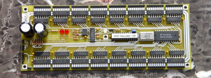

Assuming Midi can only control 128 devices, it's because it's only using 7 addressing bits (a single byte, less 1 bit) - by increasing the addressing to use two bytes you then get 65,000 odd addressable devices. Bear in mind, for your purposes it doesn't have to be as fast as Midi - so increasing the packet size won't be a problem!.

i also like your idea of that midi decoders....if nigel could help us to make our way to it...that would be good...=)

quick comment would be not to use MIDI for the control of pyro's / fireworks. There is no EDAC (Error detection and correction), and no real way to make sure that if you send the message "fire channel 10" that that is what is received, we wouldn't want 11 going off by mistake now would we. I'm currently working on a pyro controller for my final year project at uni using a different protocol, the aim being to make it more stable, and less chance of errors.
There is also MSC (Midi Show Control) which does have the fire commands and such set out in it, but again I would never use it for a safety critical system.
