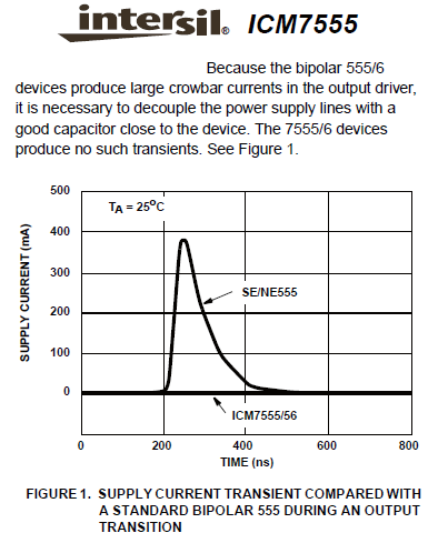

You appear to have a complete lack of power supply decoupling, which is essential in any circuit, and particularly so with 555 circuits, as they cause large current spikes (the CMOS ones are better in this regard).
Intersil, Texas Instruments and a few other companies make the Cmos 555. Intersil's datasheet shows that the old fashioned ordinary 555 draws 400mA(!) from its power supply each time the output switches. You should use the Cmos 555 because it is much better without the problems of the old one.

I am using a CMOS 555 (7555) as per the photo. I did also have a large 1000uF decoupling capacitor as per the holes in the board in the photo, which did not help (but not a small ceramic one for higher frequencies), however that is likely immaterial.
