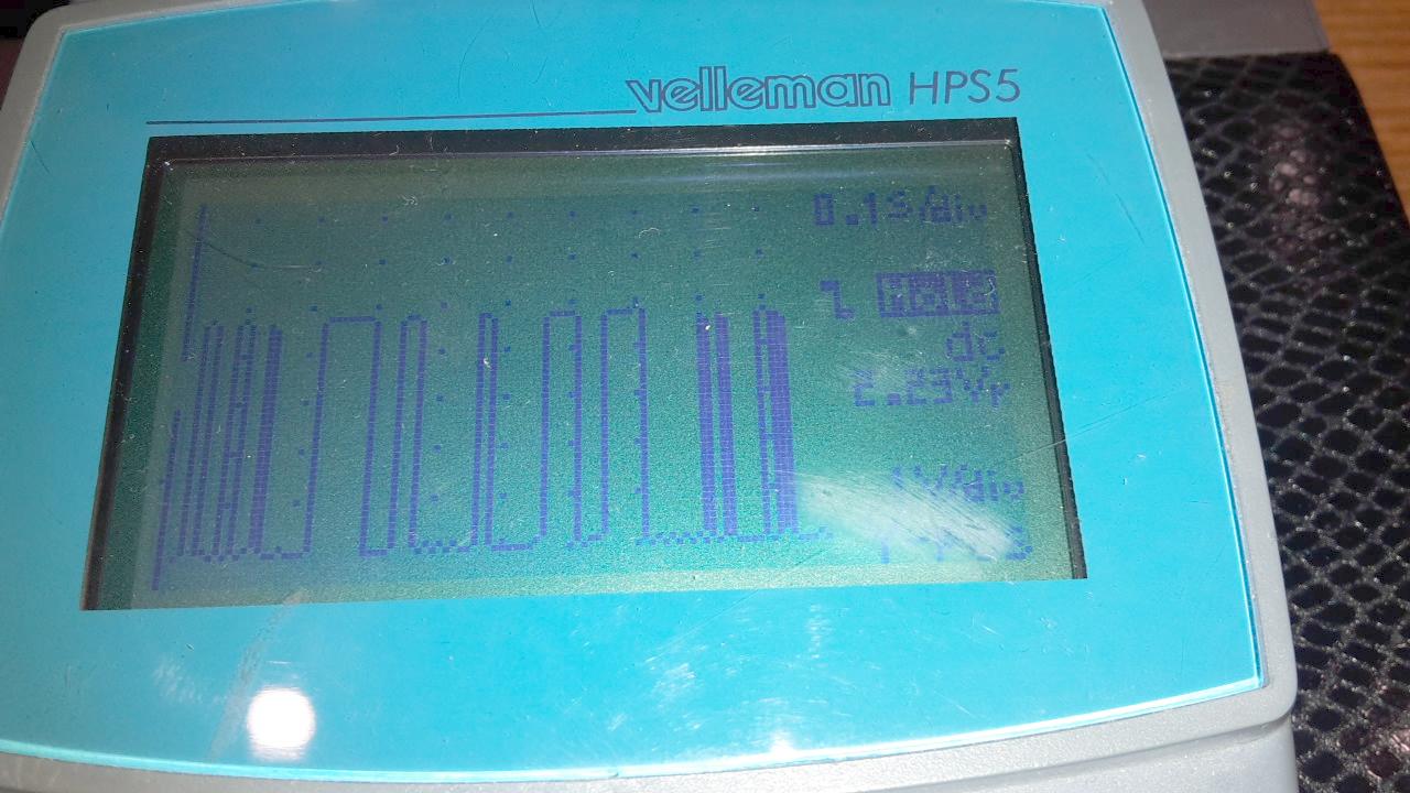

Attached is a shot of the scope reading of the module output with a sustained loud scream. The longest pulse is about 80ms. (Note the scale is 0.1s per div horizontal and 1V per div vertical.) (I obviously connected the probes backwards. The output pin sits at 5v and drops to 0v when activated.)

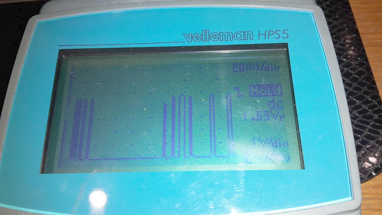

I want to activate it using normal voice. WIth that the pulses are very short. See nextimage. The longest pulse is about 6ms. (Note the horizontal scale is 20ms per div for that one).

What is a "continuous loud sound". Banging on the table a lot is not a continuous sound because you bang slowly and electronics are very fast. A continuous sound would be a like a tone. And how fast is "rapid"?
Go to a website that generates tones and play that into your module and see how it reacts.

Try a tone anyways. If the board is the schematic you say it is, it's because it's running a unipolar comparison operation on a bipolar AC signal. It should be plainly visible if that's what is happening if you use a sinusoidal test tone. If that's the case, any sound, continuous or not will never have a a continuous output.
