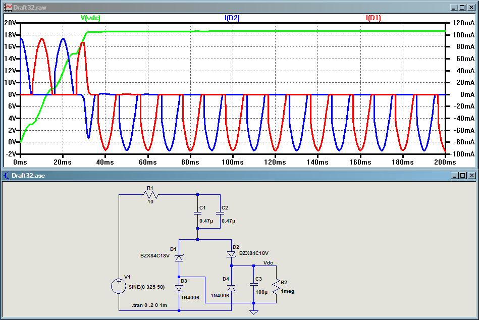

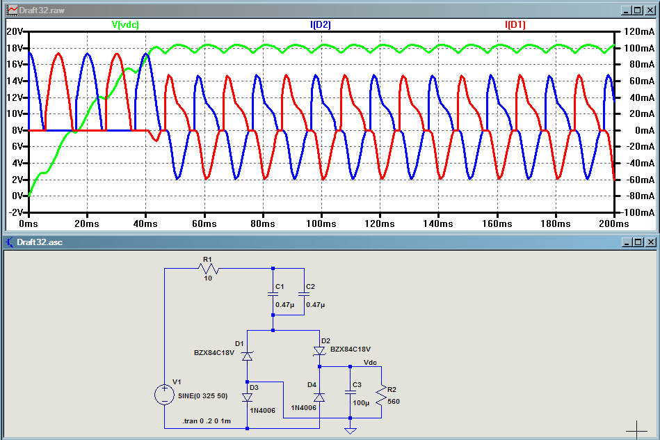

Look at these 2 sims, one with 560R and the other with 1 meg as load.
Note the Izener currents.

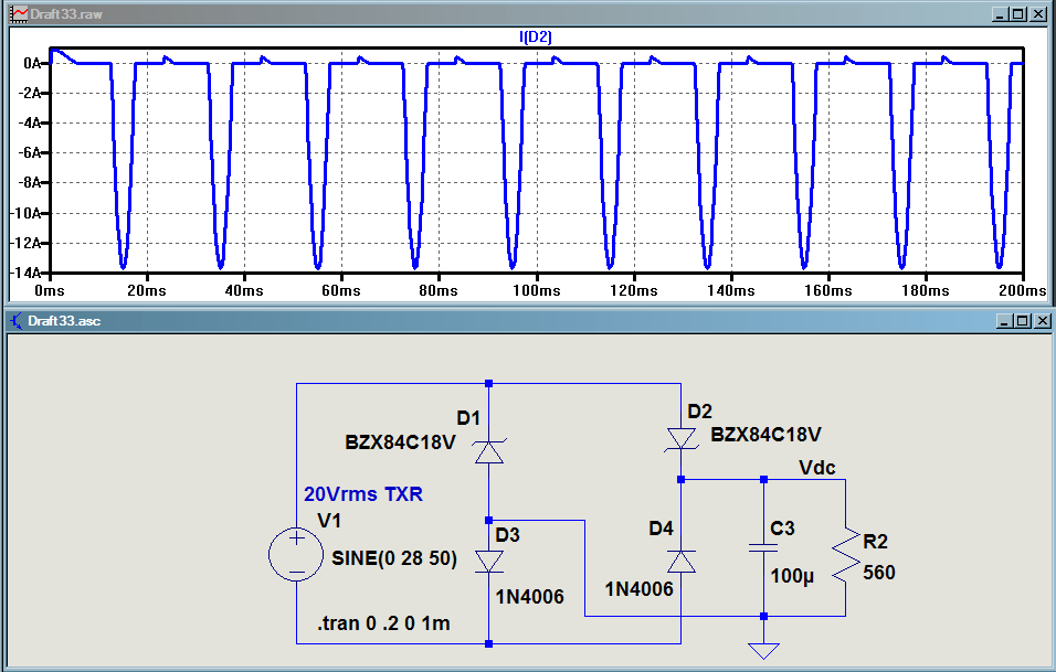

hi karkas,
To demonstrate the point 'brownout' was making about a transformer driven rectifier bridge, look at this image.:eek:
Its not suitable for a transformer source.:)

Thanks for the answer Ericgibbs, but i see that the current is divided in the same amount for the two zener diodes, for the forward biased and the reverse biased in every half-cycle, but what i don't understand is the difference in the waveforms,
in the first image:
those waveforms shouldn't be for D3 and D4? i mean that's the usual waveform that you get when you make the measure for those diodes.
in the second image:
I can see that the current takes positive and negative values because the zener allows it to flow in both directions, but shouldn't the voltage be constant at 18 V, when the corrent is positive through it?
And about the transformer driven rectifier, i'm sorry i don't understand.
Could you explain?
