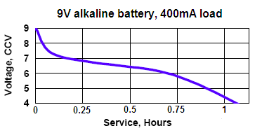

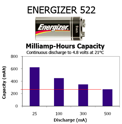

If your wall adapter outputs 0.5A @ 9V, then a 9V battery connected with the proper polarity to the input power connection of the ADSL modem will work just fine.
No.
The adapter has a 9V AC output. The peak voltage is 12.7V and the rectifier bridge reduces it to 11.3V which is the DC inside the modem. We don't know if the modem makes a negative supply from the AC in addition to the positive supply.
The modem uses 1A, not 0.5A.
Now, you want to know how long the battery will last. Well, becuase batteries are rated in milliamp hours and they have a much larger error tolerance, batteries can only be said to be reliable for 70% of their rated life minimum.
So, typical 9V batteries are rated at ~700mAH, dispite what the gentlemen earlier said. if you don't believe me, check the technical specs from energizer and duracell.
So the equation is (current of the battery / current being drained)*0.7 = (700mAH/500mA)*0.7 = 0.98 hours.
No.
The Energizer 9V alkaline battery has a capacity of 625mAh when its output voltage has dropped to 4.8V and the current is only 25mA. The capacity is only 275mAh at 500mA and much less at 1A.
A 9V alkaline battery has a pretty high internal resistance so it will not have 9V at 500mA and its voltage drops very quickly. The voltage will be at 7V in a few minutes.
