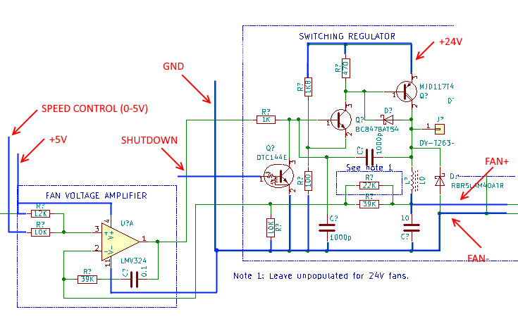

I am implementing a simple design for a project of mine that solves just that problem. It can be assembled with readily available parts and seems to work a treat. Simulated efficiency is around 90%.
