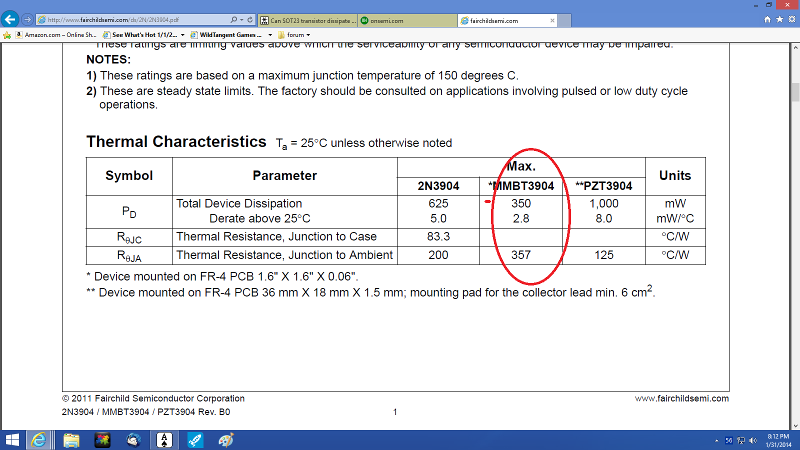

All I have on the sot23 is a figure of 263 degC per watt, from a load of vaguely written app notes...ive no idea if they are right or not, or what they mean by "standard footprint"......does that mean absolute minimum pad sizes?....who knows?
If you referring to my reference in post #13 it doesn't seem vague to me... it knows. It states the exact board type and land pattern (pad size) used to determined the thermal resistance values.
yes, thanks, I saw that..... by the graph it says at 70degC, it is allowing power dissipation of about 230mW in the SOT23-3.......that is very odd, since an 0805 resistor, which has twice the footprint pad contact area of a sot23-3 , is only rated to 125mW at 70degC.
My small "engineering sense" just tells me that the package with the bigger contact area should have the higher power dissipation capability.
Maybe surface area plays a part.
https://www.fairchildsemi.com/ds/2N/2N3904.pdf
..thanks, I looked at that datasheet, and the sot23-3 is being said to have better power capability than the to92 version, which doesn't make sense, surely?
..also, it really is not clear that that sot23 is on minimum pads, or if the pads are part of copper lands the full size of the 1.6" x 1.6" pcb that it speaks of....this is typical, the datasheets just leave us up in the air.
I don't understand your comment. That data sheet states that the power rating of the TO-92 is 625mW and the SOT-23 is
350mW...
