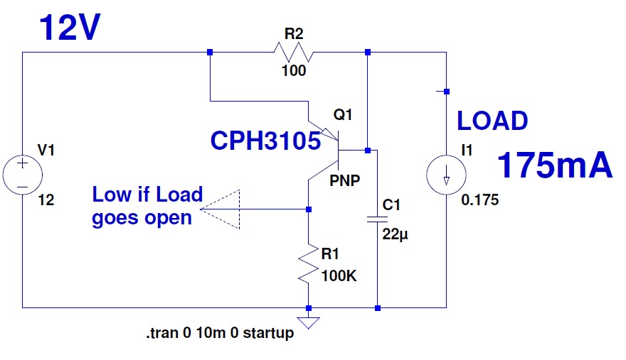

Can SOT23 transistor dissipate 175mW when on minimal size pads on the PCB?
Flyback
Hello,
Is the following PNP transistor going to overheat in this circuit (attached)?
The PNP transistor is put there so as to provide a low output on its collector if the load ever goes open.
However, the PNP is just a CPH3105 type, and is in a SOT23 package, and is on a minimal footprint on the PCB, with no cooling copper added to any of its pads.
This PNP is dissipating 175mW (Ieb * Veb)
CPH3105 PNP transistor datasheet:
https://www.onsemi.com/pub_link/Collateral/EN6084-D.PDF

The specs only relate to the setup where the pnp is on a 600 mm^2 substrate, so it's difficult to say.
Can you reduce the value of R2 to, say, 5 Ohm? That still allows switching but drastically reduces the pnp power consumption.
Most are rated at 350 mw on FR4. But if you want to be sure you should buy one with a spec for your board.
I agree that he datasheet does not give sufficient information the determine if the transistor will become too hot.

Looking again at your circuit, if the load is 175mA, do you really want R2 to be 100 Ohm?
175mW is right. Nearly all the 175mA load goes through the base-emitter junction, which drops nearly 1V (according to LTspice).
Page 2 of the CPH3105 datasheet says that Vbe(sat) is from 0.88V to 1.2V....so I am not sure where you are getting 0.7V from?
Also, the load is drawing 175mA...so I cannot understand where you are getting 250mA from? Have I missed something here?
Yes, I agree.
But, why not use a lower value resistor?
Does the transistor need to be thrashed so hard?
Page 3 of the below says its 336degC/Watt for a SOT23 on a 2 layer board (this board is 2 layer).
So 350mW would give a temperature rise of 0.35 * 336 = 117degC, which is surely way too much temperature rise.

..also please note, that this SOT23 (CPH3105) is mounted on a minimal footprint, with no extra cooling copper attached to any of its pads.
Just a quick assumption from the average silicon transistor.
My point is, why are you thrashing the transistor with such a large base current?
I know what you are saying, but may I ask, "why" do you believe the transistor is being thrashed hard, when its datasheet says its Base current can be up to 600mA?
I am not sure why the designer made it 100R (its an 0603 package)....but this circuit has gone out in small volumes and is now in cars.....we have to decide if the CPH3105 will overheat.
(by the way, the actual load is a LDU0830S350 SMPS LED driver , driving two leds at 350mA....hence its input current from 12Vin, is 175mA, as shown)

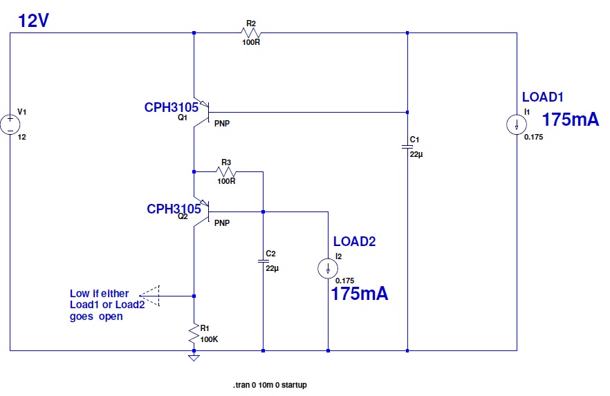

...By the way, the full circuit is actually as below, two of the PNP's, one for each load....its right and left fog lights or reverse lights.....if either load goes open, the collector of Q2 goes low , indicating the fault.

I actually believe that the operation of this PNP transistor, with Ib a lot greater than Ic, is a weird operation, and probably none of the datasheet parameters apply..do you agree?
I don't think any single engineer can be expected to understand PNP operation when its hooked up in such a weird way.....I didn't think power current was supposed to go through the BE diode?....I thought the BE diode was for small control current only?.....I suspect that the datasheet value of 600mA for the BE current refers only to a short transient current of 600mA? (since the CPH3105 datasheet does say its for 'switching' operation)...maybe they are thinking the CPH3105 would normally be used to turn a mosfet ON , and the 600mA would only flow at turn ON time...for a short interval...who knows?, the datasheet doesn't really say.
I'll own up now and say I have never before seen a BJT being used with the power current going through the BE junction...i thought BE junctions were delicate little blossoms that we should be careful with?
According the this, the free air thermal resistance of a is SOT23-3 is 400°C/W and 263°C/W when mounted with a standard land pattern on a glass epoxy board. This means you could dissipate 175mW up to an ambient temperature of 150°C - (.175 * 400) = 80°C in free air so, even without the added power dissipation from the board mounting, you should be fine.
My interpretation is that the base-emitter junction can carry 600mA continuously since it does not say pulse.
The use of the transistor in this manner is not typical but it makes sense for the purpose of detecting whether the load is drawing current or not. It's a simple and effective circuit.

What they expect and what they state are two different things. I go by what they state.
This is a small power transistor which can carry 3A of collector current so the base-emitter junction is apparently quite rugged.
If you want to use 100°C for reliability, that's okay. If you crank through the numbers you should still be fine at 175mW. (I'll leave that calculation as an exercise for the reader ;)).
Maximum Internal ambient (inside lamp enclosure) is 70degC.......then 0.175* 263 = 46 degrees......meaning that he junction will be at 116 degrees...this is surely too high?

If I understand correctly, the load of 175mA is the normal load for this circuit, so the transistor is dissipating 175mW in B-E junction in normal operation.
What we have not been told is the condition which this transistor has to detect.
I assume that it detects no load, ie 0mA.
If that is the case, I think that replacing the 100R resistor with 10R would considerable reduce the transistor dissipation, so ending the debate as to whether it gets too hot.
However, this will increase the dissipation in the resistor. What is the power rating of the resistor?
Maybe a compromise is needed between power in the resistor and power in the transistor.
