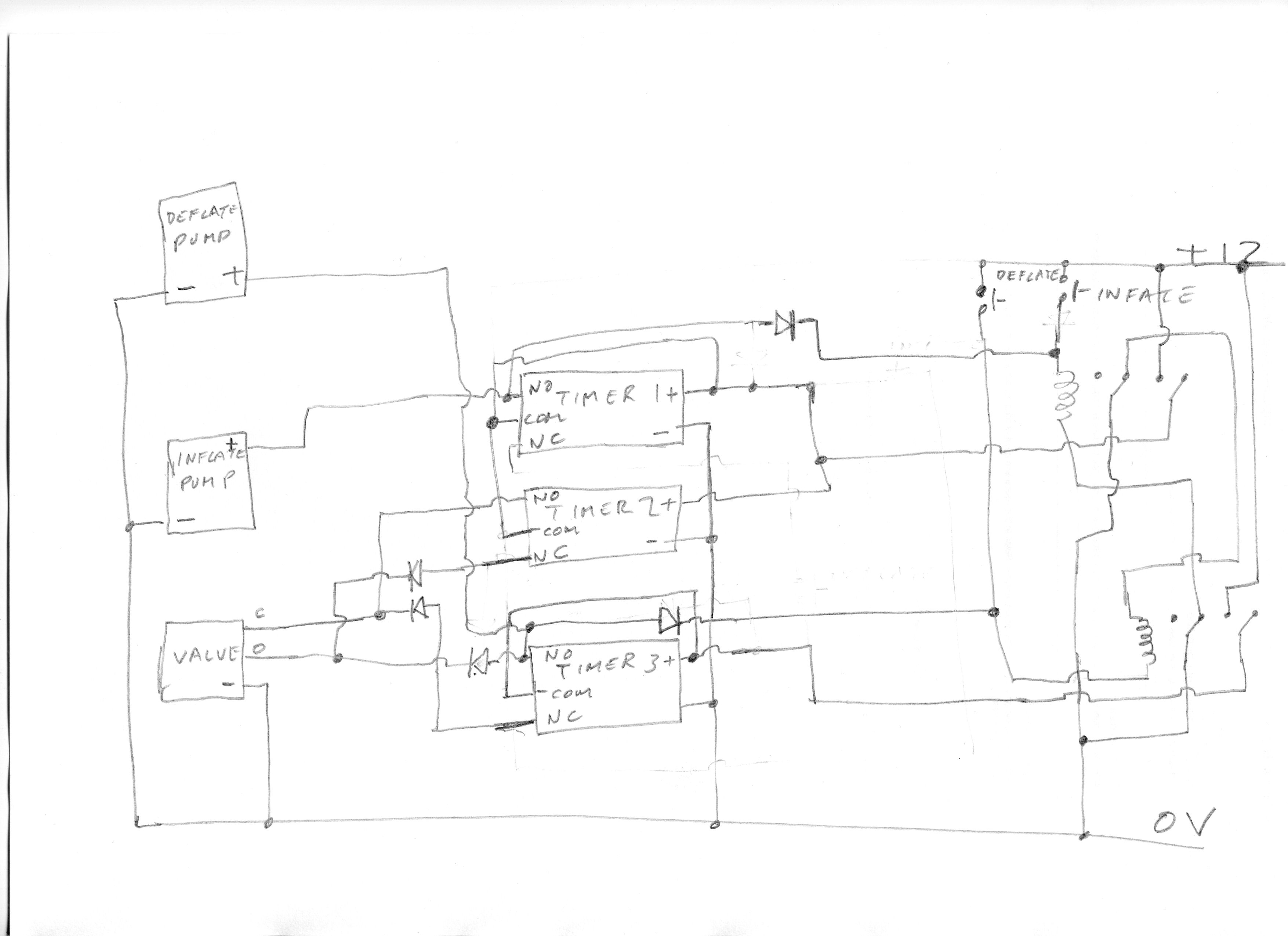

I think this circuit should do what you want.
You will need 2 double pole double throw relays with 12 volt coils and contacts with a current rating suitable for the current drawn by the pumps. (Only one pump will be running at a time.) You may need the timer functions setting to function 1 for timer 1 and function 2 for timers 2 & 3

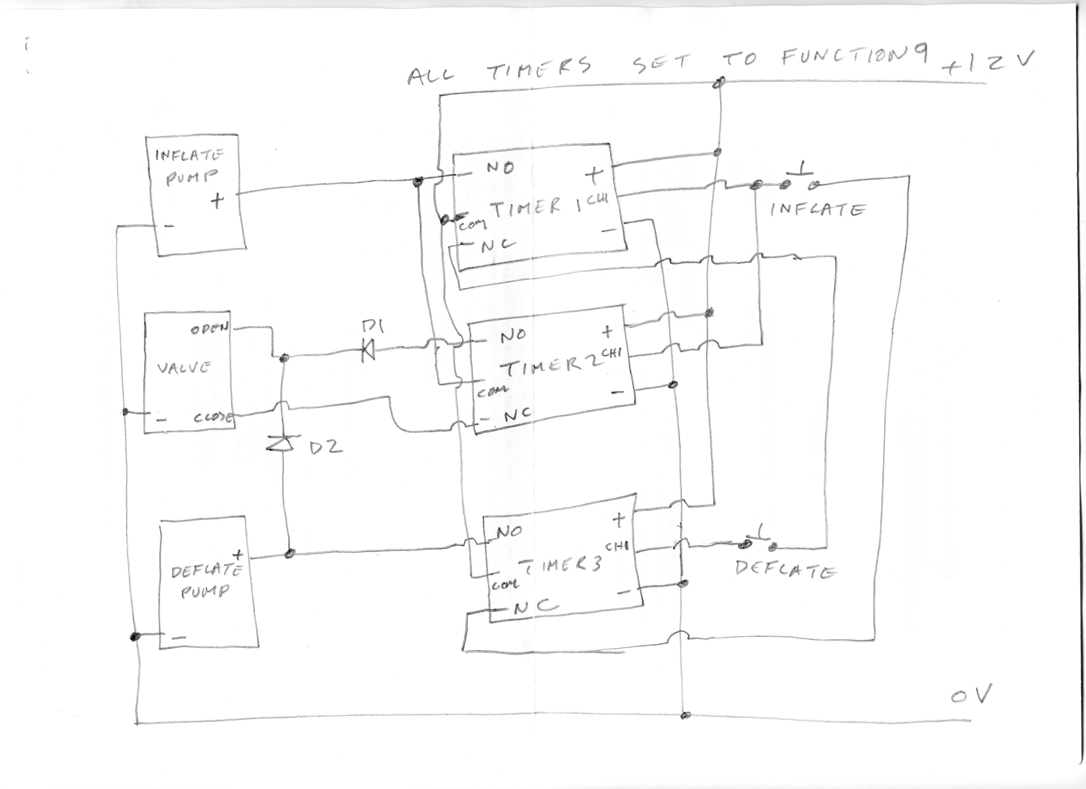

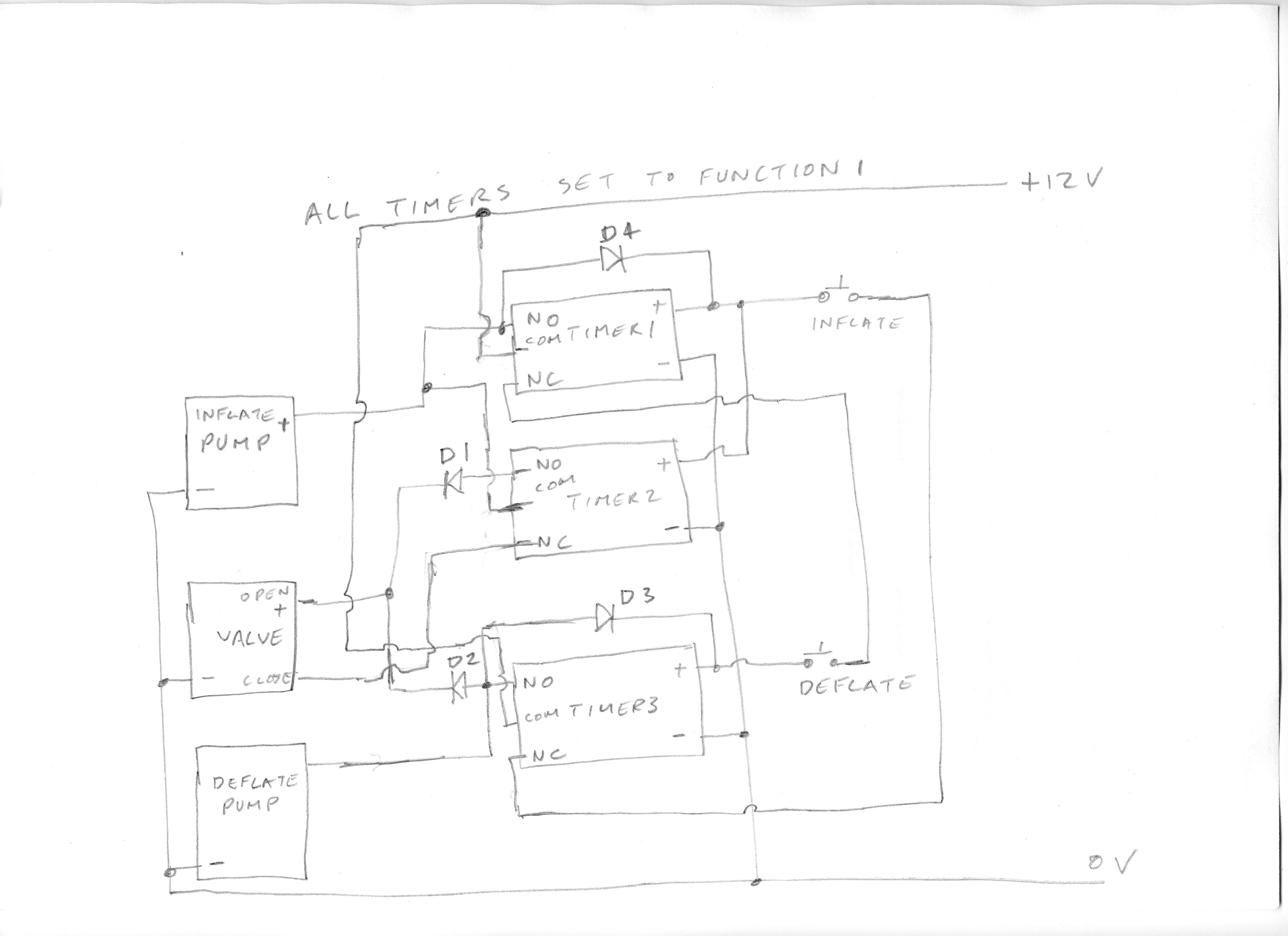

Here are two possible solutions that seem to fit the requirements. (If my understanding is correct which it may not be as I do not understand the choice of timer functions 7 & 8)
This uses the original trigger method of applying power to the timers. All timers set to function 1
D3 and D4 could be omitted if the push buttons can handle the current taken by the pumps.
This uses the CH1 input to trigger the timers. All timers set to function 9
After designing these two circuits I realised that there is a small problem (With both circuits.) If the inflate button is pressed after timer 2 has timed out and before timer 1 has timed out timer 2 would be re triggered. This could be eliminated with a small relay activated by timer 1 with a set of contacts (NC) in series with the inflate button.

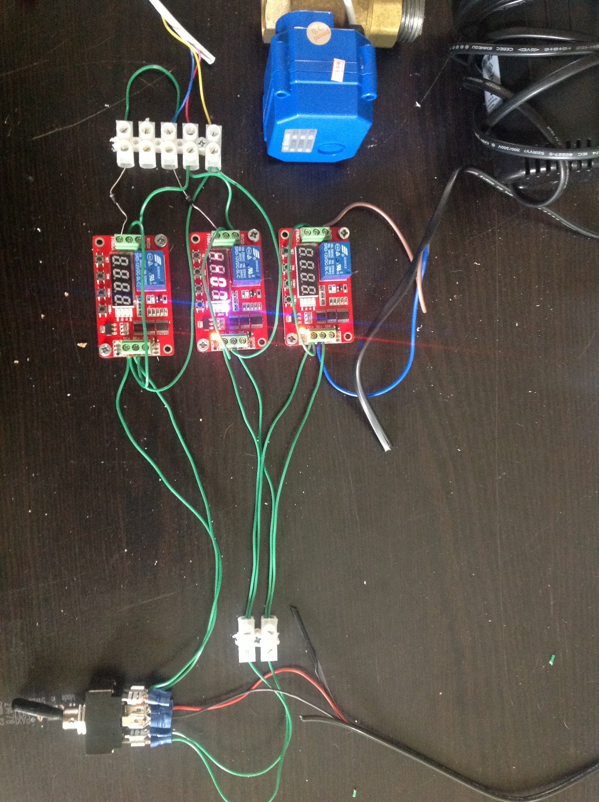

Hi Les, sorry for the late reply but I've been away all weekend..thanks again for all your help. Here's the info you requested and I've taken a pic of the set up if this helps any -
Timer 1 - T1 10seconds - T2 1second - nx setting 1
Timer 2 - T1 0.1 seconds - T2 7 seconds - nx setting 1
Timer 3 - T1 0.1 seconds - T2 9 seconds - nx setting 1

After looking at the small problem I described in post 32 I realised that it would only occur in the version that uses the CH1 inputs. (The second diagram.) Will either of these solutions do or do you need it to works with the current way the timers are set ?

The way timer 1 is configured for function 8 does not fit in with my understanding of how the inflate function should work. (this is from your original diagram.) This is the sequence of events as I understood them. You set the switch to inflate. Timer 1 starts its timing of about 11 second and sets the NO contact high which starts the pump. timer 2 also starts is timing and drives the valve into the open position which causes the item to be inflated. Timer 2 then switches off causing the valve to close. Timer 2 continues to drive the pump for another few seconds until the vale is closed. (So the air can not escape through the valve before it is fully closed. The way timer 1 is configured when you set the switch to inflate there is a 10 second delay and then the pump starts and runs for 1 second. If T1 and T2 were the other way round it would make sense as it would not matter if the pump delayed starting for 1 second while the valve opened. This all assumes that the timer in the Youtube is exactly the same as yours. If you do need the 10 second delay before the pump starts then neither of the two diagrams in post 32 will work as they rely on the NO contact on timer 1 to close almost as soon as the inflate button is pressed so that power is supplied to the timer (Via the NO contact.) until it switches back to the NC contact. The 0.1 second delay on timer 3 would just mean that the deflate button would have to be pressed for at least 0.1 of a second. (It would probably be pressed for longer than that anyway.) Have another look at the Youtube description of function 8 to see if it ties up with the way your timer behaves.
