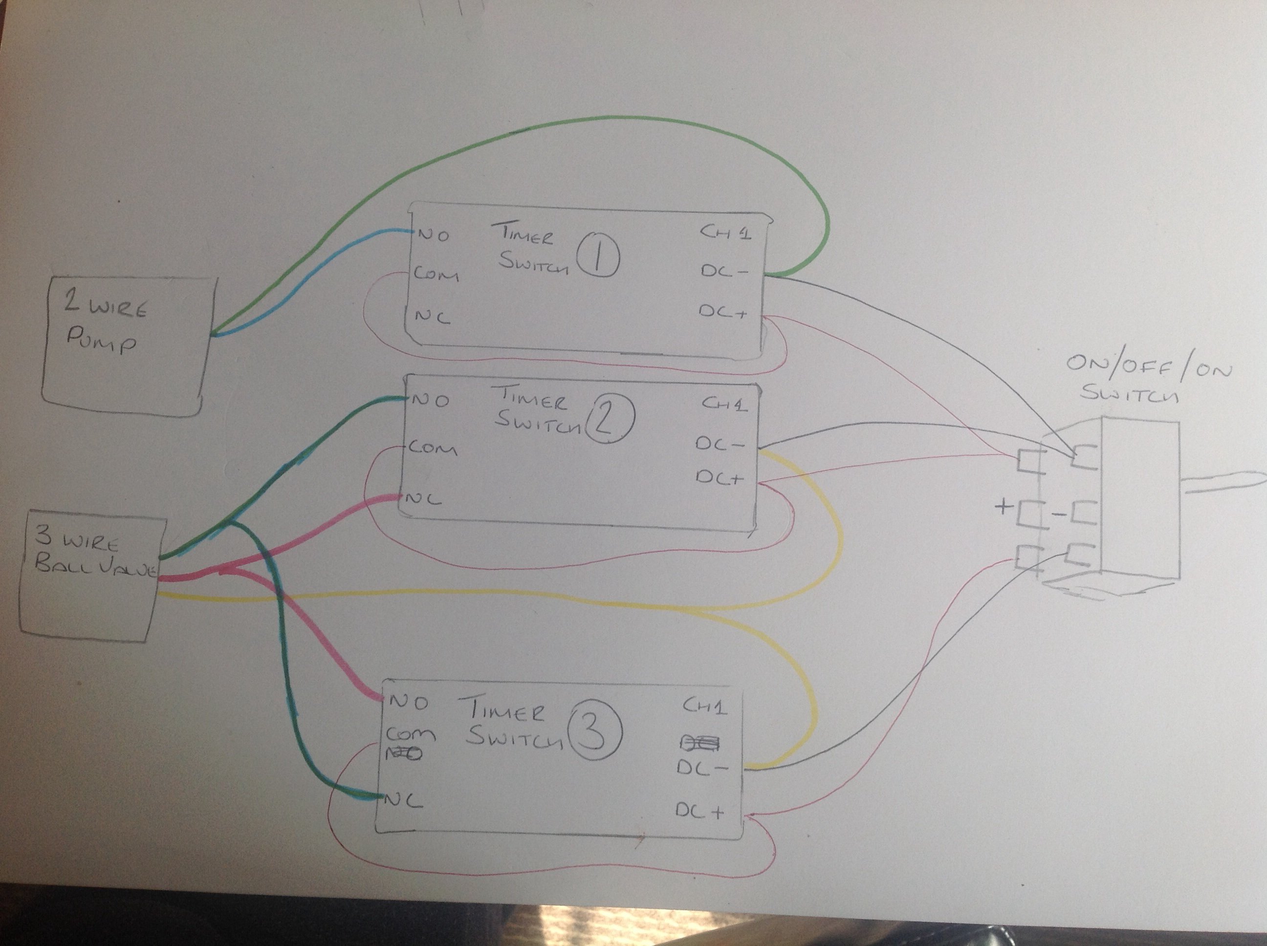

I have a 12v electric ball valve (3 wire) and a 12v 2 wire inflation pump which I am using for a project. I need the ball valve to open then close after 10 seconds and the inflation pump to run for 12 seconds simultaneously. I have managed to achieve this using 2x12v timer switches which I purchased off ebay (link below) . The problem is I need a second button/switch to press that will deflate by opening the ball valve then close it 20 seconds after, I thought this would be achievable by introducing a third timer switch and a simple on/off/on switch, I wired the first two timer switches to the first 'on' then the single timer switch to the second switch but they all seem to interfere with each other and when I want to power the single one they all light up.
Hope someone can please help as I haven't got a clue when it comes to electrics or anything for that matter.

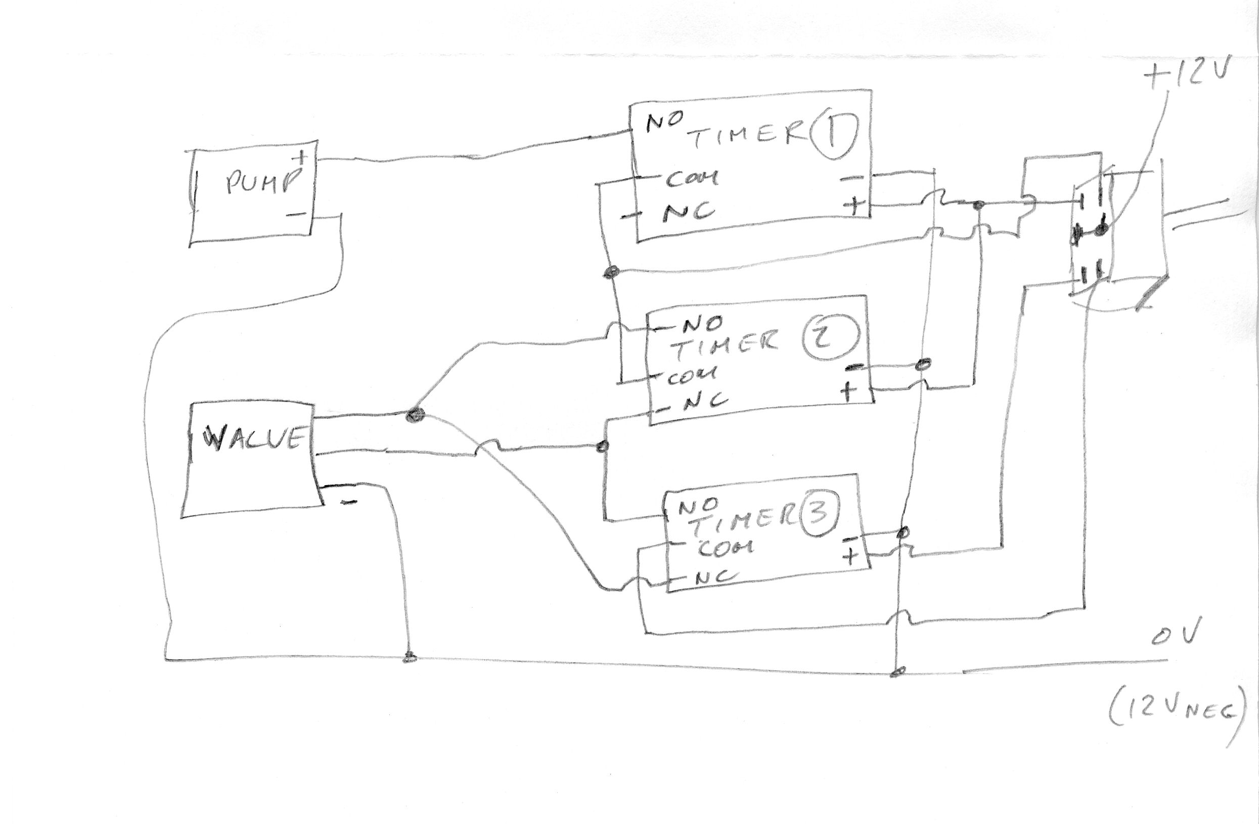

Please post a wiring diagram as it is wired now. You can draw it with pencil, and post a close-up photo of the diagram...

Try adding 4 diodes of suitable current rating. One between timer 2 NO contact and the valve. One between timer 2 NC contact and the valve. One between timer 3 NO contact and the valve. One between timer 3 NC contact and the valve. The cathodes to the valve and the anodes to the timers.
Edit I think just the two diodes from the NC contacts would solve the problem.

This is why I believe you need the diodes. When the switch is in the position using timer 1 & 2 and timer 2 is in the state with common (+12V) routed to the NO contact this will put +12 volts on the NC contact of timer 3 as it is connected to the same point. As timer 3 is not powered its NC contact will be routed to its common connection which is connected back to its + 12 volt input. As a result timer 3 will start. The same sort of thing will happen when the switch is in timer 3 position. Putting diodes between the NC timer outputs and the valve should prevent this back feed happening. The diodes only need to be rated for the current taken by the valve. (The cathode of the diodes is the end marked with a band.)

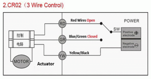

Does your valve match this picture?
The way you have wired it, the valve and the deflate timer must remain powered for ever (the sequence is not self-completing; you have to turn the thing off by centering the toggle switch). Is this ok? Is the long-term power drain a problem?
Timer_01.jpg Here is another possible solution. It only uses the switch for switching the +12 volts. The negative is connected to the timers, valve and pump all of the time. The switch now switches the power to the timers with one pole and the common of the timer output relays with the other pole. By doing it this way the unused timers so not have a path from relay common to the timer power input.
Mike- yeah that's the valve configuration. As far as the power goes I'd ideally like to have to work how you suggested, is that possible? It would be perfect to just have a inflate and deflate button/toggle/switch.
