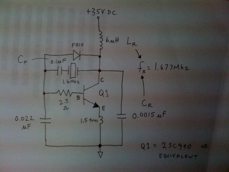

ignoring everything in the middle and right since thats just a water level sensor and mains transformer, i want to understand how this works, i will try to construct this and run it with 1.7MHz piezo .
so far ive only learned the basics of RCL circuits and have only really worked with mathematical models.
2 things i need to know about this circuit are, 1: what specifications does a NPN power transistor require to run correctly in this and 2: are the inductors there for voltage amplification or purely to tune the circuit? this relates to, how neccesary the 63v is, id like to keep the voltage as low as i can.

Looks like everything to the right of R3 is the ultrasonic bit.
L3 and C3 form a filter to make sure the xtal vibrates at its fundamental frequency not a harmonic.
L1 & L2 look like part of a hartly oscillator circuit.
I'm not sure what D7 does, at this frequency a 1N series isnt going to switch, maybe its to bias the trans.
Transistor selection is critical, gain will be imprtant to ensure oscillation starts, and stand off voltage too, is there any reason you cannot use a Bu406?
It doesn't even look like a piezo driver circuit to me. Since the piezo is connected to the transistor base I wouldn't expect much current through it. I think the piezo is just a frequency-determining element. The main current path is through L1 and L2. My guess is that L2 is being driven by the circuit.
Yes could be right.
I notice the 'xtal' in the schematic is marked TD, not sure what that means.
The pic part '2' depicts a box connected to what appears to be the piezo, I wonder if L2 is a transformer primary.

and it was for a humidifier, not a cleaning tank. the principal is the same, a piezo transducer running at a very high frequency in contact with a liquid. there are a bunch of circuits for these piezo drivers, and some of them look like they shouldn't work, but they do work even if the circuit isn't what you would expect. here's one from that thread that seems similar to the one above (only the oscillator portion) :
No good reason no, i just didnt want to have to go out and buy it considering how many salvaged transistors i have, was hoping i had one that was close enough of whatever specs matter for it to work. If i didnt want to use this one, what specs would it need? or does it have to be highly specific? like a combination of gain, base voltage or current or whatever and other stuff?
Gain, Ft & voltage will be the important ones.
