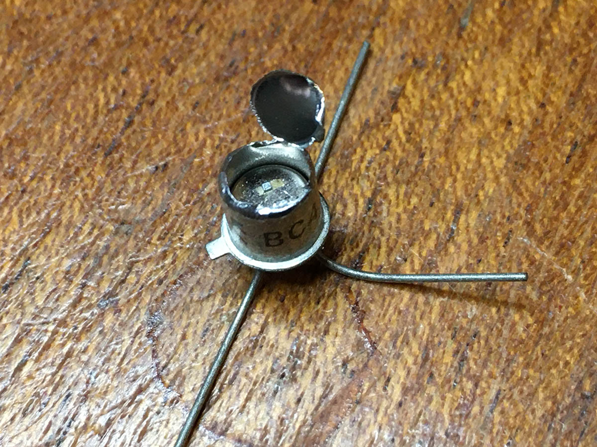

Just tried it out of curiosity - a BC477 from my misc semiconductors box, RS branded.
It works, no "goo" to clean and a very obvious switch-on effect when exposed to moderately bright light (changing from no reading to 60K on my meter). It would probably need to feed the base of another transistor to function as a serious switch, but definitely a functional phototransistor.

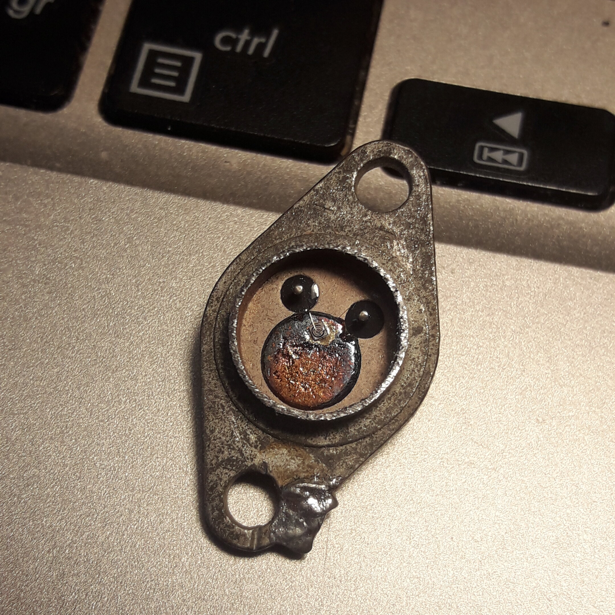

You can pop the case on a TO-3 package with a vise. Squeeze near the solid end. I remember doing the photo-transistor thing with a HeNe laser.
I just gave that a try, there's a type that I have about 200 of that are NPN and the right current rating for his kit. It popped and exposed the die, but in this case it didn't work anymore. I probably cracked it. But with them being worth a few cents each I can afford to give it a few tries.

May I just say I absolutely love the 'hinged' top :D
