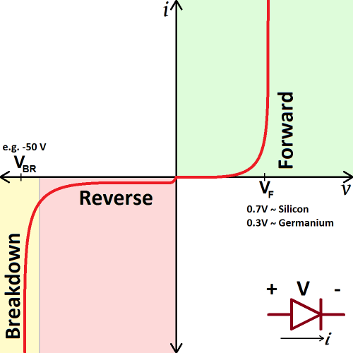

You use a diode anywhere you want current to flow in only one direction.
They allow (conventional) current to flow from anode to cathode (direction of the diode arrow on a schematic) and block (not just help prevent) current flow in the opposite direction (see typical diode plot below).
(Note that the forward and reverse voltage display is not to the same scale).
They are used to rectify AC current to DC, block the accidental reverse connection of power to a circuit, suppress the inductive transient of an inductor, etc.
