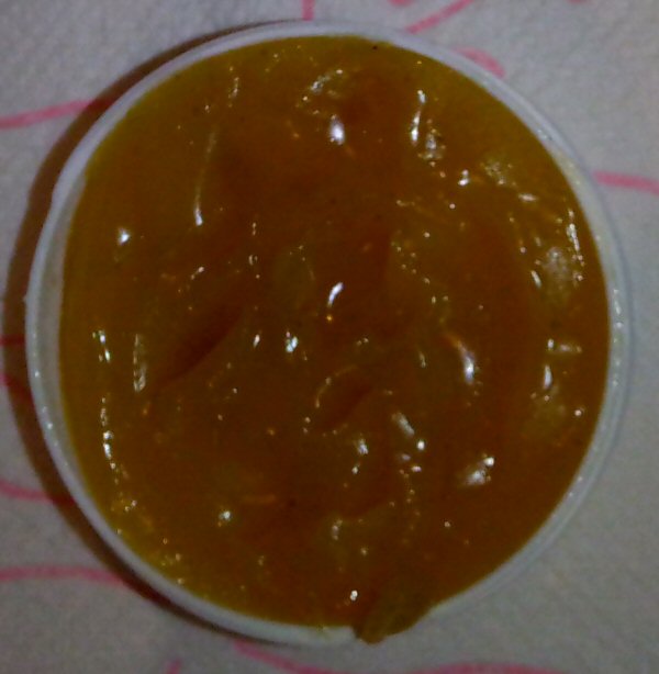

Can I use this flux for soldering?
starLED

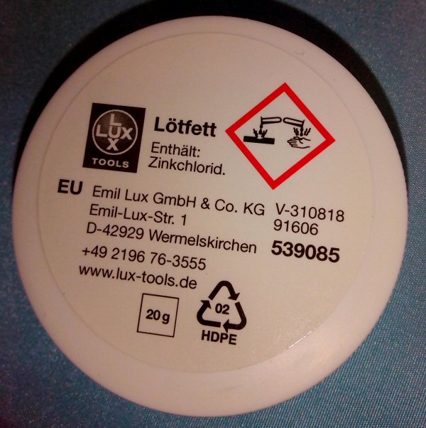

Can I use this flux for soldering SMD components?
You could, but it would be a very bad idea.
That flux contains Zinc Chloride which is corrosive and not for use on electronic equipment.

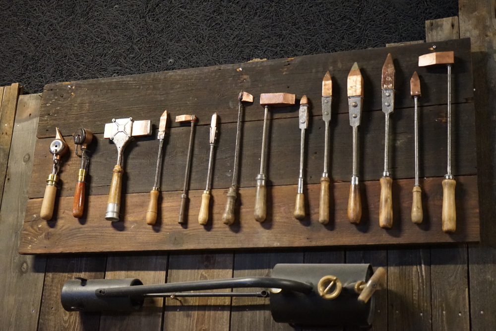

You would use that flux for joining big lumps of metal, using a soldering iron like one of these:

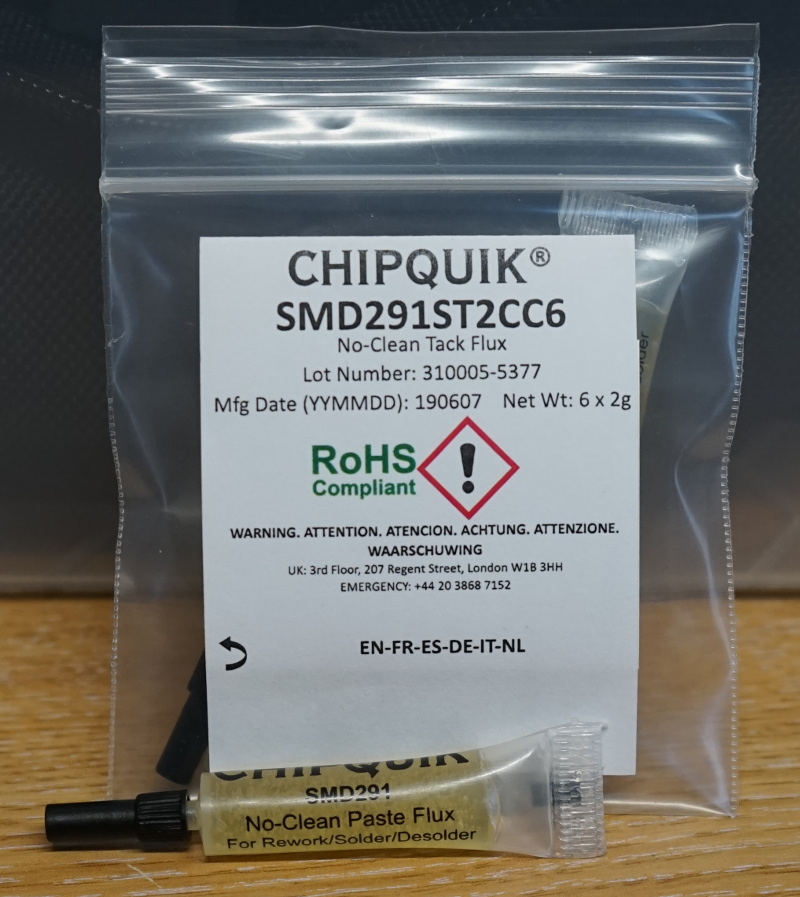

For the times when I am soldering something which needs a little extra flux to help the joint make correctly, I use this:
To give you an idea of the scale, the tube shown above is 65mm long.

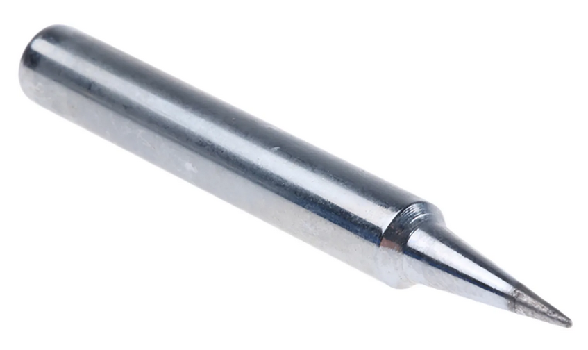

This is the sort of bit you might be looking at for simple SM work?

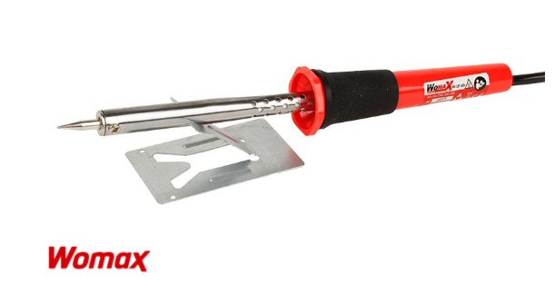

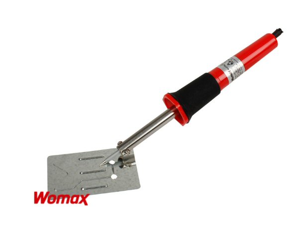

I made a mistake using 60W iron.
I used this WOMAX W-LP 60
I also have WOMAX W-LP 30W, I should've used this one:
I have ZD99 for like 6 years... Still with factory tip... Still works. Its skill demanded job.
I used to repair through hole joints and wires, I should've practice SMD soldering before making a Chernobyl out of PCB board.
Of course you will destroy it. Its learning process.
when i worked for a prototyping/test fixture company, we actually did use ZnCl for a set of test jigs we made for Raytheon. all of the terminals on the test jig were silver plated, and the specification was to use silver solder with ZnCl flux. ALL of the flux was then removed, the organic material with TCE, and any salt residue with hot water. if you ever run into the ceramic terminal strips with silver plated onto the ceramic, silver solder and ZnCl flux is used on those as well... again a good solvent (alcohol is more common these days) and hot water to remove any salt residue (there is a US Air Force Technical Order describing all types of soldering in use, with prescribed techniques for each, and this TO is used by the other 3 services as well). it's use is rare in electronics, but not nonexistent.
