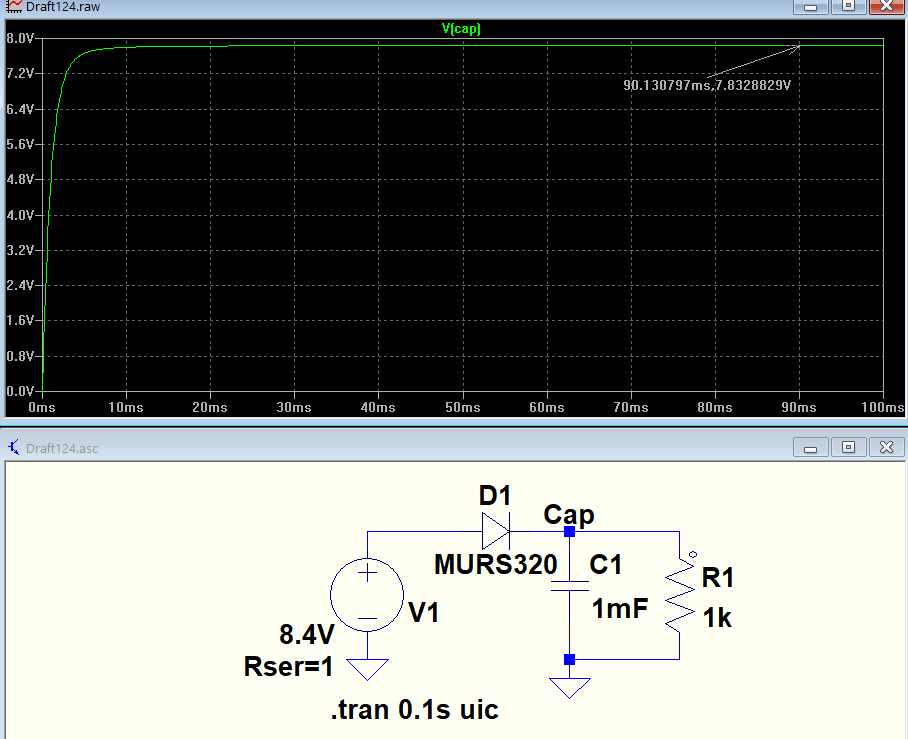

Yes, a silicon junction (not Schottky) diode in series should reduce the capacitor charged voltage about 1/2 volt.
Its current rating would need to be at least 10A and would need to be mounted on a heat-sink if the steady current drawn is more than a couple amps.
The simulation below shows a final capacitor voltage of about 7.8V.
The added resistor is to bleed away the small diode forward current at low voltages so it doesn't continue to charge the capacitor.

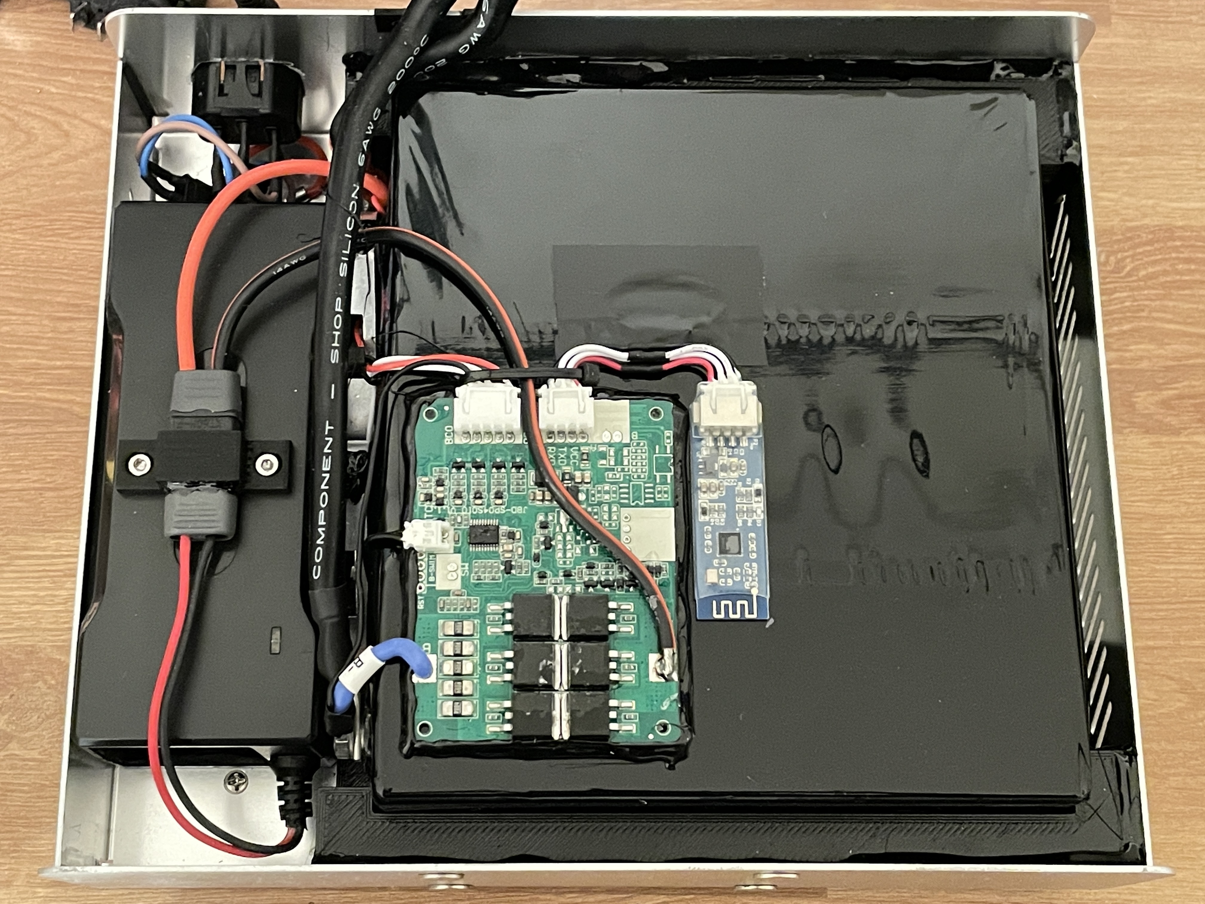

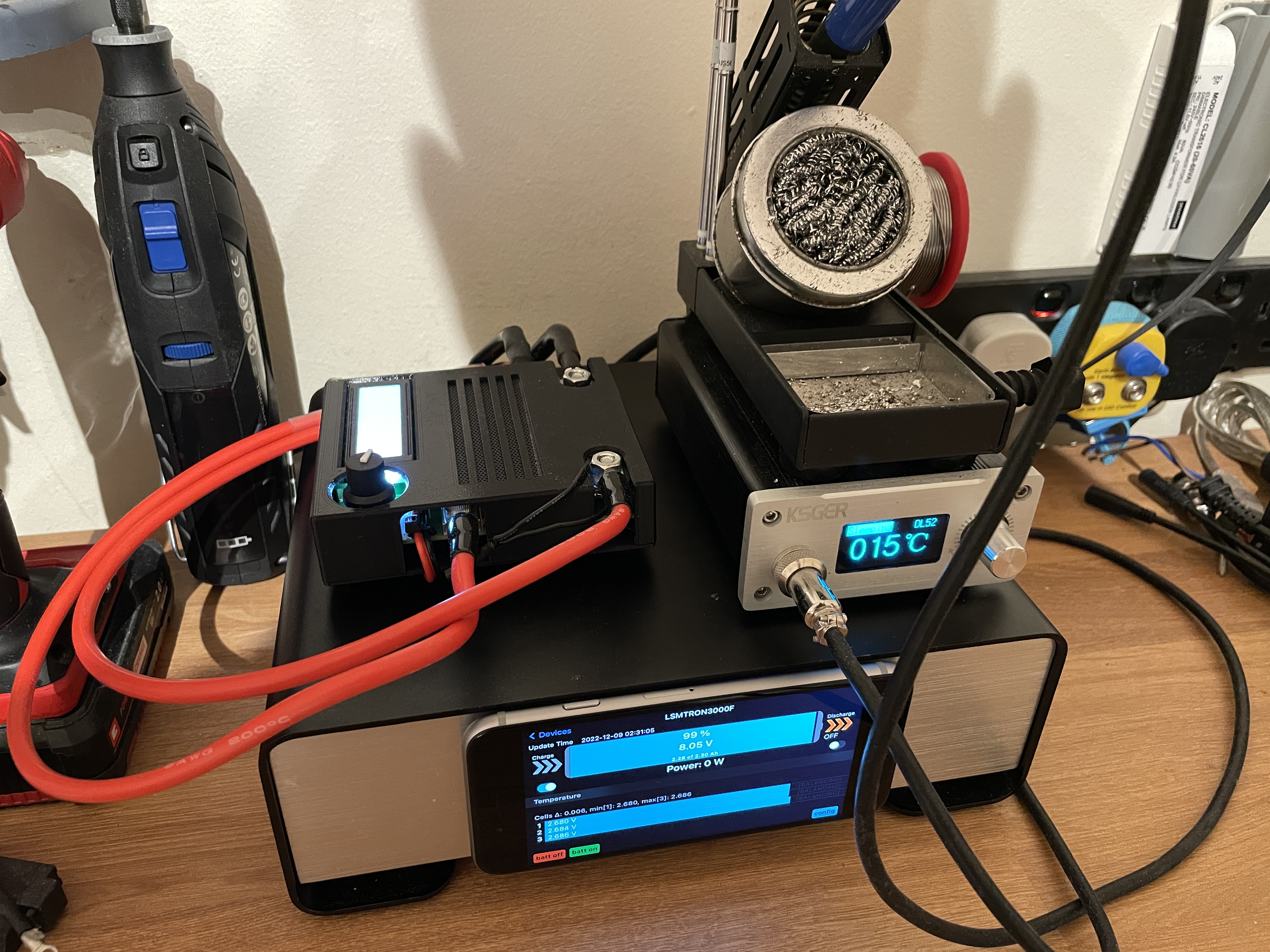

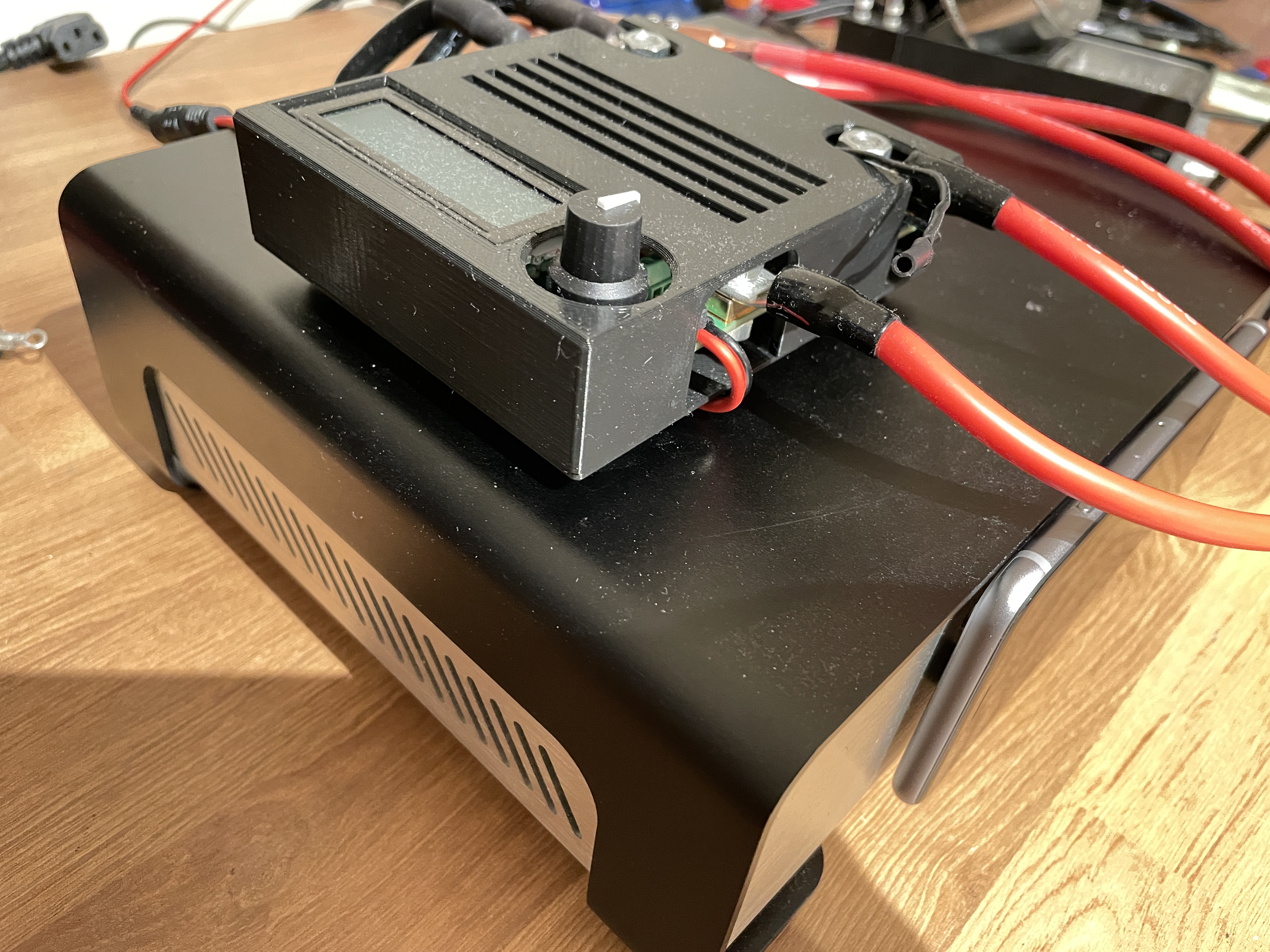

At the moment it all fits into an enclosure and I don't really want to print out all new parts or buy anything else. The charger is fan cooled and the venting fits really well with the aluminium chassis vent so it would be a shame to throw it away. I think all I need to trim off the excess voltage is a diode but it is finding one that is difficult. At the moment it hits the welders limit of 2000A and won't let me pass the calibration.

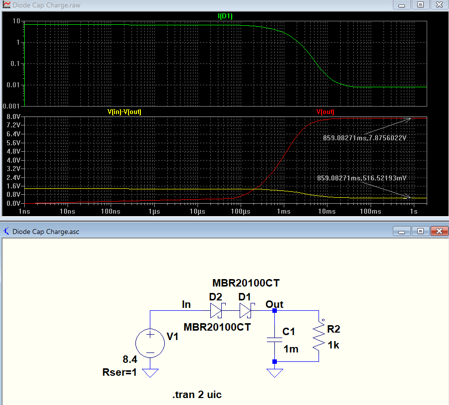

Two Schottky diodes in series might give you the required voltage drop?
Yes, that should work.
LTspice sim below with two 10A silicon Schottky diodes (not silicon carbide) in series:
It reduces the capacitor voltage by about 0.5V (yellow trace).
This voltage can be varied some by changing the value of R2 (lower value will give more drop).
