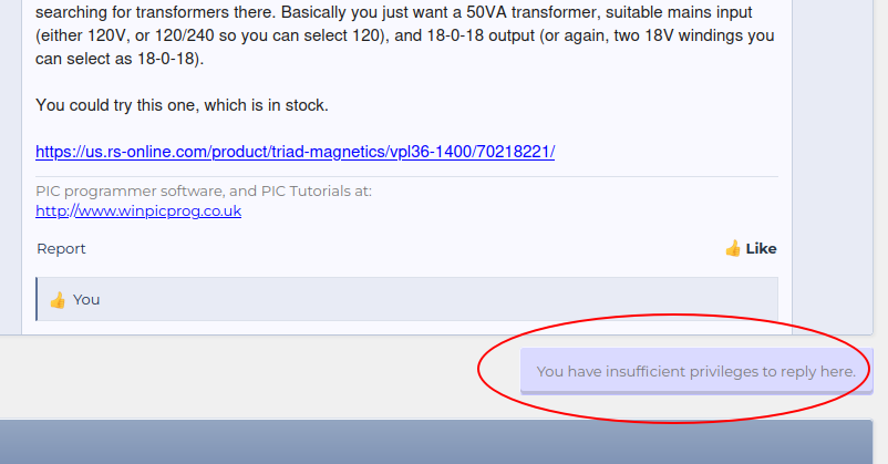

Yes, Nigel.
The project is on hold for a while.(Disbursal's being greater than receivables...)
{Old age is bloody difficult on the dole} Having already ordered the first
transformer prior to joining here.
I don't intend trying it though, and will wait until my receivables increase to a point that
I can order the Correct Xformer from RS.

Thank You !! And thanks for your advise.
Nigel, advised a different approach, and I'll follow that, as soon as receivables allow....
