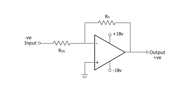

Thanks Northguy, i did as u said, its showing +ve voltage but the results r coming wrong. its not showing results as per the calculation.
friends finally problem solved.. i connected opamp at the output of AD633, and converted -ve voltage into positive, here is the schematic connected at the output of AD633
This would mean that it is not symmetrical, that is your ground is not at 0. If you calibrate in certain conditions, such as pf=1, it may show correct results in these conditions, but if you go to pf=0.5 the result will no longer be correct.
