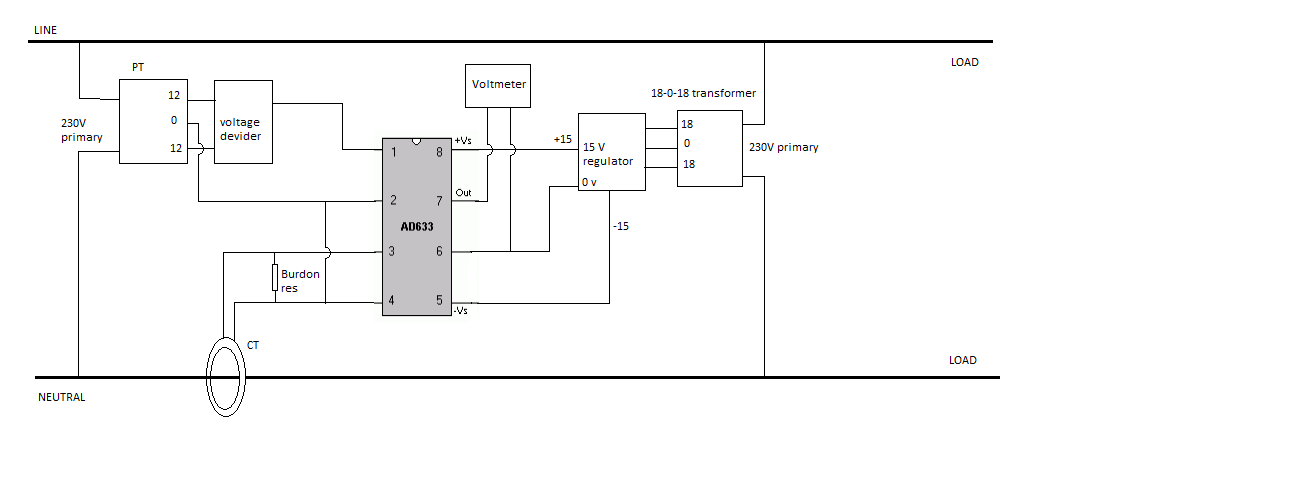

Thanks to all of u friends... but i am still confused, as suggested by Kubeek i am planning to put CT(current transformer) and a normal potential transformer to sense current and voltage, and then i will apply this ti AD633, and i will power up AD633 with DC suppply so that the circuit will be completely isolated from main.. but i am not getting how to connect current tranformer to AD633, can anyone help me with circuit diagram?? please friends , can anyone show me the ckt diagram for it?

You will need a dual supply with +/-8 to +/-18V to power the mutliplier, then simply connect pins 2 and 4 to ground, and apply signal to pins 1 and 3. Also ground pin 6, or apply some offest to it to null the output.
The CT needs a burden resistor connected across it, so the ratio of the CT times the input current times the resistor value will give you voltage that goes into the input pin.
For the potential transformer just use a normal voltage divider to get the appropriate voltage at the input of the AD633. The circuit seems to have inbuilt 1/10 divider, so if you apply 1V to both inputs you should get 0.1v out.
Thank you Kubeek... please hav a look at the circuit. is it ok?? or any changes?? one terminal of CT is connected to pin 3, and another terminal to 0V, similarly 1 terminal of PT is to pin 1 of AD633 and another to 0V. Do i need a voltage rectifier(AC to DC) after PT ?? or no need??
PT doesn´t need to to have dual winding, a single secondary is enough, so the divider goes simply between 12 and 0 taps.
The CT is ok like that, only I would add another divider to it so that you have some option to trim the total gain.
On the output you might want come RC filter to get the average value of the output, this could depends on what meter you are using.
2x18V transformer is overkill, since the rectified voltage will be 18*1,414=25V, so a 2x15V transformer will be enough.
Add a connecttion from pins 2 and 4 to the supply ground.
hi kubeek i made a ckt using CT and normal potential transformer and some voltage dividers, and its working fine and showing accurate results.. but the problem is that voltage is comming in -ve (minus voltage), how to convert this into +ve volt??? so that i can apply it to the ADC. Or is there any ADC which can read from -1.2mV to -3V...??
Glad to hear it worked :)
Try reversing either the polarity of CT or PT. One of them is phased backwards so with resistive load you have allways one wave going positive and the other negative.
thanks u kubeek for ur reply.. but still it is showing -ve voltage at the output, any other way to make it positive??
Do you have an oscilloscope to check what is happening on the inputs and outputs?
Well then try putting one of the singal on both of the pins and disconnecting the other and see what happens.
May be kubeek didn't explain it fully. Take the CT off the wire, rotate it 180 degrees, then pull the wire through it.
