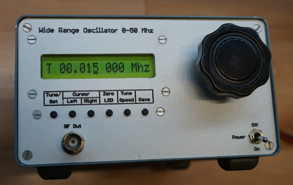

I put some holes in the correct places, joined them up with lines, and then I etched them with a milling machine.
I have also created front panel texts in Eagle and engraved them with a milling machine.
Like this:

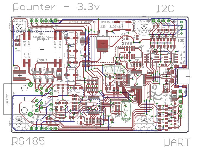

I laid out my boards exactly as I described above. Put the footprints on the board, make the connections using airwires, then arrange the parts and lay out the tracks. Tedious, but it works. I've laid out some fairly complex boards that way.

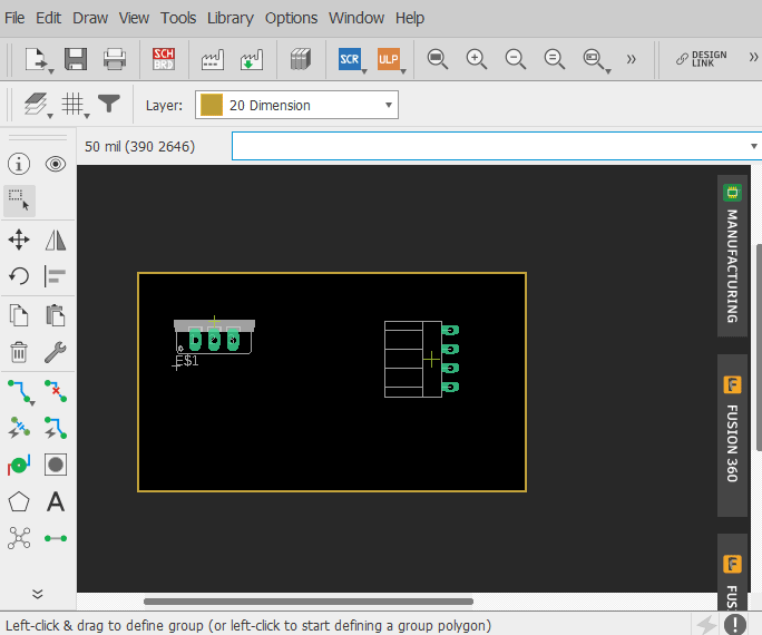

So which layer do I need to set the border at?

If I simply want to set a border, what layer should I set it on?
I just opened Eagle, generated a new project, then a new board. Drew a rectangle using the line tool on the dimension layer, added a couple of components and no problem.
