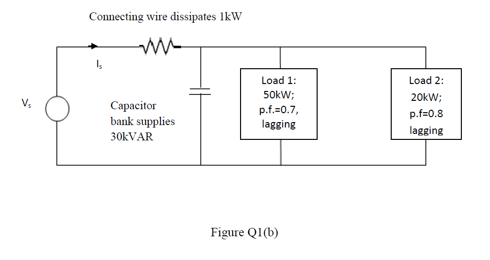

can anyone help me to solve this circuit theory question?? thank you in advance :)
Q: A 60Hz, 120V ac source supplies a group of loads as shown in Figure. If the voltage source is Vs=120V, find the apparent power of the source and the current Is.
capacitor is connected parallel with load 1 and also parallel with load 2.
connecting wire dissipates 1kW.
load 1: 50kW with pf=0.7 lagging
load 2: 20kW with pf=0.8 lagging
capacitor: 30kVAR

This is how I would do it (although it has been 20 years since I last did electrics). Each load is made up of a resistance in series with an inductance. For the first load, it dissipates 50kW, which is resistive. You can work out the resistive element of each load by doing 50kW/120 (=416A), giving a resistance of 288m Ohms. Your power factor is 0.7, so you have the hypotenuse at 1 and the x axis at 0.7, so you need an inductance on the y axis that gives an angle of (cos^-1 of 0.7) (45.57 degrees) at 60 Hz (294 mOhms which is 779uH), so you have worked out the elements of the first load. Repeat this for the second load.
Work out the parallel combination of the 2 loads plus the capacitor. This 'lumped' load then forms a series network with the pure resistance that makes up the wire loss. You can then work out the current that flows through this and its phase with the input voltage.
I need to check the actual figs above, but that is the method I would use.

hi there, i really2 appreciate for ur answer. I already, attached the circuit picture in my post. can refer to it :)
Please post what you have calculated for the answer to that homework question, members do not usually supply the full answers only hints and tips.
but the problem is i dont know how to apply the power disipate by the wire n also how to find the total power factor of whole circuits. please give me some hints
power desipiated by the wire can be taken in sereis with all other 3 elements

where did 294 mOhms comes from. and how to find the apparent power of the source by using this?
Power Factor is Real Power/Apparent Power. Real Power is on the x axis. Apparent power is the Hypotenuse. Inductance represents an impedance UP the y axis, Capacitance represents an impedance DOWN the 7 axis (ie negative). Resistance is on the x axis (and only on the x axis). So as neptune says, you can use a capacitor to reduce the effect of inductance (and get a zero shift on the y axis - ie power factor of 1). See also: Argand diagram. That is all I am going to tell you as you should have enough reading material from your course work to work out the rest...
i mean, wat is de mean of this sentence "Work out the parallel combination of the 2 loads plus the capacitor. This 'lumped' load then forms a series network with the pure resistance that makes up the wire loss. You can then work out the current that flows through this and its phase with the input voltage."?
is it mean,find the combination of power of the 2loads n capacitor? i thought power of capacitor minus with both loads?
Each load (50KW and 20kW) can be represented as a series inductor and resistor, so you have a resistor in series with an inductor and another resistor in series with an inductor. These 2 networks are in parallel. This is also in parallel with a capacitor. You need to do a network analysis to see what this network looks like. This is your lumped load. This can be then treated as the bottom element in a potential divider, with the top element being the resistor making up your 1kW loss. Go from there...

This is the way to go:
  1. Convert all loads to its corresponding complex number (remember to include wire loss here)
  2. Get the sum of the complex numbers
  3. Now you have the total power consumption from all loads together.
  4. You already have voltage, so current shouldn't be hard to find now.

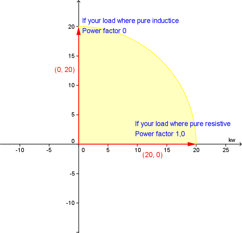

The total true power is equal to the sum of the individual true powers.

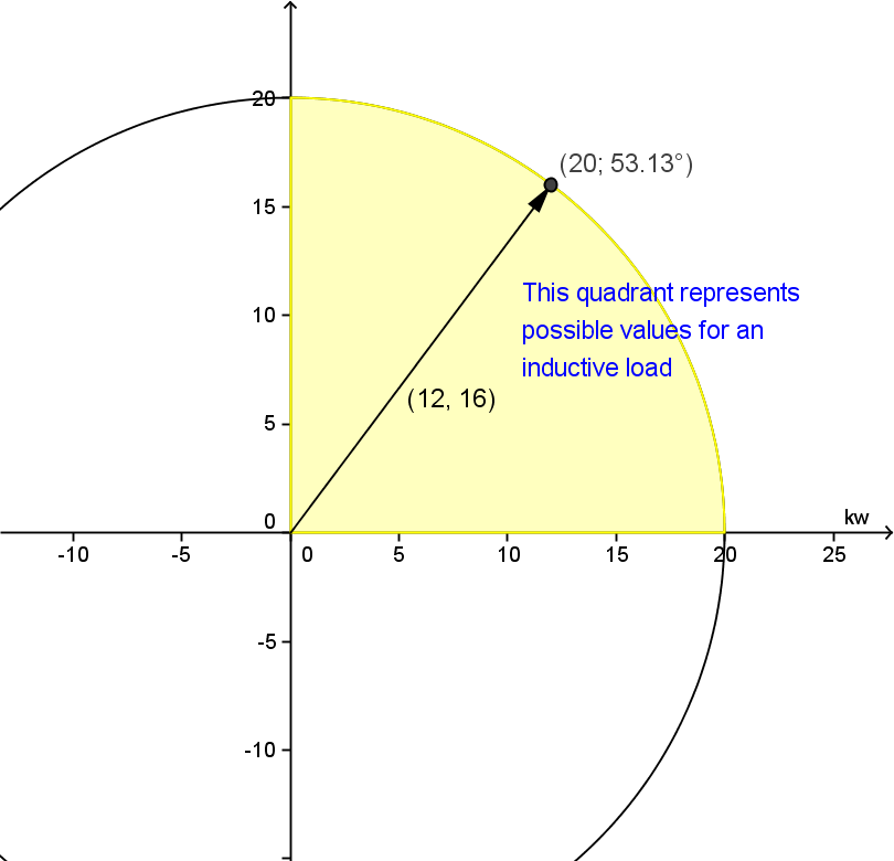

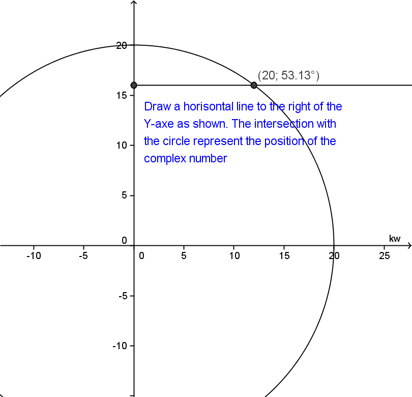

Say you have inductive load as 20kV and pf = 80 (realistic). So make this into a complex number with a magnitude (kVA) and angle (degrees), follow these steps:
  1. Calculate the angle. This will be a result of ARCSIN(0.8)
  2. Put the angle together with the magnitude. The complex number would be writed as (20;53) (I doesn't find angle and degrees sympls here).
Two tip:

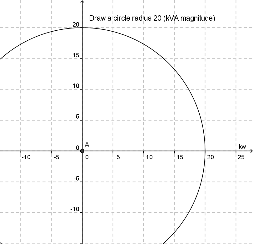

  1. Make a simple simple draft and put the numbers on a coordinate system to check that it's ok.
  2. Complex numbers is very similar to vectors (when origo is starting point). That is - doing mathematical operations on complex numbers is just the same as for vectors. Only difference is that vectors is represented as a arrow that might have a starting point on a different location than origo, while a complex number is a point that is always measured according to origo.

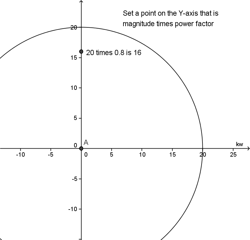

I add some pictures I made using Geogebra. Be aware that when I upload graphics on this forum, I have absolutely no control over their order. Look at the pictures file name.
[edit2]
It seems that the images is automatically ordered by file name. Good to know for the future.
