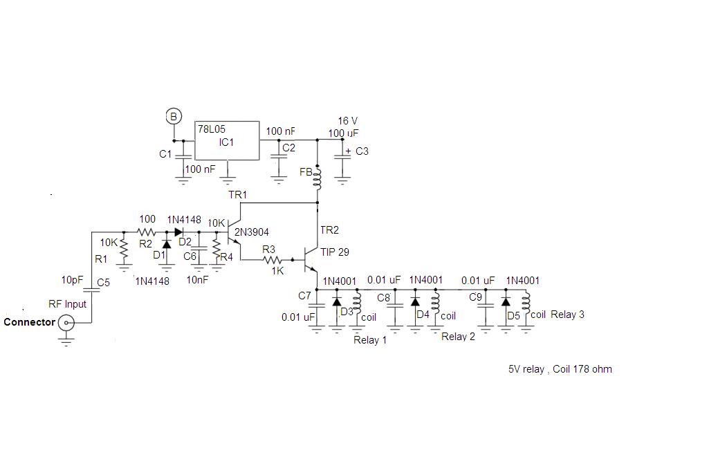

Can anyone help me about RF sensor switch used relay circuit ??
ken2000
I do not sure this will working or not ? pls check on the photo..
This i will use RF power 1W input for drive transistor 2N3904 and switch TIP29 .. for 3 relay ( 3 coils 178 ohm/coil ) I do not sure if used 2 x 2N3904 it will work or not ? and if use TIP29 like this photo will work ?? can anyone advice me ? pls.. The relay is 5VDC coil 178 ohm...
Thanks..

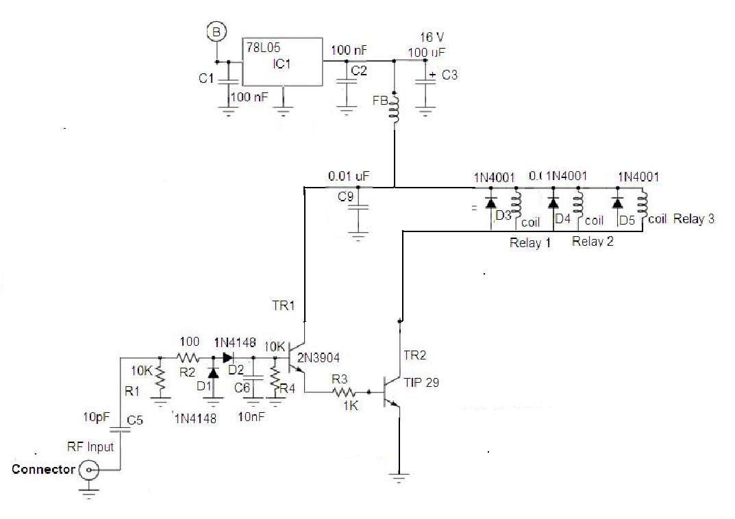

It will probably work a lot better like this.
The OP's circuit may actually work. He mentions driving it with 1 W of RF power. With this much input he might have a peak RF voltage of roughly 7 volts before the detector. The diodes are arranged to double the voltage and the load on the detector is only about 30 to 50 microamps, so I guesstimate that the voltage that gets into the 3904 base will likely be enough to drive this follower arrangement, given enough gain from the two transistors. Assuming gain of 50, that 50 microamps would turn into 125 mA, which means the output transistor will saturate with its 83 mA load. So it might work.
Thanks you very much JimB..
I will test it... Oh if i not used TIP 92 ( TR2 ) , but will used 2N3904 for ( TR2 ) it will work ?? I dont know about bias on TR2 if used 2N3904 and it will can carry switch 3 relay ??
This supply 5V will come from 12-13.8V regulator 12-15A into this IC1 regulate 5V ( this you think it will not damage the IC1 ??) and after out from IC1 it have 5V this +5V will not damaged the relay ?? because relay coil only 178 ohm.. ( i will used RF relay HF3S AXICOM Relay )
