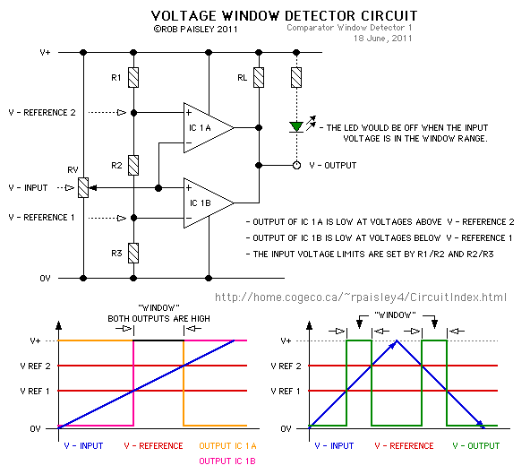

I have an idea,
What if I did something like this, and set one reference limit close to 0, and the other just a little bit higher than that. That way I would get a nice, but quick, square wave form at the beginning and the end of the cycle.
Remember, I am just doing this project for fun; learning and doing is as important as the result! I know I could just put a photodiode and a cap on some strip board and call it a day, but that would be very boring, everyone has already done that. Do you think that the sound card would tolerate two quick DC square waves that are 1V or less?ComparatorWindow.gif
Be aware that the sound card / Audacity combo will have a sharp cutoff frequency ~20kHz. That implies pulse rise/fall times faster than 1/20 mS won't be represented accurately, so this may limit the accuracy of your measurements.
The problem is as I mentioned. What I forgot to consider is a PC audio input uses capacitor coupling of the incoming signal. While this is wonderful for audio, it sucks as to getting a pulse through. Remember, a pulse (in our case) would go from 0 volts to a DC level and then after a period of time return to 0 volts. Later today or tomorrow I'll post exactly what I am getting at with a picture or two. I am trying to think of a good workaround. :)
Plus what Alec mentions tossed in also. :)
