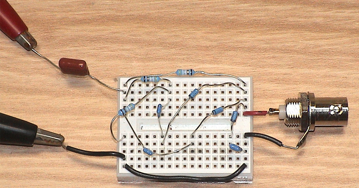

For future :
Note for all the above, some do not show any sound card input protection, just google
"sound card input protection) for circuits. Or use an external sound card dongle.
Regards, Dana.
