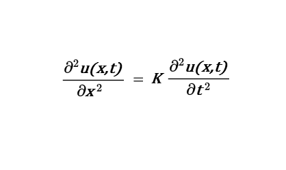

For one for example, if we have two amplifiers and connect them together with an inductor (or capacitor) so the signal from the output of one feeds the input of the next stage, we have a certain circuit with a certain number of components. If we then short out that inductor, that action represents a change in topology. In a circuit connected with a resistor, that resistor dissipates energy and if we replace it with a short then there is no energy dissipated anymore, so zero energy.
There are problems that come up with zero resistance that dont come up even with 1 pOhm. But even if it was possible we always have Einstein to deal with. So far, nothing can go faster than the speed of light, and of course that includes energy.
The two PDE's i gave just for example decouple into two wave equations where the one for the voltage, and with all 'losses' set to zero we get a simple wave equation:
Vxx=K*Vtt (see attachment)
where Vxx is the second partial of V with x (spatial), and Vtt is the second partial of V with t (time).
The wave equation admits all sorts of solutions, but one of the interesting things is the velocity of the wave propagation can not exceed the speed of light. Since K is part inductance and appears as a factor, that means we cant have zero inductance. In fact, with a given capacitance we can not even have an inductance that is too low or else the equation will show a propagation velocity that is faster than the speed of light.
So again all we can do is try to accept that the examples are going to be a little fictitious, holding only in as much as their assumptions are called 'real'. That however means we have to have numerous examples to show what each set of assumptions leads to.
